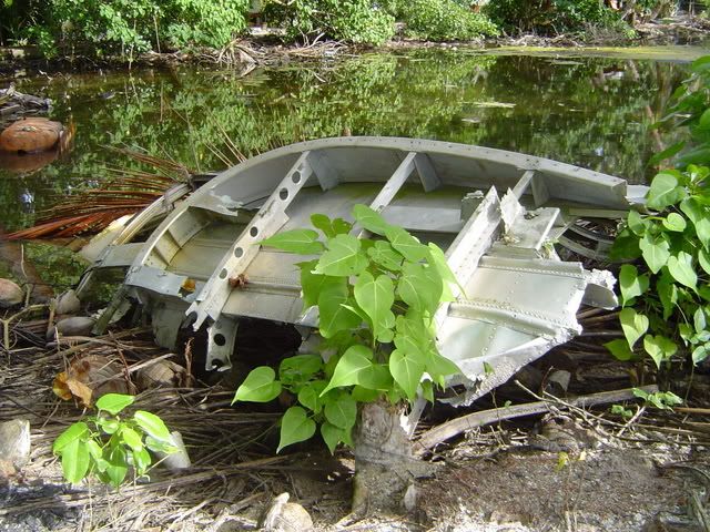

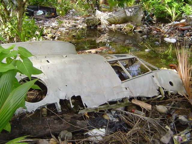

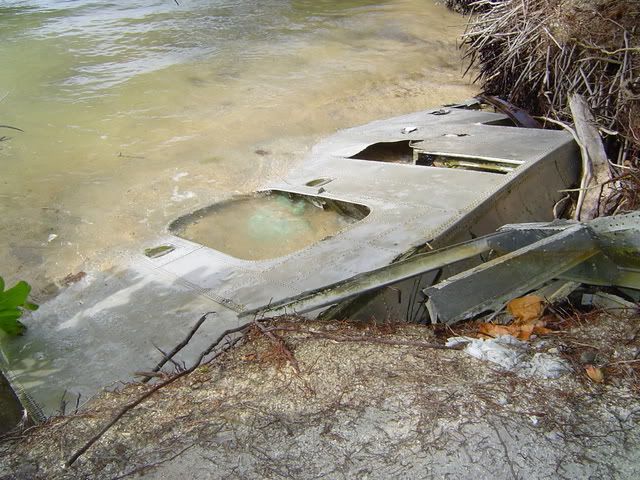

Cockpit section. About 10' from the shore.

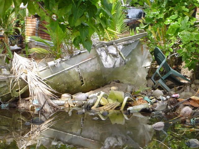

Another section is across the pond from the cockpit. These ponds are often the remains of bomb craters. Unfortunately I was unable to get close to it, for it lies near to the landowners house and I didn't pay to see the airplane.
Forward fuselage?

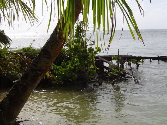

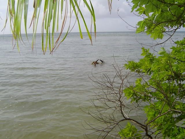

This section is about 50' off shore. It is possibly the front turret because of the rusted steel.
So the aircraft nose section which was once one piece is now four distinct sections. Most likely this is a result of human intervention. The parts are now separated by several yards each, and are stored around the landowners’ yard. The whole place looks like a dump. Most likely the landowner cut up the nose and hauled it onto his property so he could charge people to look at it.

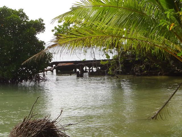

Oil Barge wreck near PBM (Japanese, U.S. ?)

I think we're looking at two different cockpits. Look at the two holes I've pointed out here:
Now look at the same areas on the other one:
No holes. Looks like this may be the "other" one mentioned.
