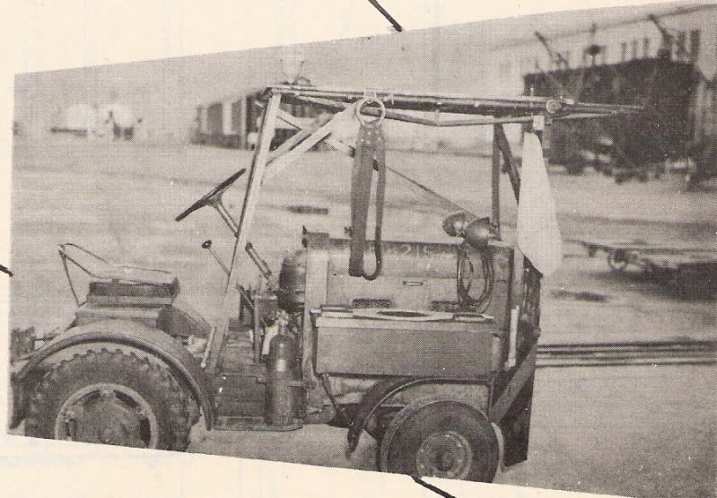

PostPosted: Wed Feb 17, 2010 10:17 pm
Posts: 3442
This photo was taken at a 2AF B-29 training station, probably in the summer of '45. This tug was used by the propeller crew, hence the modifications.
