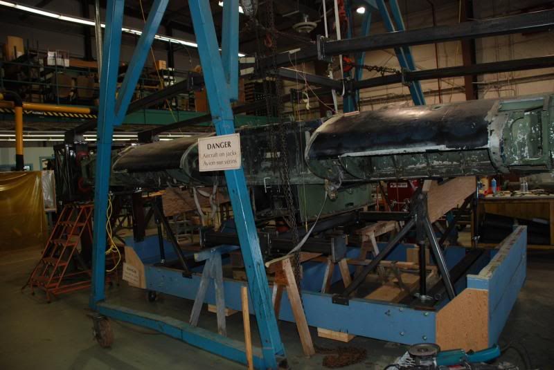

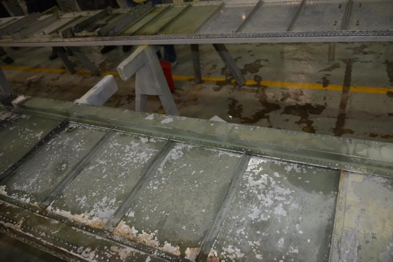

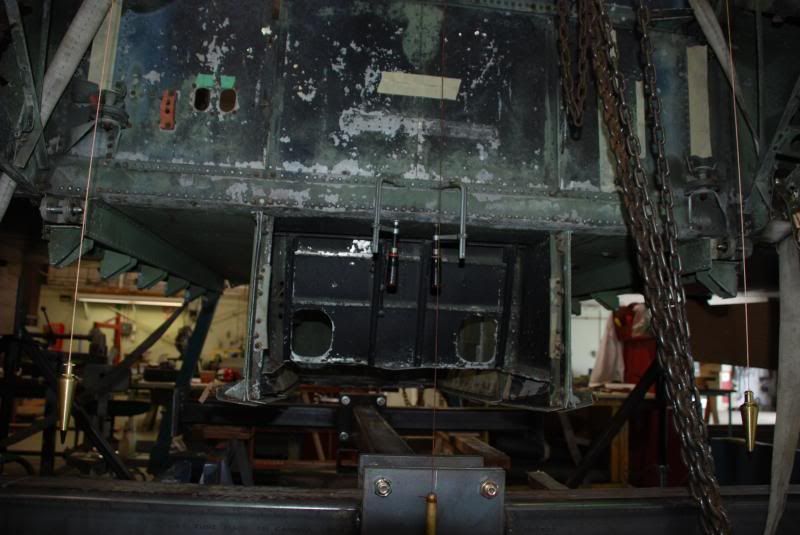

As of a few weeks ago the complete center section has been totally disassembled to its smallest components. A complex rotating jig was built to do this. I have included a shot of the center section taken last year prior to it being disassembled. The jig is now totally empty as all the parts have come out. The components are in surprisingly good condition for the length of time they were outside. All parts well be cleaned,painted/treated and re-riveted back to reform the center section. The restoration is down to the last nut , bolt and rivet.

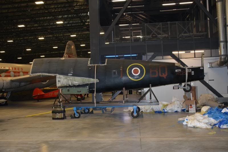

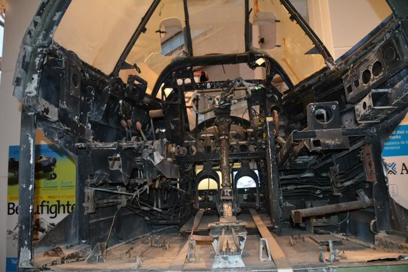

The front cockpit section still is located by the main entrance to the museum. A donation box near it serves to help with supplemental funding.it is surprisingly complete, missing only a couple items and the instruments.

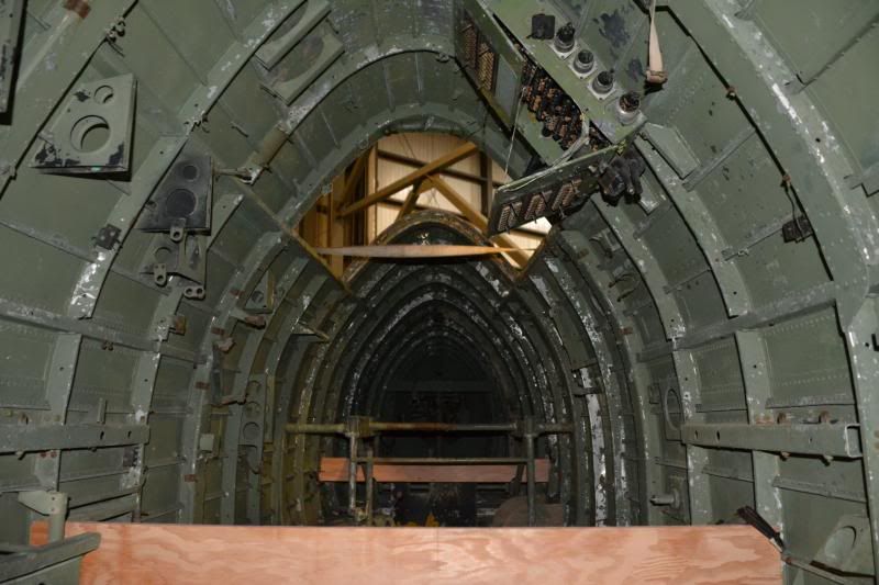

The rear section and outer wings remain in the storage hanger waiting their turn. I have included a shots of both the inner and outer sections.
When the rear section was opened up prior to the start of the restoration, a large number of parts were found stuffed in it. These apparently had been thrown in the back when the RAF shipped it to Canada.
