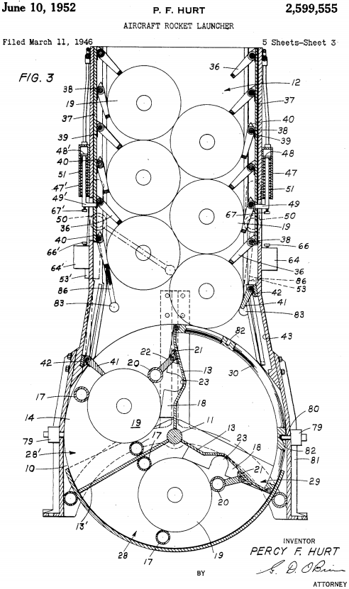

British Pathé has video that appears to show a turret mounted version of the 5 inch rocket launcher. The voice-over seems to suggest that both systems are versions of the Tiny Tim, but I think it is just the way the film is cut:
The nose mounted unit was also mentioned in the March 1947 issue of Popular Mechanics:
(Source: Google Books)
Similar to a number of designs from other sources, the Navy patented a rocket launcher that may be the version in the PBJ:
(Source: United States Patent and Trademark Office)
If anyone is interested in this sort of weapons testing, more pictures can be found on the China Lake Alumni website.
