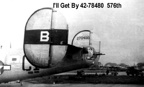

It would probably also have the serial number "251106" painted on the inside of the tails (in yellow if it was an Olive Drab aircraft, black if natural metal.) The squadron code indicates the aircraft was from the 567th Bomb Squadron, 392nd Bomb Group (the "A" on the tail would be the individual aircraft letter.) Here's a photo of another B-24 from the same squadron showing the tail markings.

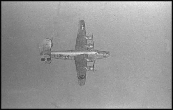

She probably also had a "D" in a black circle on the upper right wing, as seen in this photo. It looks like the letter itself is bare metal..probably simply masked off when the circle was painted.
