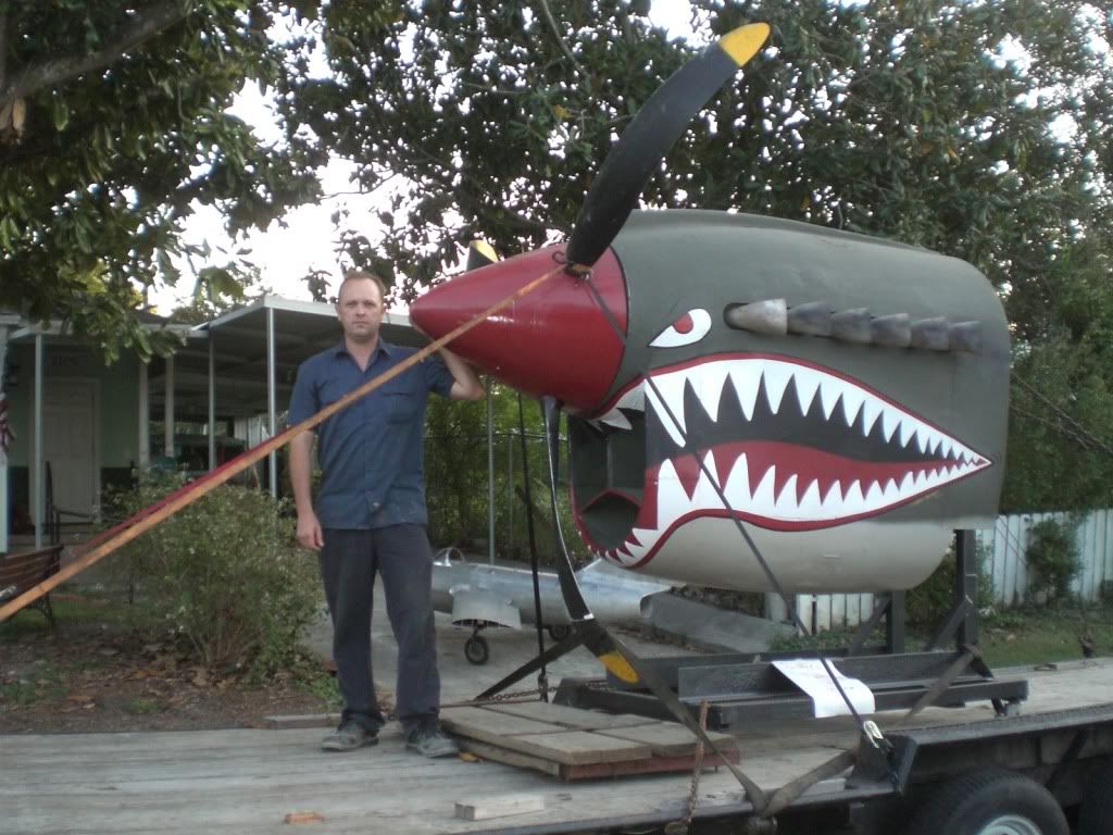

I made this full scale P40 model out of the front half of a Lockheed Jetstar fuel tank. I used parts off of several aircraft as well as fabricated a lot of parts. The exhaust pipes were made from the 90 degree elbows out of several school bus exhaust systems. The propeller was pulled from a crop duster that crashed.http://s1122.photobucket.com/albums/l523/cjasonbarnett/WWII%20P40%20Warhawk%20full%20scale%20replica/Image

That's really cool!

As a P-40 nut I whole heartedly approve! Very nice work. 8)
I'd love to hear more about the fabrication process if you have the time.

I've seen pics of that popping up in various places. Pretty cool!!
When I started collecting parts to build this P40 replica, my intentions were to make the entire fuselage and make a full scale replica that I could drive down the highway. I wanted it to look like an airplane had just crashed landed on the interstate and that I was still rolling down the road with the wings clipped off. After I built the front end, I decided that it was going to be a rediculous amount of work to build the rest of the fuselage. You can see in the pictures the front end of the fuel tank that I started with. Originally the tank was about 17ft long! I lobbed off just the nose section of the fuel tank and started from there. I went up to the Cavanaugh flight museum in Addison TX and measured off of their real P40 a few times to get everything to scale. I spent years collecting up parts. The bottom of the "Jaw" is made from a jet engine cowling off of a Hawker private jet. The chin is made from an air intake from a helicopter. The nose cone tip was off of a modern plane. I did have to fabricate most of the nose cone however. The propeller was just a junk ground strike off of a crop duster. I used stainless steel pop rivets to fasten it together. The prop spins on a huge shaft that is mounted on huge bearings. The slightest gust of wind and it is off and running.
