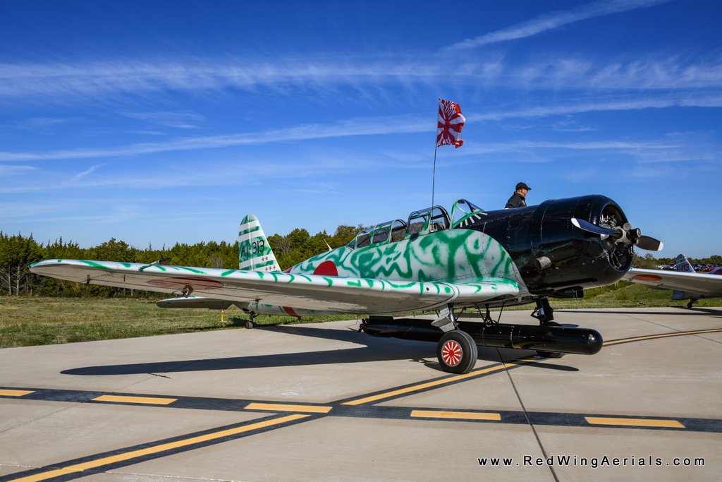

Then I began the arduous task of recreating what's become known as the "Speckled Kate".
1945 built AT-6D (N3242G) that operates in the CAF's Tora! Tora! Tora! airshow team.
The reason I picked this pain in the a$$ to replicate instead of some of the other equally interesting (and easier) examples is simple. I had a chance to actually sit in this aircraft around 2000/01 at the National Warplane Museum's annual Wings of Eagles Airshow, being then held at the Elmira Airport in upstate New York. While out at dinner one night with the family, some of the Tora pilots came into the same establishment. Immediately recognizing them (by the many rising suns) I went up to them and thanked them for flying in the show. One pilot gave me a small rising sun batch and told me to visit the announcers booth the next day, and he would take us over to see the fleet of Japanese aircraft that were parked quite a distance away from the show. My father did just that the following day and were escorted over to the row of beautiful looking aircraft where I was allowed access to sit in the Kate.
So with the plan now in place, I set off to find as many reference photos as possible of N3242G. It easily took about 2 hrs to replicate the pattern on this 1/144th scale version. I'd say the end result is about 93% accurate to the original with a few edits / modifications. One thing to note is that I believe whoever painted the real one took there time with the port wing and side of the fuselage, and seemed to have gotten impatient and was more expressive and "loose" with the spray gun on the starboard side. They look so different when you really study the patterns closely! This was the end result.

Nice. I saw her recently.
