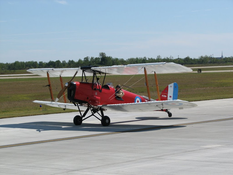

I think the 'Smack in the Eye' concept is also viable, especially since I just saw a white wing/red fuse. Moth fly into WOH Friday. Ed Martin in Lousiana built it and friend of his flew it in. Ed actually flew his Stinson Reliant.
For those who weren't there...
Thanks, (I think) Ryan. Nothing wrong with that, it's a very accurate copy of a wind-up tin-toy scheme. ;)
