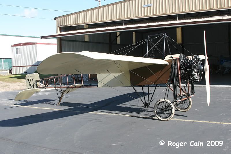

For about four months now Eric Presten, based at Sonoma Skypark, CA, has been the proud owner of this full-scale replica kit that he built in just 26 days, the same amount of time that Louis Blériot built his original. The kit was built by Airdrome Aeroplanes in Holden MO., and Presten elected to go with the more authentic wing warping, instead of ailerons that are found on most of the replicas. Power comes from a Rotec R-2800 110 hp radial engine. Plans are to fly it at West Coast air shows this next season.

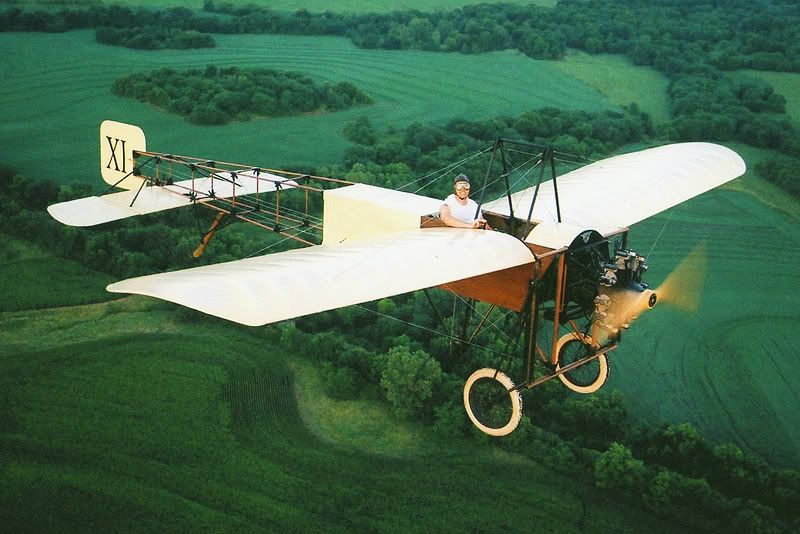

First test flights prior to taking it to Oshkosh this year, Photo by Presten.

He had Dave Masters build him a new custom-built period propellor, that was installed and test hopped yesterday. I didn't get there early enough, so this is a picture of the plane getting put away for the day.

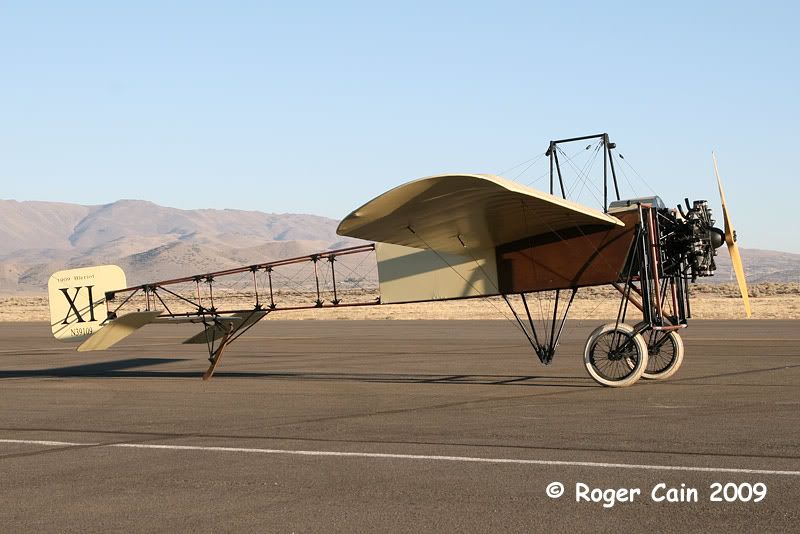

Here are a couple of pictures from entry at the Rolls Royce Heritage Trophy event at the Reno Air Races this year.

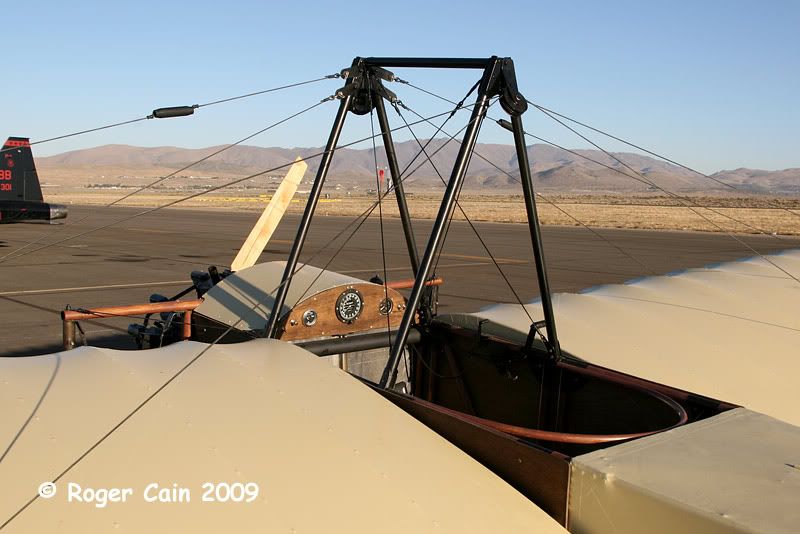

No complicated instrument panel here.
