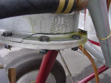

The short run was due to a failure of the oil sump/pump housing. Ouch! :( So, if any of you WIXers know of somebody with a spare for this item as well as a spair set of points, one of ours is in bad shape, we would be very greatful for the help. The plane was about one week away from the FAA sign off for test flights but until we find some parts, it's grounded. I'll try to post a photobucket video mpg link of the brief engine run this week.

"Oil Out" is right! Can you weld that crack up or is that piece a writeoff? What is the aircraft?
Matt

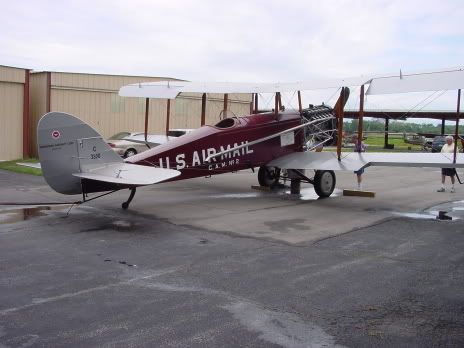

It was welded back together and has since run for about 20 minutes without any further problems. At least as far as the oil system goes. The 80 year old, but freshly overhauled radiator has become the next problem. It's leaking like a noodle strainer. This is a DH-4M2A, a Atlantic Aircraft (Fokker) modification of the wood fuselage DH-4B. Both Boeing and Fokker's U.S. division built (maybe rebuilt would be a better word) steel tube fuselage versions of the wood fuselage post war DH-4Bs. The engines, wings, tails, and most other components were taken from the DH-4Bs. Boeing built more steel tube versions than Fokker and the Boeing looked just like the wood fuselage version. The Fokker fuselage is a bit "taller" than the Boeing or DH-4B model. As far as we can determine, the Fokker model was built in smaller numbers but served longer in military service. This one is painted in the Robertson Flying Service CAM 2 scheme, like the one's Lindbergh flew in St Louis before flying the NYP to Paris.
Albert Stix Jr.

Glen Peck was able to do some research on the colors that Robertson used and he also scanned the color on a scrap of fabric from one of Robertson's DH-4. It has been said that Robertson used a "Tuscan Red" for the fuselage and silver on the wings. We have some Beryloid color samples from this period that also helped sort out the most likely shade of dark red. I can get the formula from Glen but I may be able to help you find some original Curtiss Wright colors, I think the model 12s were built here in St. Louis. What engine did yours have when built? Thanks,
*The DH-4 went out for for a short walk this evening. It's getting very close to being ready for test flights. It might even make some high speed runs down the runway by the end of next week.
