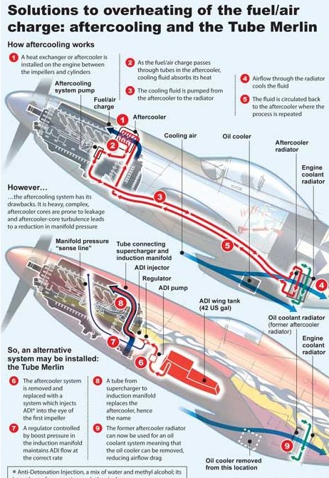

From a Bruce Lockwood article on Tube Merlins.
