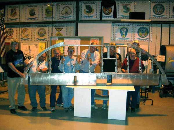

We think that we have finally stripped and cleaned the B-24 rudders and elevators well enough that they can now be primed and then recovered. Above, you see just some of the High Sky Wing members earlier this evening who have been working on this not so glamorous work for the last couple of weeks. Any resemblance of being behind "held captive" by these fascinating parts is entirely true! More later.
Randy

I'd like to thank the High Sky Wing personally for the great job they did on the elevator we repaired the other day--clean parts are sure easier to work on!
The airplane made steady progress today, Gary got some more painting completed around the new radio room windows. Andy continued with paint prep in addition to his other jobs. Shorty is moving forward fast with exhaust collector ring installations, and I was able to locate and fabricate mounting brackets for three of the new bomb racks.
