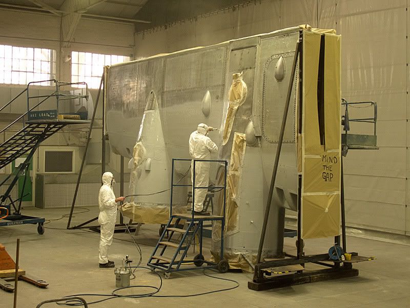

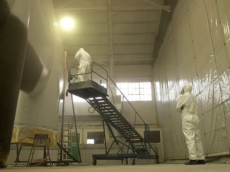

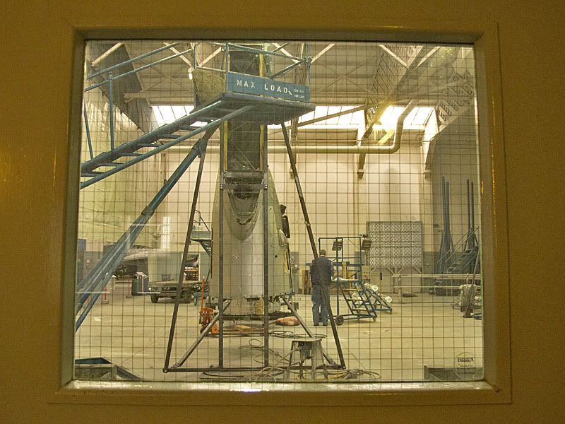

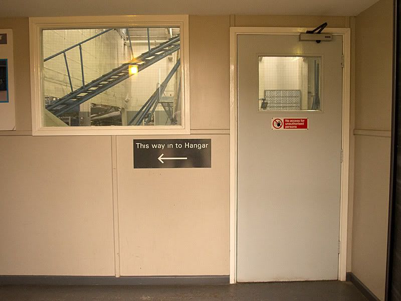

Let's start at the entrance of Hangar 5
Shall we take a peek through the large window ?

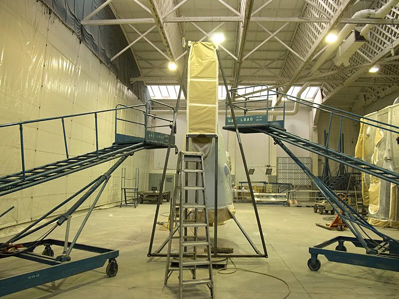

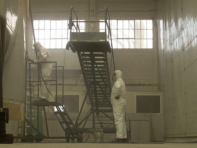

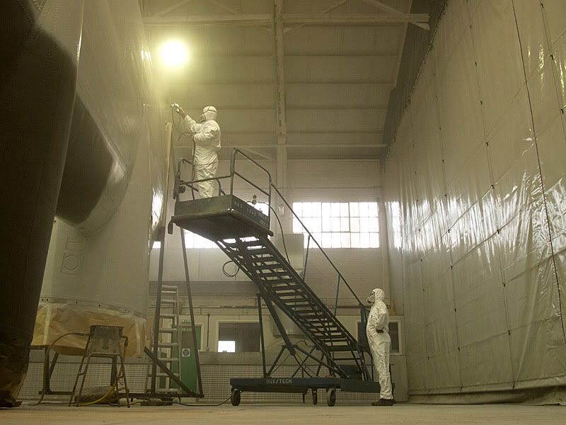

This is the public view of the large spray booth ( I bet it has a better "official" name than that really )

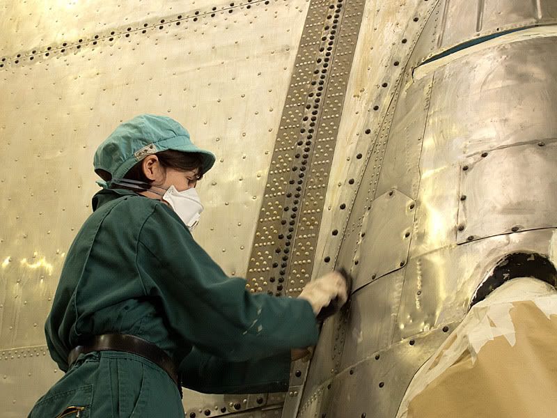

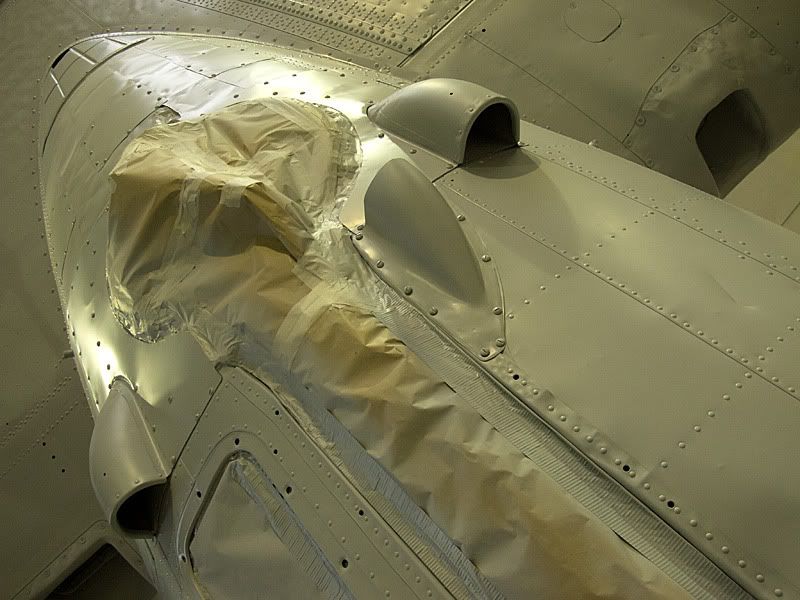

It's here that the painstaking work of degreasing and masking is underway

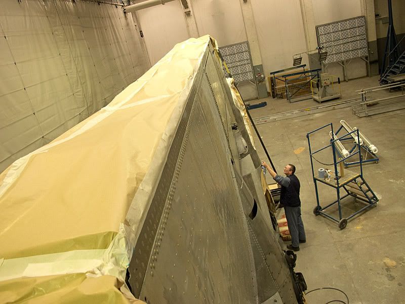

This is no small task on sections like the inner wing sections .....
and requires hours of patience to ensure the paint finish will be the best that the Imperial War Museum can achieve

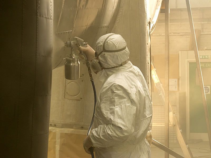

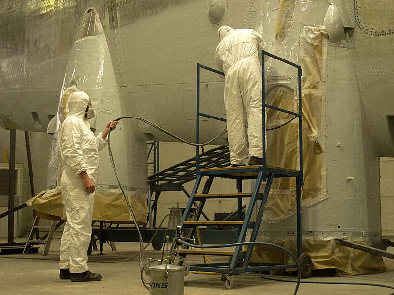

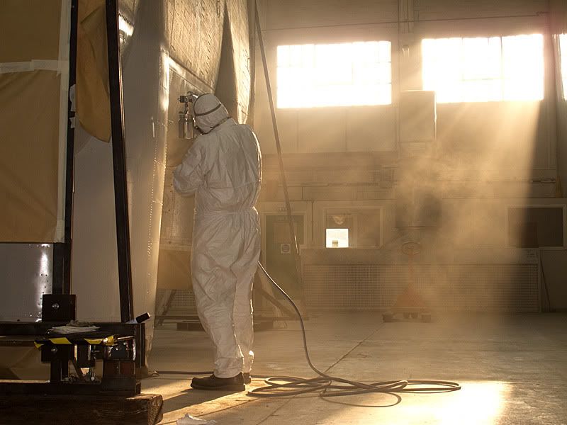

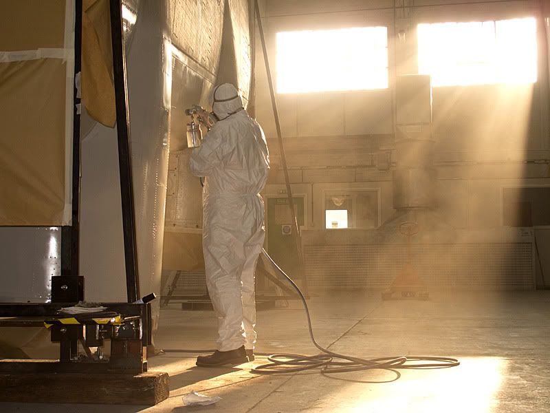

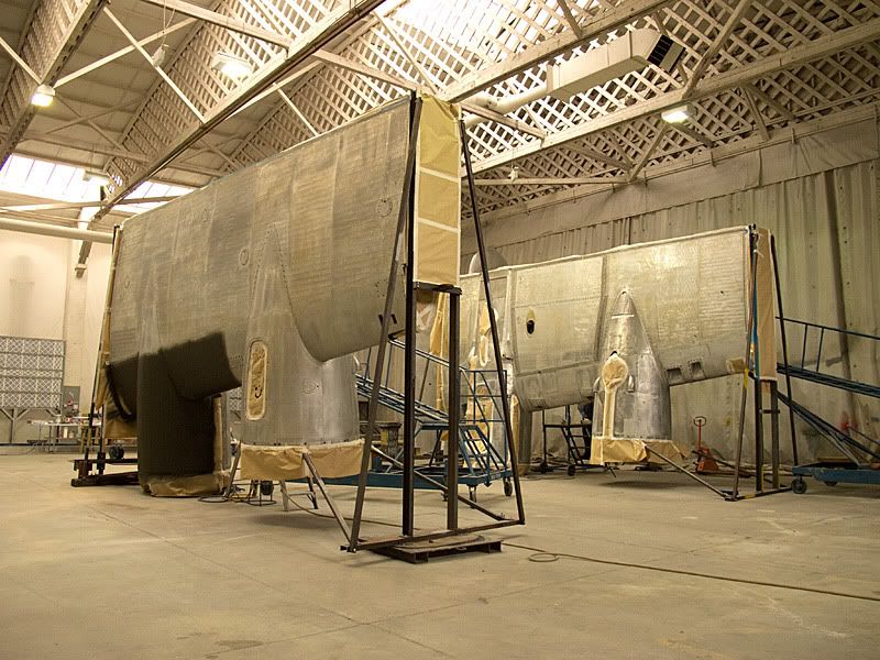

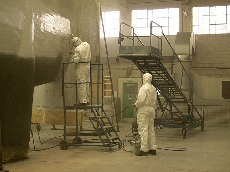

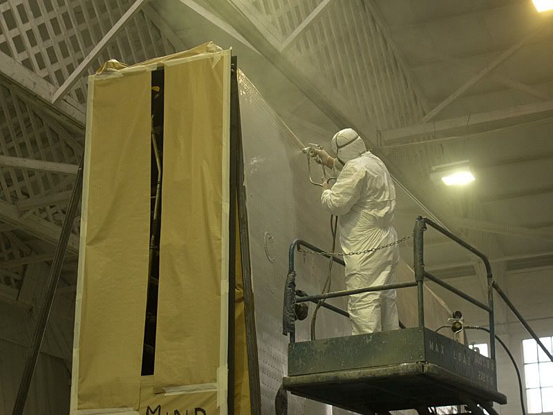

A "test" area of wing section is being sprayed with etch primer .....
The low winter sun adds a little drama to these shots

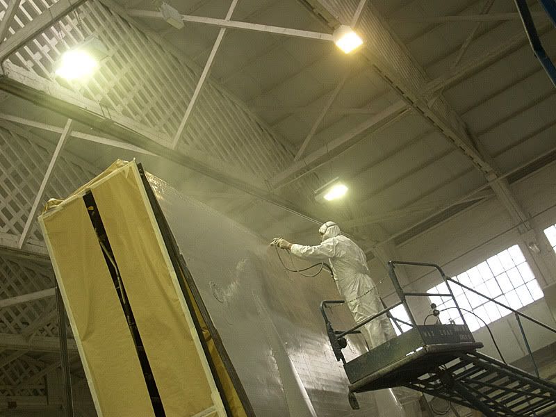

I should point out that I've positioned me and the cameras near the incoming clean air filters and the air borne paint over spray
visible in the shafts of sunlight are being drawn toward the extraction system down the other end.

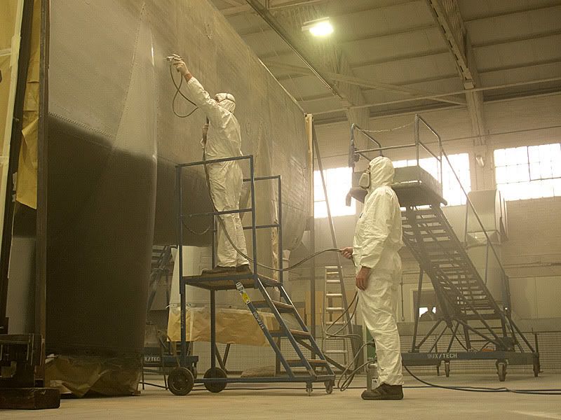

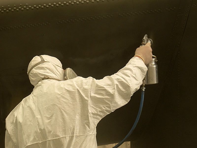

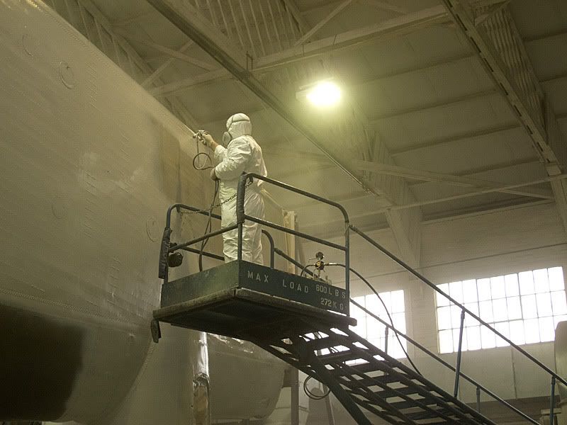

Well the primer coat looked good ~ so let's see what a little olive drab looks like .....
The top coat represents the later war ( post 1943 ) shade of olive drab ~ I really think it looks great !
I think it shows up a little dark in these images ~ we need it to be kissed by some sunlight to show its "true" color :D
Next time I'll add some video shot using time lapse photography :wink:

Movin' right along! and looking really good. Any plans to vary the tint and tone of the O.D. as every subcontractor's O.D. was slightly different due to local pigments and availablility of specific chemicals. KENWORTH Motors ( now PACCAR, still making KW's and PETERBUILTS) built verticals for B-17's about 1 1/2 miles from the assembly line @ Plant 2, got their paint from the same supplier PRESERVATIVE PAINTS across the field in Georgetown, and the verticals were noticably differnt in tone from the rest of the airframe. And the M-3's/M-4's PACCAR built in Renton were a different shade of O.D. from the B-17 assemblies, again, same paint supplier- :wink:

Could they not have found a more primitive paint gun? They'd save a fortune if they tried putting more paint on the actual aircraft instead of filling the air with overspray & clogging the filters. Does no one at Dx have a HVLP gravity feed set up like a Devilbis Plus or GTi etc???

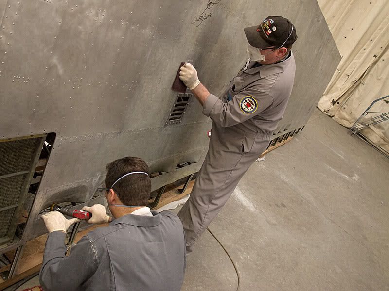

From some of the other pics it also appears they are being a tad overly aggressive with whatever they are using to clean/prep the skin.
PostPosted: Sat Nov 19, 2011 1:59 pm
You're looking @ it wrong, the paint gun makes the restoration 100% accurate and period correct :lol: :lol: :lol: :lol:

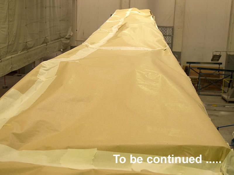

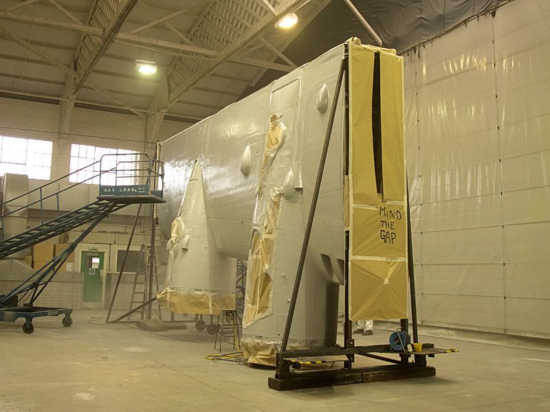

And that's because things have been moving right along in the Conservation Hangar :D

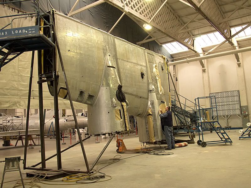

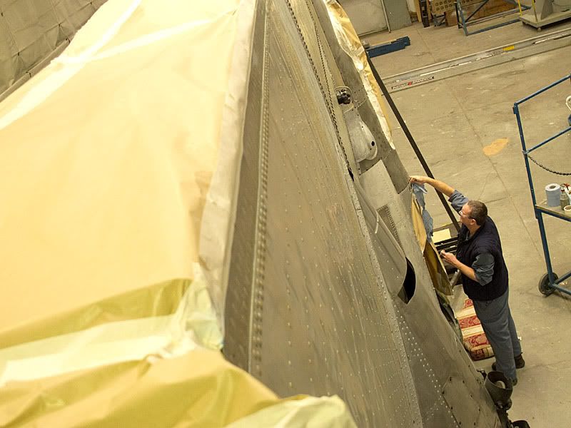

Work continued yesterday on the wing trailing edge sections
And final preparation of the inner wing sections prior to painting ......

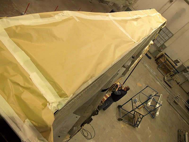

Which brings us to this morning ( Monday Nov 21st ) and the first wing section is ready for paint !
Or shall I say ~ more correctly ~ to be etch primed prior to painting.

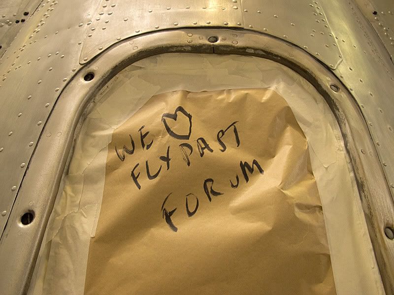

I ought to report that we discovered some graffiti today too. I'm not sure I should share it with you .....

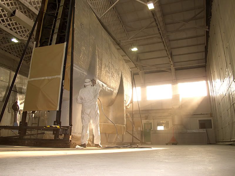

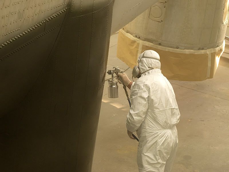

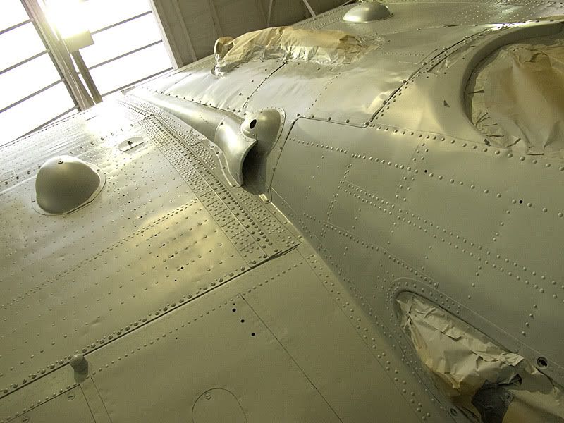

And now ( insert drum roll here please ) it's the etch primer picture show !
End of side one ...... and straight on to side two without a pause !
You may have noticed there appears to be less over spray in these images ~ that's because I'd deliberately used the shafts of
sunlight and bounced flash at it last time ~ to enhance the effect last time for "artistic" :? reasons ....
Let's take a closer look at how the etch primer operation went today
So ! This wing section's been etch primed and is just a few more sleeps ( EDIT ~ not one as I originally thought ) away from being painted
Stay tuned folks :wink:
