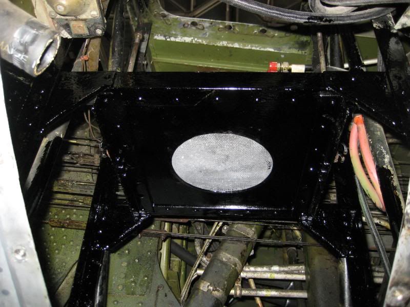

Here's a meager update from the VFM hangar:
I've been working on '543 full time since Tuesday trying to get a lot of the smaller 'one-person-can-accomplish-this' discrepancies taken care of. The list is dwindling pretty nicely. We're waiting on a few parts right now that are holding up progress in getting the inboard fuel cells reinstalled. Hopefully we will be able to install one, or possibly both, tanks on Saturday. I even managed to reinstall and paint the battery tray I repaired last November. :roll:

PostPosted: Mon Jun 28, 2010 4:13 pm
Gloss black! The modelers will be after you for not painting it green... ;) :lol:
PostPosted: Mon Jun 28, 2010 8:01 pm
Posts: 472
Our aplogies to the modelers. Scott painted the battery trays with battery box paint which is resistant to corrosion caused by battery acid. Hence the reason that he had to rebuild them in the first place. We'll take the criticizim from the modeling community over corrosion on our 65 year old piece of history any day! :Hangman: Besides, once the panels are on, nobody will ever see them.
Looky here, this is the stuff I have to use. :lol:
And for the modelers out there, the entire battery area in both leading edges is painted with black anti-fouling paint from the factory.
