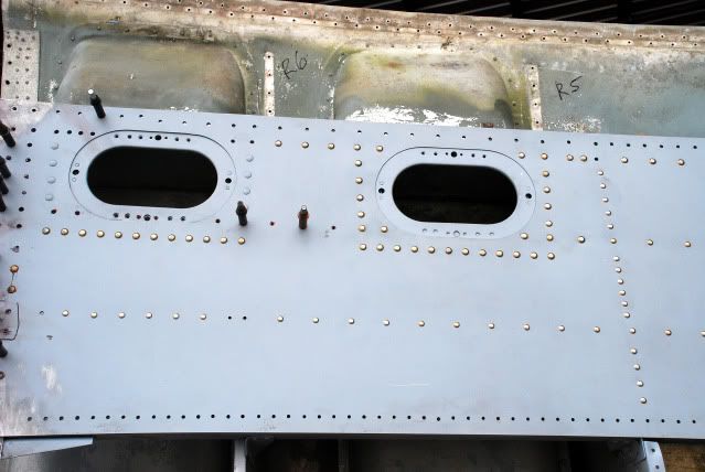

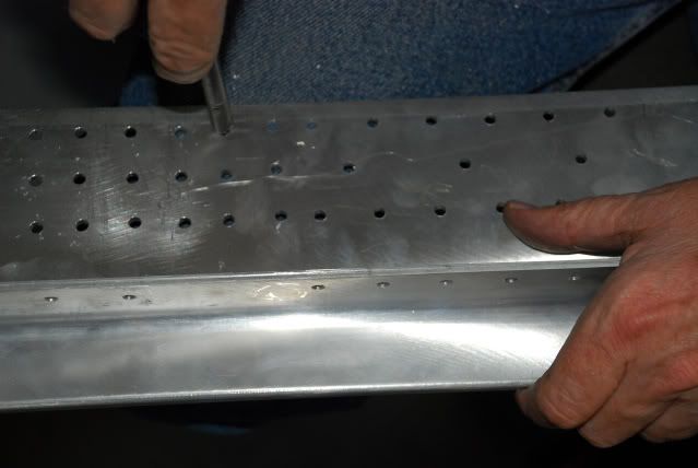

Scott and I drilled out the attach angle yesterday and also finished drilling out the last new stringer. Next week we will shoot a skin.

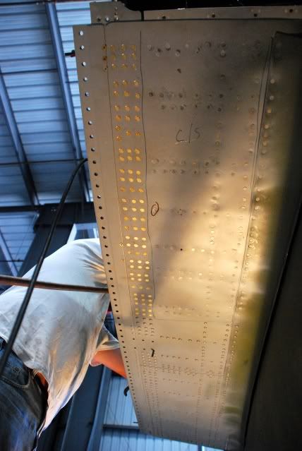

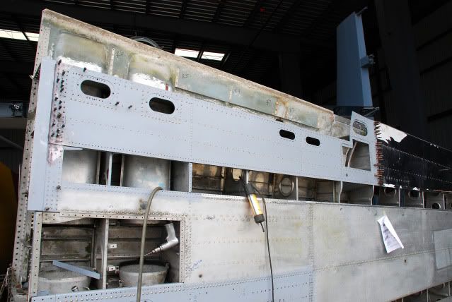

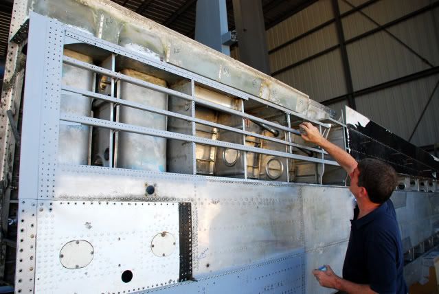

Jeff and I made good progress yesterday. We finished shooting the ends of the lower aft inboard skin that we had sealed last week. We are finished shooting the lower aft attach angle. We installed the aft inboard casting for the bomb rack hard point. We made up and drilled out two new stiffeners in the oil cooler bay. One of these had to be bent to fit around the ducting but Jeff got it on the first try. We are getting close to finishing with the inboard part of the wing. We have Hi-Locks and a few more rivets and bolts to install and to replace. We have to remove the old steel attachments and replace them with new. It is a complicated area with restricted access so going can be slow. We have several more days to go before we move on. The thing that makes us feel good is that as we work outboard things get much simpler and we have for the most part good access.

Next on the list was, after a three-year hiatus, an attempt at completing the work on the right wing lower attach angle, the one just outboard of the nacelle. The Hi-Locks are now installed as well as the top plate over the double hat channels. We also located and shot a bracket on the front spar. Ken made up retainers for the tank liners. We have a good days work to do yet but we are getting close to checking that bay off of our list.

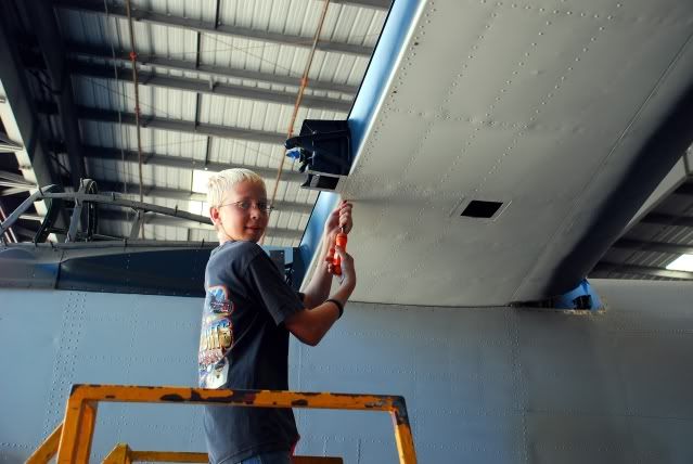

We will hang our nice newly recovered and painted elevators on the bird! I will take a lot of photos and have them posted by Wednesday.
