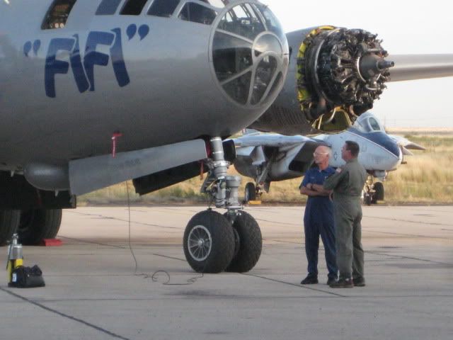

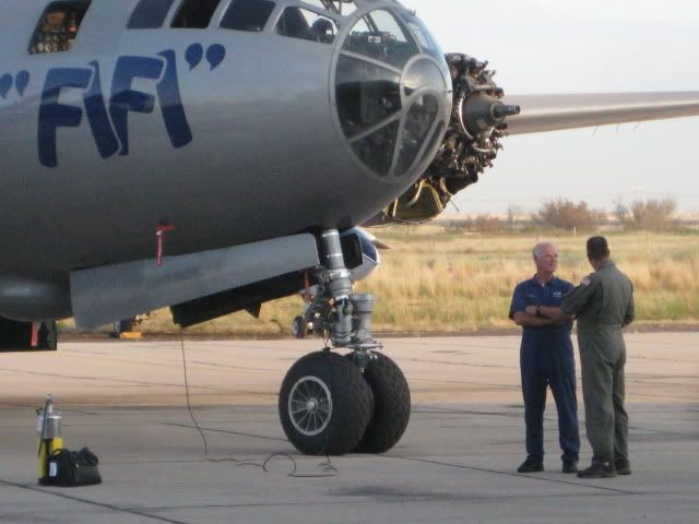

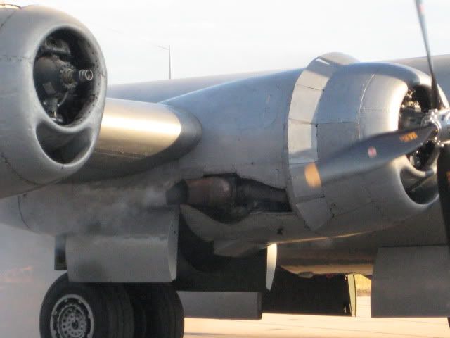

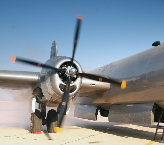

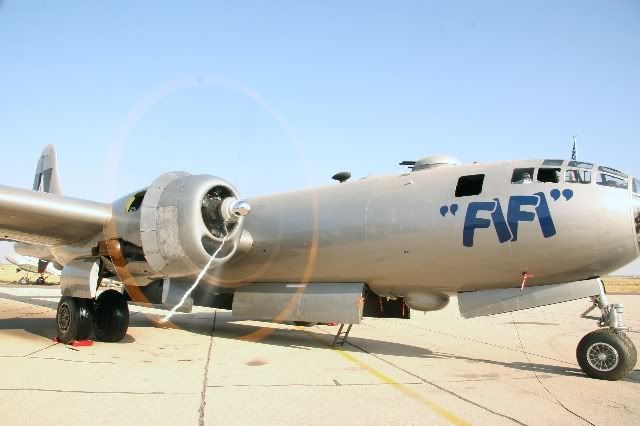

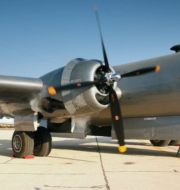

Sunday September 6, 2009. FIFI leaves the hangar for a full power test on the new engine on the number three position.
Set in place just outside the hangar by 500 feet or so, the engine gives the very first puff of smoke!
The very first rounds under her own power. Look at that smoke!
Smoke cleared and now we're goin!
Full power and now, the full 2000 horse power! Feel the Thunder in your chest. Man can that baby purr!
One down and three to go! The light is at the end of the tunnel. Here she is on the tarmac, just waiting for the day.
John communicates with the crew in the cockpit via intercom. Every thing is a go here!
The final word from the crew chief, Dave. Look at that grin. All the numbers are good. Boy, is he a happy camper!

Not a critique - a question: Is it okay to run a single engine to full power without its symmetrical partner run up as well? Maybe it's a C-130 thing.
Congrats on the success - the shiny prop hub is looking fine (particularly while turning)!

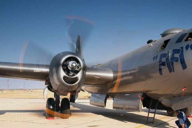

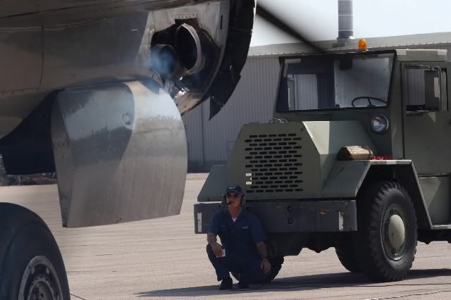

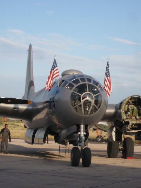

I can only add a few photos that my wife took while we were doing this historic engine run. Marks shot of the prop in full sweep is very cool!.
This is John Flynn and I going over the prestart and after start check list.
This is the first puff of smoke from the start for the media run.
this is after the run and I put up the flags,
