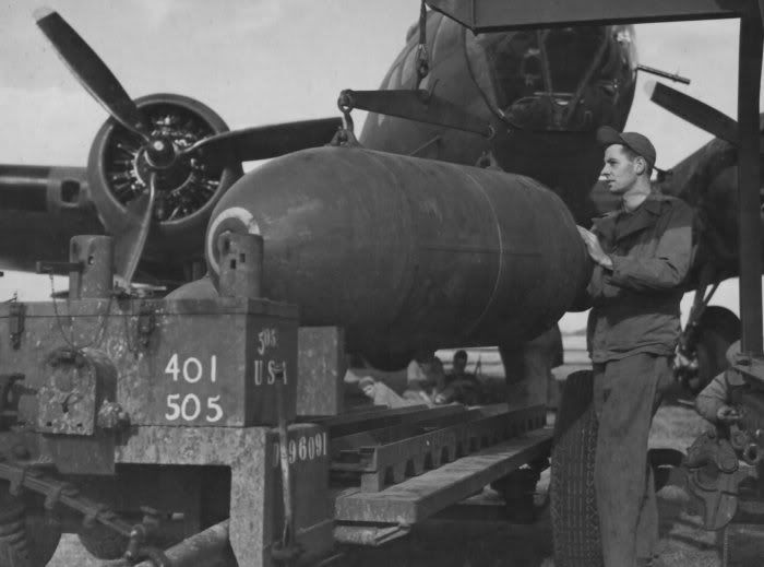

Django, I have been using this photo taken by Charles Chandler as my inspiration:
The airplane is Devilish Snooks and the photo was taken at the 40th Group home base at Chakulia, India. I'd sure like to have that bomb loading truck under my tree in a couple of weeks. (You listening, Santa?)

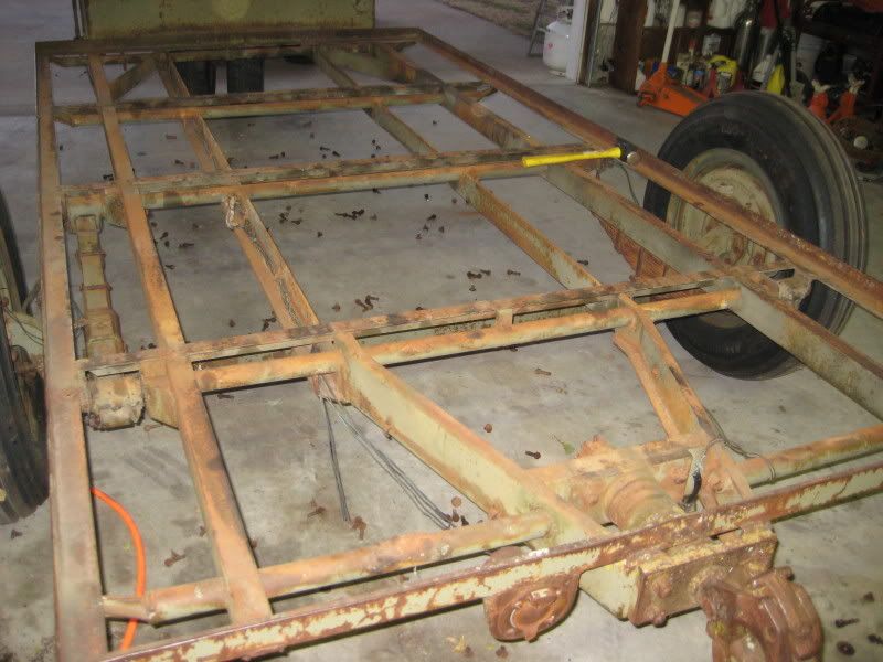

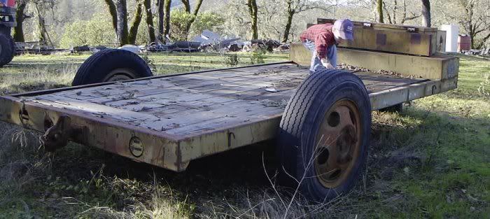

About all I've done to the trailer is cut all the corroded deck bolts off. Next it's off to the media blaster! I'll start laying out the toolbox after the holidays.

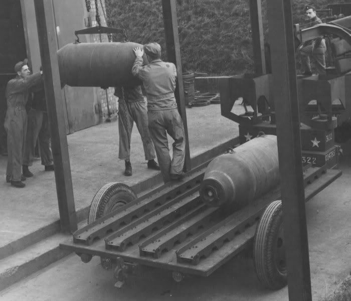

There are actually a fair number of M-5s around, it is just a matter of finding them. The G503 website "1/2 Ton Trailer" forum has a couple of posts about bomb trailers coming up on Govt. Surplus sales in the past few years! As far as towing them goes, the darned thing is heavy, even empty. It weighs over a ton empty with a 5,000 pound payload, something that I'm sure was NEVER exceeded in the field :roll: . As evidence, here is a photo of Ordnance men loading an M-5:
Notice how the main frame and forward frame are bowed from the load. I guess no one read the data plate before going to work.
Scott

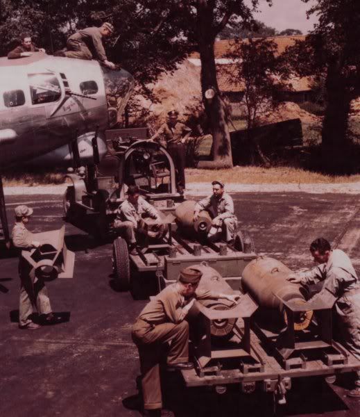

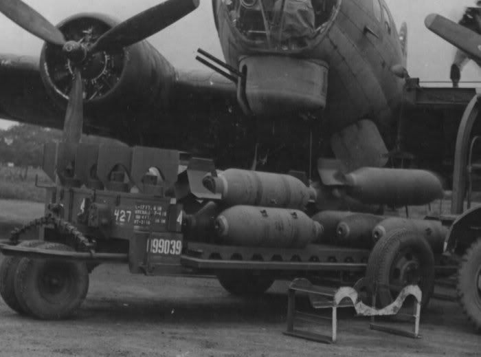

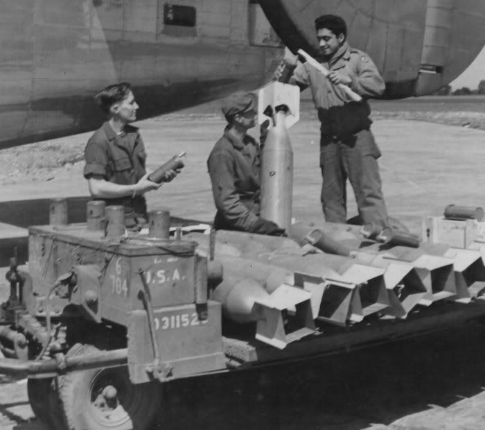

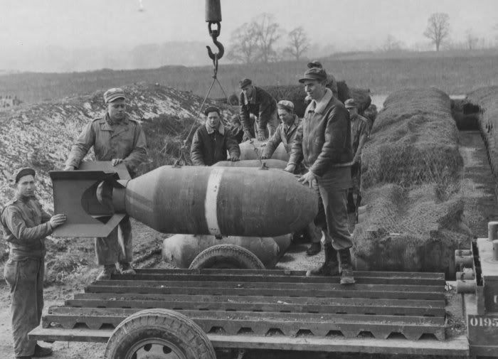

I'm gathering quite a few photos of M-5 trailers together lately.
Plenty to see here.... from the clamps and chains etc. on the trailer, the M-6 Truck hiding in the background, fuze tubes being loaded into the toolbox, to the shelving made up from old bomb fin transit frames.
More to come,
PB

The photo you posted is a great reference for the fin holder pins and chains, not to mention all the other details it reveals, such as the bomb cradles clamped to the rails with the large wingnuts. Do you know which Bomb Group or Service Group the men and machines were assigned to?

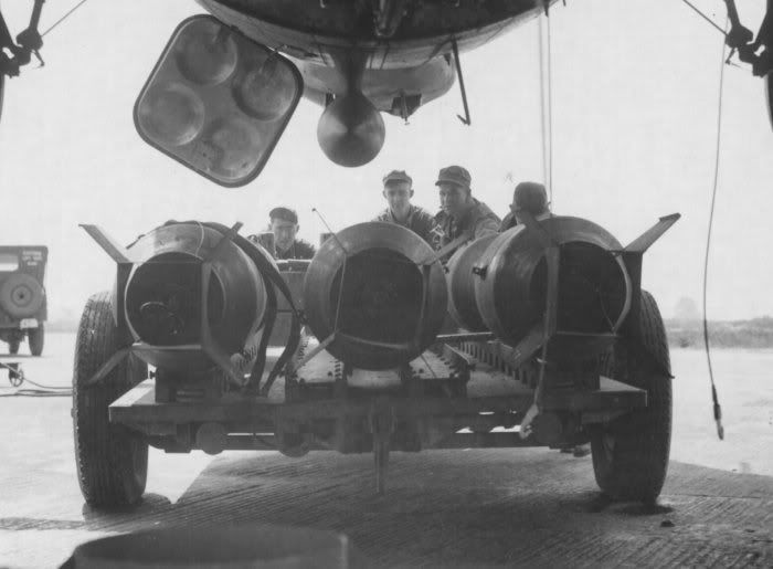

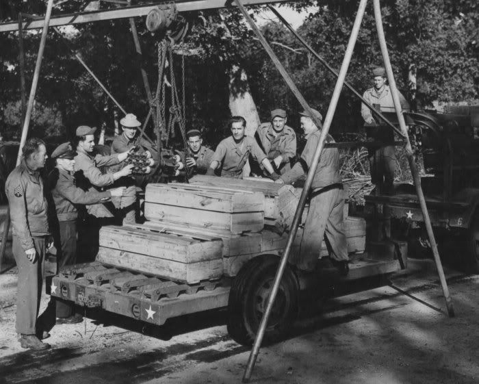

More photos.
I have hi-res versions of most of these, if anyone needs any closeups.
784th Bomb Squadron, 466th Bomb Group, RAF Attlebridge:
381st Bomb Group, RAF Ridgewell, September 1943:
401st Bomb Squadron, 91st Bomb Group, RAF Bassingbourn:
PostPosted: Fri Jan 09, 2009 4:10 pm
Posts: 550
Location: Northants, UK
392nd Bomb Group, RAF Wendling:
PostPosted: Fri Jan 09, 2009 4:17 pm
Posts: 550
379th Bomb Group, RAF Kimbolton, 6th June 1944:
353rd Fighter Group, RAF Raydon. (Note thick side and rear panels on this M-5):
322nd Bomb Squadron, 91st Bomb Group, RAF Bassingbourn, September 1943:
427th Bomb Squadron, 303rd Bomb Group, RAF Molesworth:
535th Bomb Squadron, 381st Bomb Group, RAF Ridgewell:
532nd Bomb Squadron, 381st Bomb Group, RAF Ridgewell:
TTFN,
PB

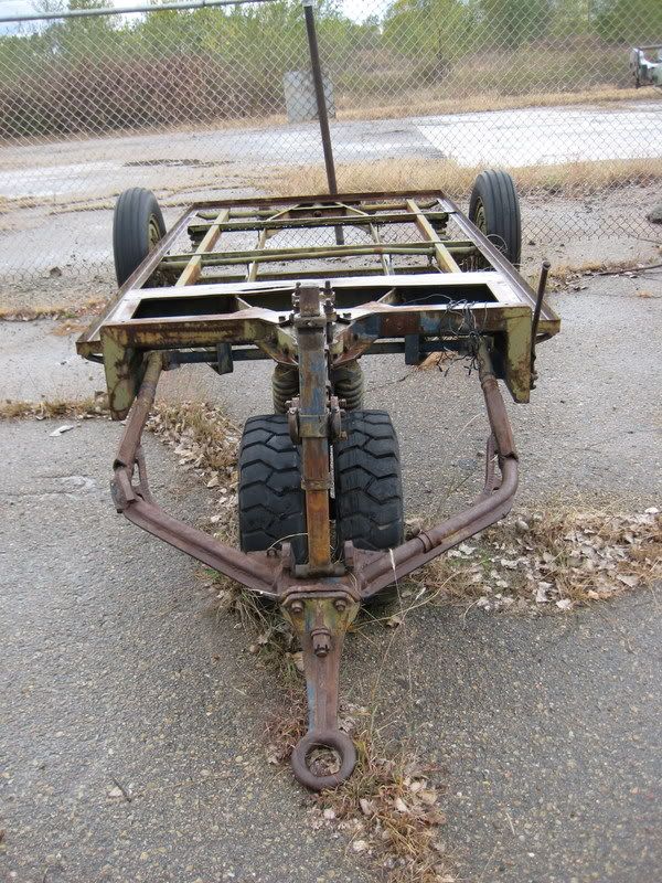

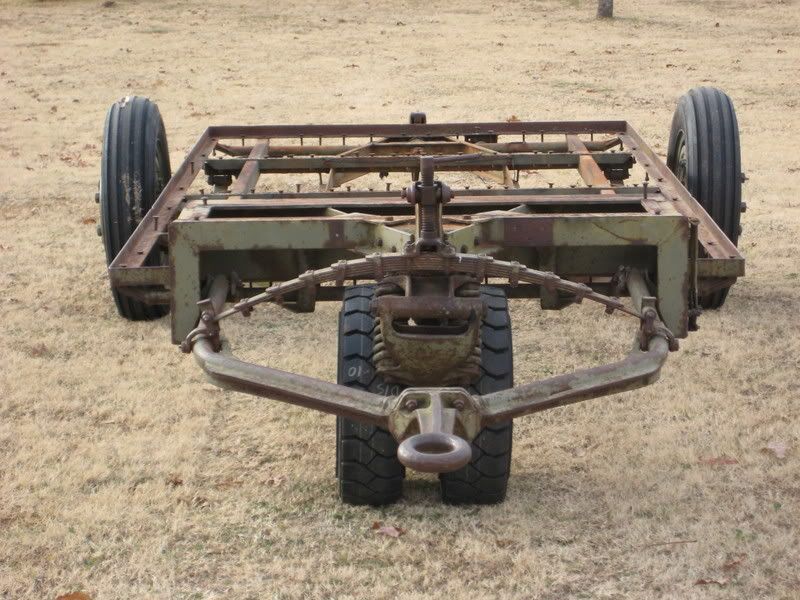

You referenced the trailer with the deeper rear and side rails--I am still learning a lot about the various M-5 changes, but I believe that trailer is the third design. The trailers with the transverse hitch spring and five-hole main wheels are first design. That is the type we're restoring:
Second design has the spring longitudinally mounted with a bit different drawbar and eight-hole wheels:
The third design also has the longitudinal hitch spring, eight hole wheels, and the deeper frame as in your 353rd Fighter Group photo.
