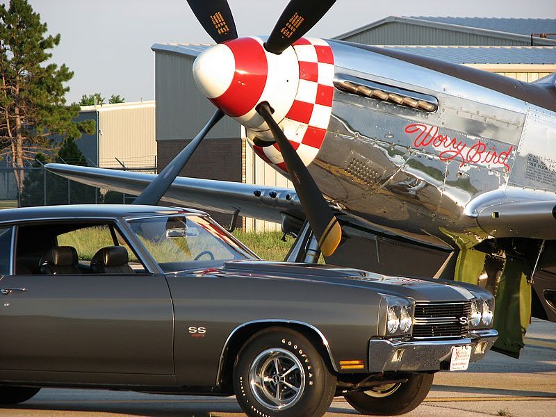

Just found this site today by accident while surfing and must say I am impressed. I have been following this and the MN CAF's B25 for years and it seems like the only way I can find pictures of some of my brother's work is to see it on sites like this. Until Don Hinz's untimely death I had occassionally helped with the restoration of their Red Tail P51. After he was killed I could just never go back again but was thrilled to see it once again flying and doing the Tuskegee veterans proud. Previous to that I had helped the MN CAF in the 70's with my dad on their B25.
Jeff Nelson from Custom Connections is my brother and was instrumental in teaching me the finer art of anal details which has a lot to do with my success in my restoration business today. I can see by his and these photos it has paid off for him as well. I have never met anyone as dedicated and safety minded as he is. Sometimes it gets irritating but he will not stop until it is done and done right and that goes for anything he does. I look forward to watching this project progress and my hats off to all those who are working on this Mitchell.
Below is one of my company's restorations shadowed by Mike George's Illinois based "Worry Bird" P51 who graciously allowed me to 'use' it for the day. He has again offered up his Corsair to do another photoshoot with a customer's Camaro coming up soon.

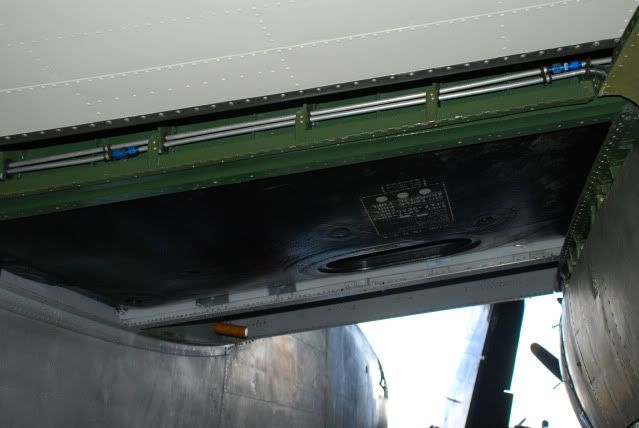

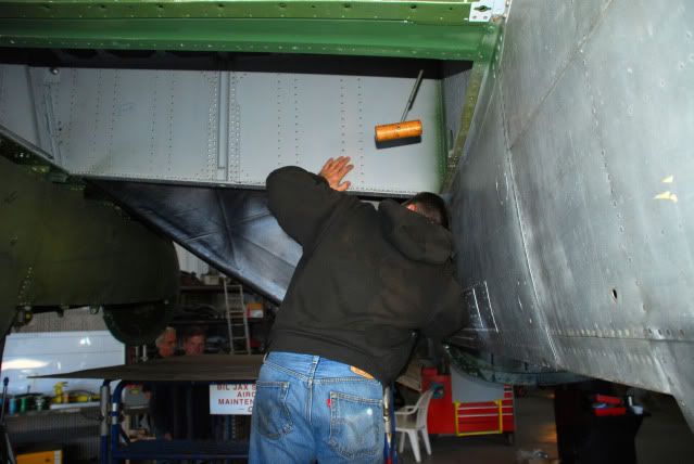

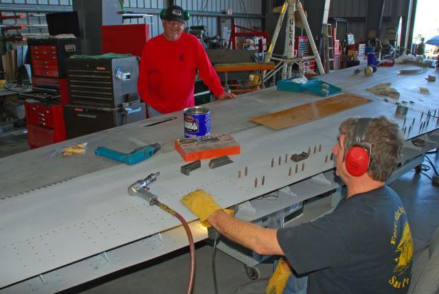

I must admit this is the hardest time of the year for me to get motivated for the drive down to CMA. Getting up at 0500 is never fun but when it is pitch dark and 27 degrees it makes it a wee bit harder. The sky was clear so I wouldn’t have to worry about ice and snow and the thought of enjoying a few hours of nice Ventura County weather made me feel better. As I cruised along Interstate 5 I called ATIS to check the weather at CMA and was informed that it was only 2 degrees Celsius. With that inspiring news I turned up the climate control and jacked up my seat heater and forged ahead.

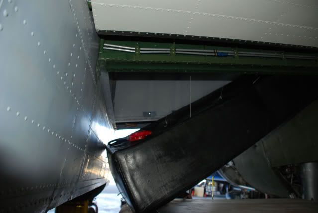

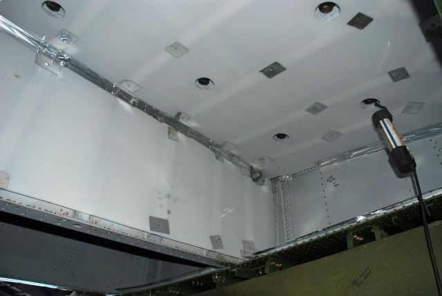

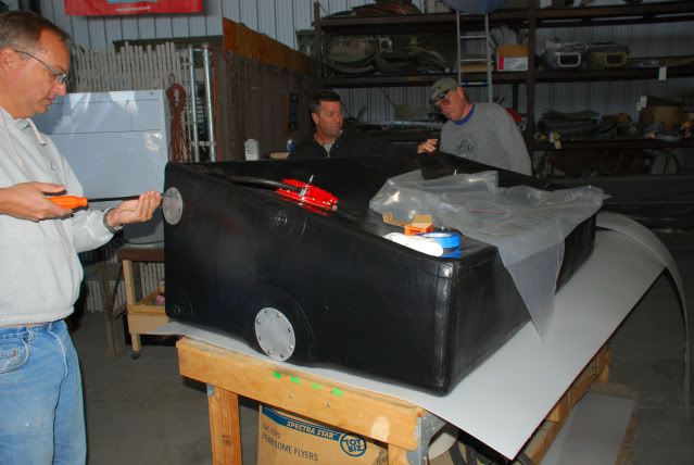

We had a full crew with the exception of Bucker Boy who is in MIA doing a PC. Our main goal for the day was to install the right aft main fuel tank. This is the heaviest tank that we will install due to it being the old style self-sealing type. All of our other tanks will be the new, thinner and much lighter bladder tanks. Using this older tank, which has been certified and is in virtually new condition, saves us many thousands of dollars. By virtue of the older self-sealing tank’s design it is very ridged which calls for a tight and precise fit. It took hours of horsing and prodding and coaxing but by the end of the day the tank was up and in place. Full installation should be completed by next week.

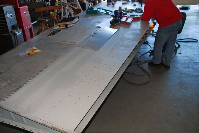

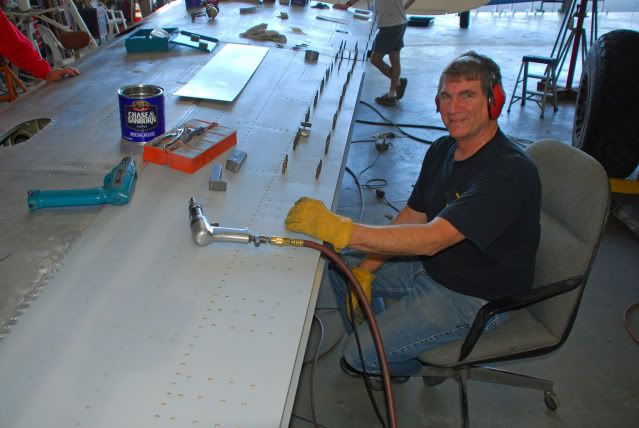

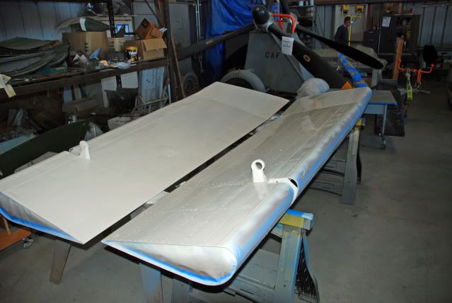

Jerry is getting close to finishing the left wing attach angle. John is cranking away on the fuel system. Alan is working on the fire extinguisher system. Dave is working on cleaning one of the main fuel doors prepping for paint; Mike is getting ready to paint the ailerons and Ken is working on a wing repair. Several of our guys work two or more days a week. I’m starting to feel out of the loop being so far away but until Marc buys me a home in Simi I’m still resigned to a once a week trip to CMA.

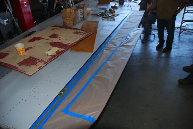

Yesterday we had a full crew with the exception of Scott who had to fly. We continued focusing on the left wing repairs and fitting up the aileron. We also ordered our oil tanks. We will hang the wing for good in a few weeks. Also we obtained new glass for our top gun turret. We will remove the turret and place it on the ground so that it can be completely cleaned and spruced up before we install the glass.
