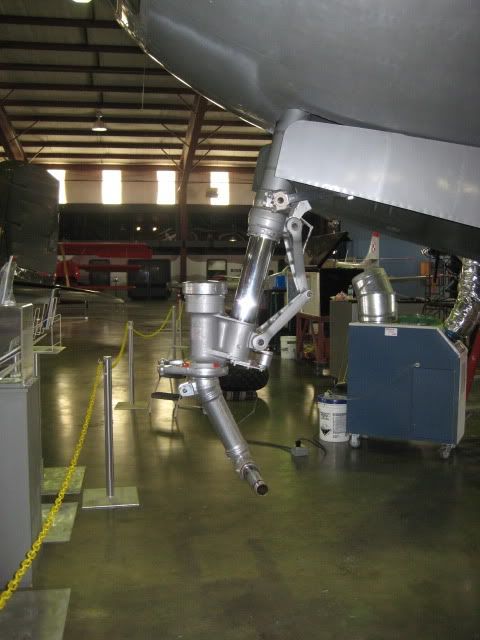

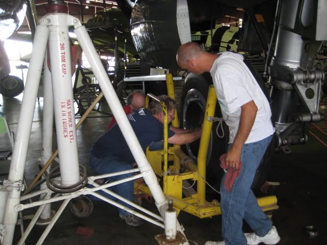

I have some pics from recent weeks that I just haven't had time to post so here goes.

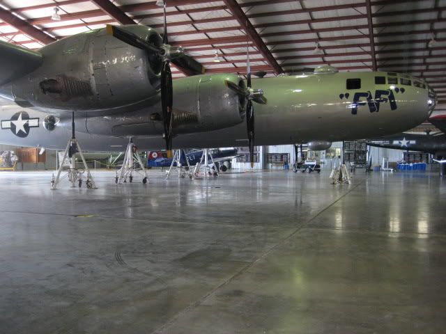

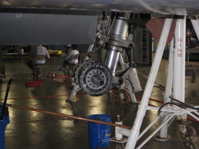

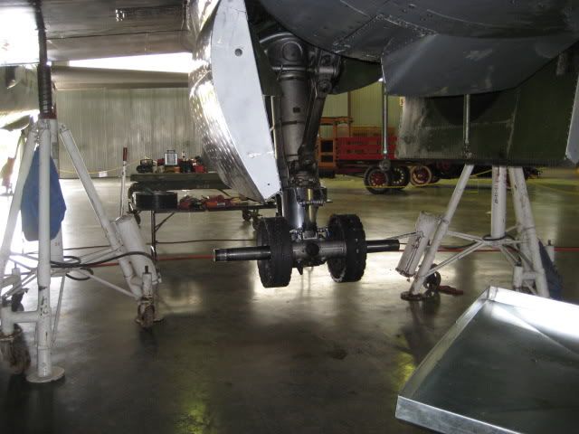

We did our gear swings and all went well. While in the jacked position, it gave us time to go over everything gear related. All the wheels got pulled. Bearings, axles, brakes, wheels, bolts, cables, hoses and other gear componets were inspected, cleaned, greased, replaced and otherwise functionally checked.
Once we got the tires all built up and put on, we finished our gear swings under normal extension and retraction, auxillary extension motors and emergency extension, the dreaded crank down method!!
Here's Rick, James and Don putting the mains back on.

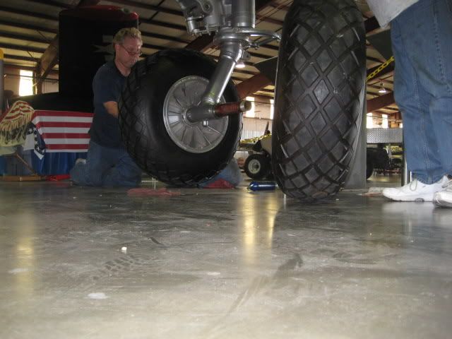

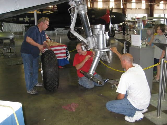

Now the nose tires.

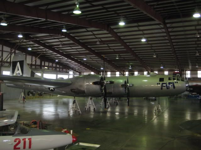

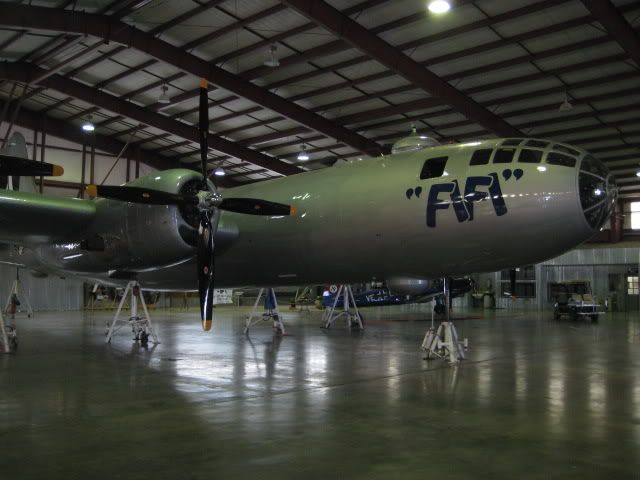

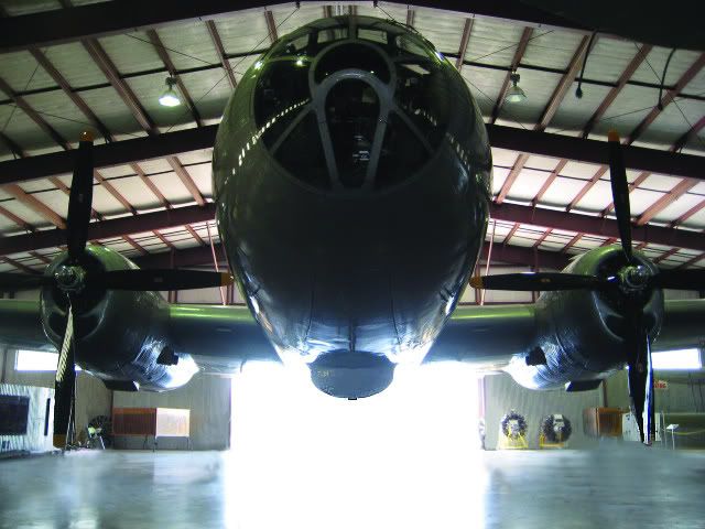

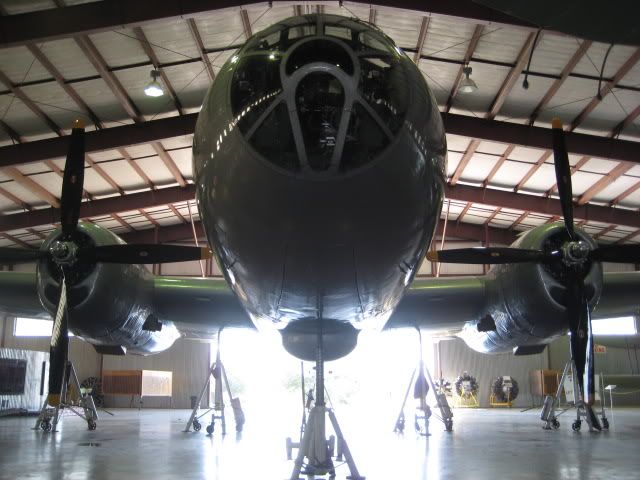

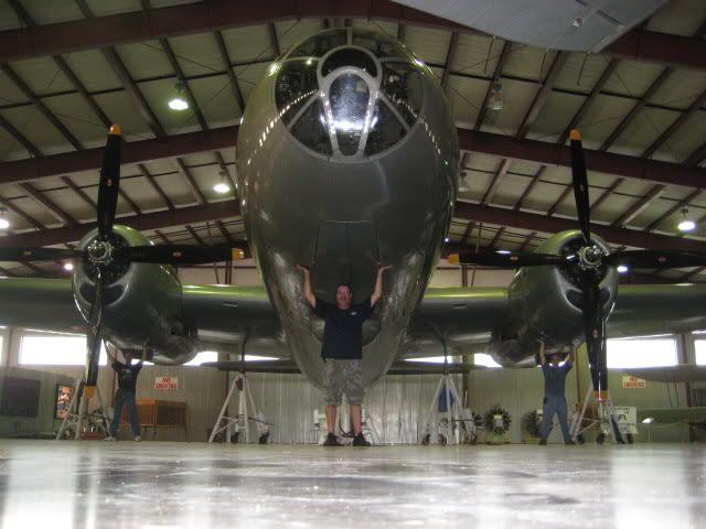

Sunday we had some fun! We moved everything away from the airplane, got our swings done and took some pictures.

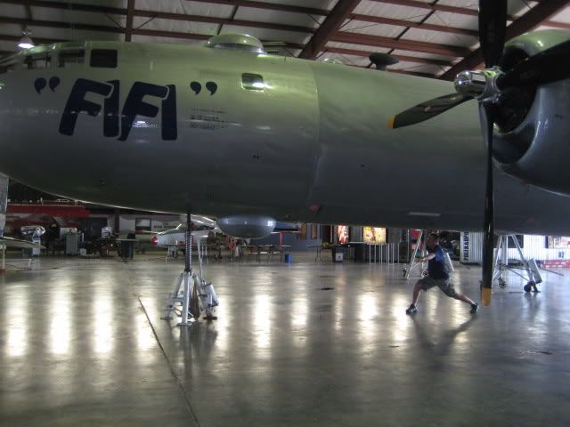

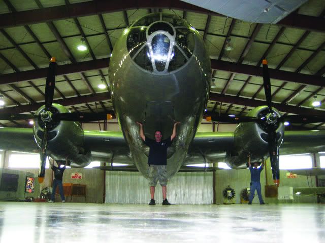

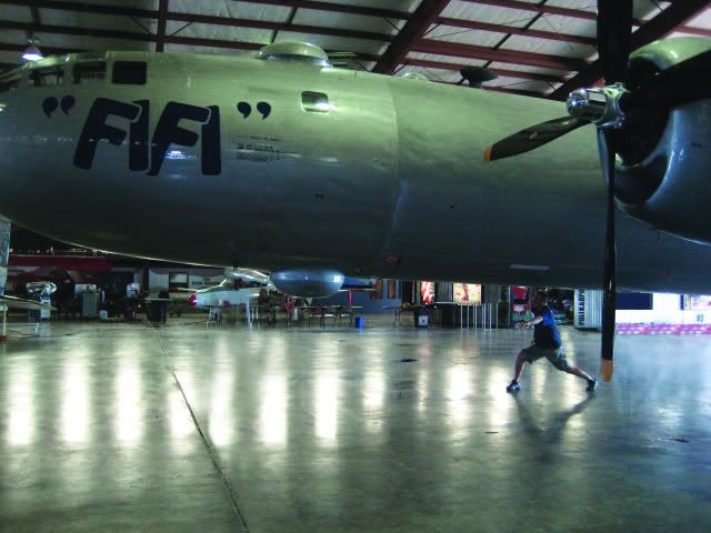

I said we were out to have some fun!!

Dare ya to do it with the B-24 Dave. :)
