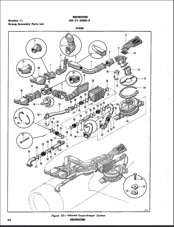

Not sure if this will help you or not, and you probably already have this, but here are shots of the maintenance manual and parts catalog for it. I hope this helps. If you need better copies let me know, I have them in PDF format and can email you the sections you need. The entire manuals are too large to email.
I always dreaded having to take those things out when we had Chuckie. I considered it when we had the inboard fuel tanks out last year doing the spar AD but didn't see a reason to at the time.
