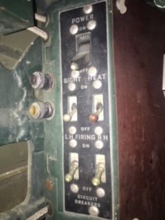

Can any one help out please , I am wanting to recreate the power supply box that sits on the left hand side of a B17 Sperry A1 upper turret.
I have the switches but I just need the out side dimensions so a new one can be made ?....thanks

Fortress Fan wrote:Any chance I could have the dimensions as well. Still need to make one for my sperry turret
Thanks in advance
These are the dimensions of the top turret control panel from Lone Star Flight Museum's B-17G "Thunderbird".
I don't know what the model top turret is, I doubt it is any kind of early one. I'll be happy to email pictures if you want to PM me your email address.
Control Panel: 8-3/8" X 2-1/16", mounted to a housing approx size: 10-1/16" X 3-5/8"

Re: B17 sperry upper turret control box
Mon Aug 19, 2019 1:47 pm
Got the picture to upload. Hope it helps.
