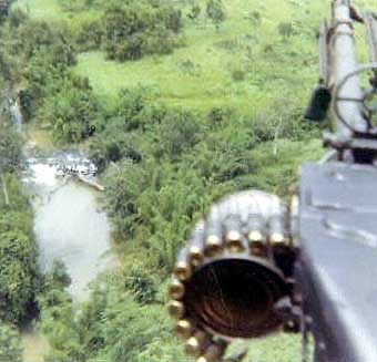

The M 60s on our slicks in Vietnam were prone to jamming when using the regular feed chutes.The common fix used by our crew chiefs and door gunners was to use a fruit can attached to where the chute clamped on and to feed the belt by hand.I was up front flying so I don't know if it was certain M60s,dirty guns, or certain fed chutes, or some combination that just didn't work.

lucky52 wrote:The M 60s on our slicks in Vietnam were prone to jamming when using the regular feed chutes.The common fix used by our crew chiefs and door gunners was to use a fruit can attached to where the chute clamped on and to feed the belt by hand.I was up front flying so I don't know if it was certain M60s,dirty guns, or certain fed chutes, or some combination that just didn't work.
I never saw those feed chutes in Vietnam although I've seen photos of them. We always used a C Rat can on the gun. It fit perfectly with the clasp intended for 100 round ammo box originally used. The ammo in a mini gun can on the floor. Hand feeding the belt was not necessary.
