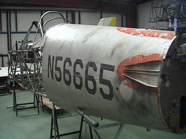

Dan:
Included for your review is the closest picture of the tail cone of an ukn BT-13 found on the www.
FAH619®
PostPosted: Thu Jun 23, 2005 6:56 pm
Posts: 11324
A few years back there was a requirement put forth by the FAA for all aircraft to have their serial numbers marked permanently on the outside of the aircraft. Some have done that with paint, others have done that with decals or metal plates. Don't know what this particular case depicts, just realize that there may be plates on some aircraft which were not installed by the factory or in military service.

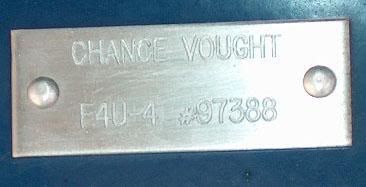

BDK:
Rg! We found one on the R/S, aft section of F4U-4 97388 during the Bridgeport F4U gathering. Here for your review. Tks. C/w.com
FAH619®
PostPosted: Thu Jun 23, 2005 8:46 pm
Posts: 11324
If it is somewhere on the aft tailcone that would be it! Make, model, and serial number. Looks a bit home made, but a very clean job of it.

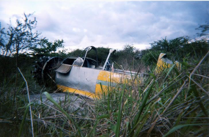

bdk & A/P Folks:
Engine ID Help:
BT-13s Folks: Are you able to tell fm this picture whether this is a P/W 985 engine or a Wright 975 Whirlwind? Photo B. Pilgrim. TNT c. 97-98.Tks C/w.com

HI THE DATA PLATE IS A F.A.A/D.E.A. REQUIREMENT ITS MADE OF STAINLESS STEEL WITH MAKE,MODEL,AND N NUMBER INGRAVED ON THE TAG,IT MUST BE LOCATED ON THE TAIL SECTION CLOSE TO THE HORIZONAL STAB.IT IS USED TO HELP IDENTIFY THE REMAINS OF AN A/C IN CASE OF A CRASH/FIRE.THANKS MIKE
