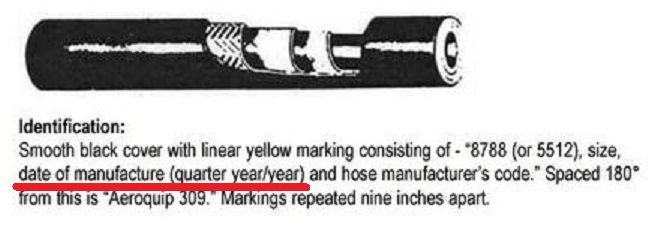

gtokid wrote:
The hose should have a manufacture date stamped on it. Modern aircraft hose has a "Q" date, like 4Q99 would be 4th quarter of 1999. Old hose may be different.
Yes. In fact, the parts manual supports just what you're saying.
However, I believe the date information is slightly different ... indicated on the hose by the marking "3/56" (meaning "third quarter of 1956"). Of course, that would also be in line with the 1957 Crusader crash.
PostPosted: Fri Jun 10, 2016 11:18 am
Joined: Sat Jan 10, 2009 12:19 pm
Posts: 201
Location: Canada
"gtokid" brought up an excellent point with regards to the cure date on the hoses. I seem to recall that way, way back the date format changed to the "xQxx" format we use today. If there is an older, maybe "month/year" format that was used once upon a time, maybe it's described in good ol' AC43.13 or something.
