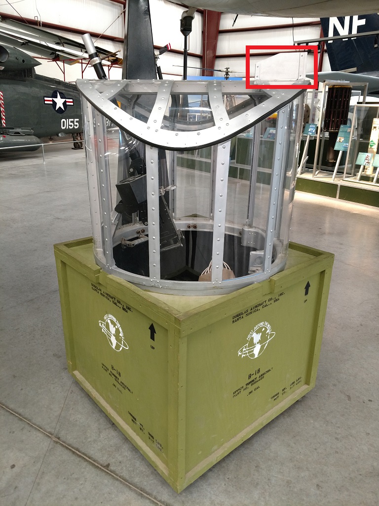

What was the purpose of the fin(s) on the top of the dorsal turret on the B-18?
File comment: Source: Me!
I remember reading somewhere (here?) about how it was tiring for World War I gunners to have to fight the air stream when rotating their gun, so maybe it has something to do with steadying the turret? Apparently, some Soviet turrets had something similar.

The fin on top (rear, really) of the turret balances the drag of the guns sticking out the front Yes, you can definitely feel the differences when manually cranking a turret around into the slipstream vs letting it blow the guns aft.
