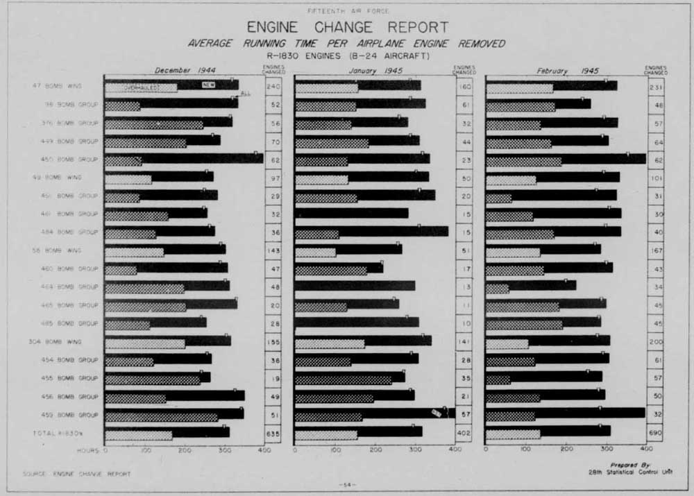

For those interested - the 15th AF stats on engine change times
PostPosted: Tue Mar 10, 2020 10:40 am
Posts: 557
Those charts are very interesting! I did not know engine changes occurred with such frequency.
Great info! I'm sure the fighter engines were run a lot harder than the bombers too.
