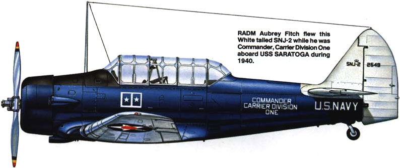

Over the years there have been several color profiles of this aircraft created, one of which was featured in the popular Squadron Signal “In Action” series of books for the T-6/SNJ aircraft. There was also a decal set created that featured this exact aircraft. There is also a restored SNJ-2 that mostly features this paint scheme but has a marine corp rudder marking.
The two issues I found with all of the profiles is with aircraft version type depicted and colors. All of the profiles featured the standard AT6 A-D/SNJ-3/4 that featured the “gunnery” tail cone and moveable rear canopy with a “boat tail” SNJ-1/2 rudder added on to make look like a SNJ-2. The SNJ-2 actually featured a fixed rear canopy like the Harvard and Yale. The SNJ-2 also had a unique tailcone for the T-6/SNJ series that was approximately 5 13/16’ shorter.
Color wise, the fuselage colors in the book (which also has the picture of the actual aircraft) were also incorrect with white wings and fuselage lettering presented. At least one other color profile based the inaccurate book drawing exists.
The reality of the paint scheme is a bit complicated. The wings were partially painted standard chrome yellow with to the leading edges and bare aluminum on the bottom. The blue however was a very special “Admiral Blue” that was much darker than the standard training scheme “AN Blue”. There is no known paint specification to reference and has been said to closely resemble “Insignia Blue”. The distinctive white tail color seemed to be the one item agreed upon in all depictions, again “Insignia White”. The sheen seemed to be semi gloss (I have not confirmed this)
The most “controversial” aspect of the paint scheme was the color of the lettering. From the model decal set instructions “There are conflicting references for the color of the fuselage lettering some yellow, some suggest aluminum some say white”. The model kit and color profile lettering are depicted in white and the restored SNJ-2 in yellow.

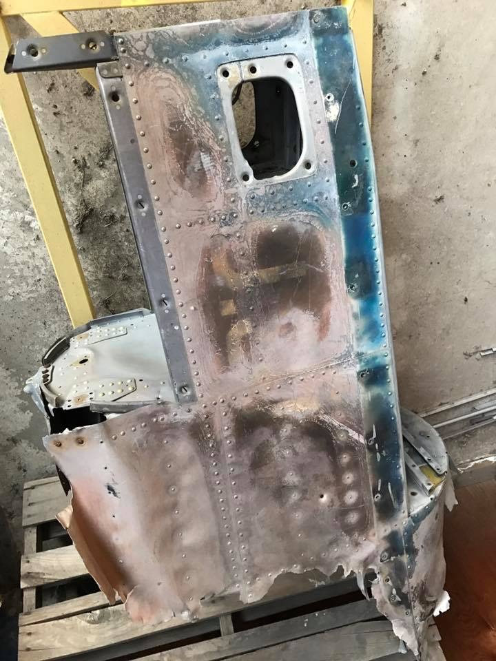

Knowing all of this, I was curious what colors were left on the recovered wreckage of BuNo 2549. Fortunately after approximately 50 years of exposure on top of a mountain and having burnt after its crash landing some of the lettering and fuselage, tail colors still existed. However this is where I really struggled. The areas that had been covered by fairings had some of the blue but it was not as dark as insignia blue and the lettering “appeared” yellow but I could not exactly determine it. I tried all types of color experiments with pictures to take color and digitally turn them black and white to approximate the light or darkness of white/yellow to try and solve the puzzle. I also referenced other pictures/depictions of other “Blue Goose” aircraft schemes and found they too were not consistent. I was at a standstill until other factors intervened. Colors photos of the crash site taken by Pat Macha were discovered through the
assistance of David Trojan that showed more detail.

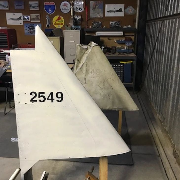

Final picture shows the original vertical stabilizer with the faint markings of 2549 along side a “replica” painted insignia white with 2549 applied.
