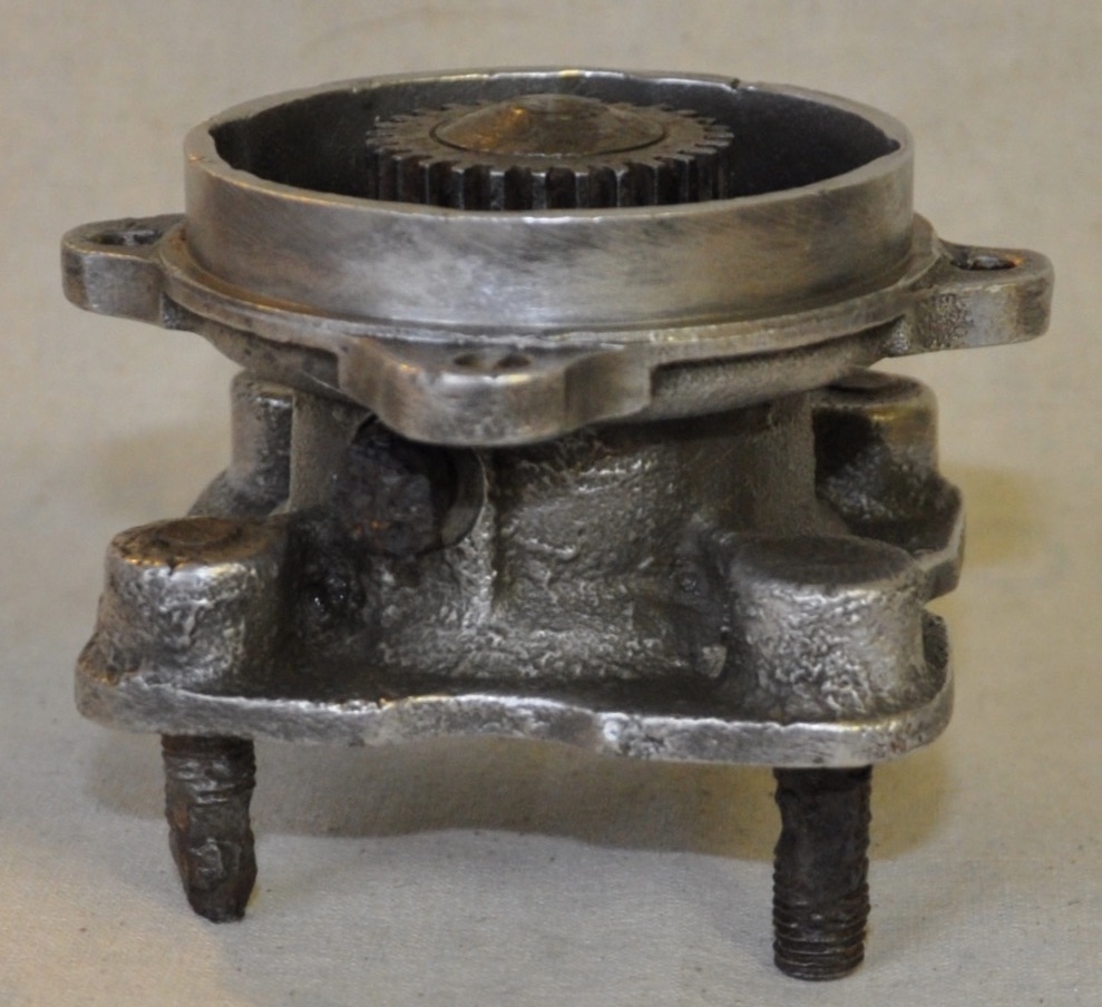

This part arrived in the post this morning along with a B17 flap control casting. So a mixed bag of parts form a crash collector.
This part has a splined shaft that turns/is turned by the cog on the top. Designed to be bolted to something and with a part number of 5364842-8 it sounds like a Douglas part number and possibly C47.
I have checked the C47 parts list from 1952 and it is not shown.
So is this a C47 part but from an earlier model ?
Any guidance on where it was from ?
Thanks

 Post subject: Re: C47 Part
PostPosted: Sat Jan 25, 2020 5:09 pm
Posts: 1488
Location: North Texas

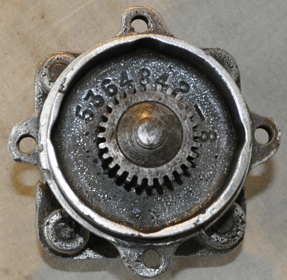

Brian: Have a photo of the opposite face? Might give some clues as to what system to be looking at.
PostPosted: Sun Jan 26, 2020 3:55 am
Joined: Thu Mar 07, 2013 3:41 pm
Posts: 125
Location: Farlam Cumbria UK
Trouble getting image down to required pixel sizes so attaching pic of back via another route,
Hope this helps. Splined shaft entry at back.
PostPosted: Sun Jan 26, 2020 7:53 am
Posts: 1488
No clue right now. P/N sorta follows Douglas system, but could be for anything they built. Construction suggests that it's a low speed motor or hand drive adapter. The machining looks to be a single small drive/driven pinion that was 90 degree indexable for various installations. Cowl flap drive, shutter door of some type maybe?
PostPosted: Sun Feb 23, 2020 10:34 am
Posts: 125
Just thinking that this came with a B17 part - whether it was B17.
The parts catalogue for the G and E don't have it but similar numbers are used for the windshield wiper motor assembly.
Possibly part of the motor assembly/flexible drive for a windshield wiper?

 Post subject: Fuel Booster Pump
PostPosted: Fri Jul 09, 2021 6:59 am
Posts: 125
at the weekend I bought an Avro Shackleton chair and along with it came a couple of parts including a part I recognised.
The unknown part above is the head from a Delco Fuel Booster Pump - as it is identical to the Delco pump that arrived at the weekend.
I was checking the B17G catalogue and it shows a Fuel Booster Pump - but specifically a Thompson one is listed.
The Delco WW2 promo catalogue shows that the Delco fuel booster pump was used on early B17s.
see page 11
http://usautoindustryworldwartwo.com/Ge ... oducts.htm
So is this from an earlier model B17 or from another aircraft ?
Image Image Image
Kind Regards,
Brian
PostPosted: Sun Jul 11, 2021 11:56 am
Joined: Mon Jan 14, 2008 5:49 am
Posts: 179
Location: Normandy - France
5364842 Case - Gear
Thompson Electric Motor-Driven Fuel Pump
