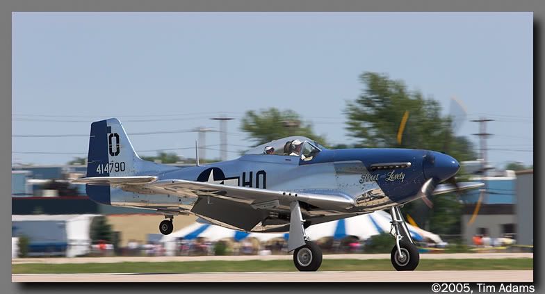

typical wheel landing of a P-51
Martin
Martin
I noticed this Mustang doesn't appear in the Warbirds Registry unless I missed it. I found it here:
http://www.mustangsmustangs.net/p-51/su ... 3279.shtml
Martin
Hey, thanks for pulling a photo off my website. Next time please ask though!! :o
www.timadamsphotography.com
PostPosted: Sat Jun 17, 2006 6:12 am
Posts: 1521
@ Tim: PM sent
