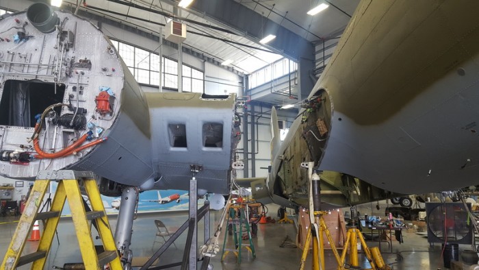

PostPosted: Mon Nov 13, 2023 4:16 pm
Joined: Wed Aug 16, 2023 12:33 pm
Posts: 10
Late to the party here, but I had trouble getting registered on the site for a while.
Anyway, here are some pictures I took of Ye Old Pub in June 2019 when I was living in Madras, OR. The day I took the pictures they were reaming the tapered holes in the wing attach fittings.
Last edited by Stephan Nelle on Mon Nov 13, 2023 4:20 pm, edited 2 times in total.

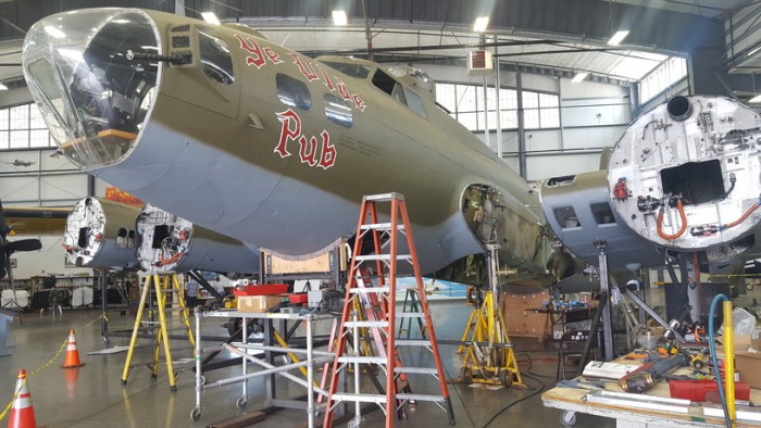

PostPosted: Mon Nov 13, 2023 4:17 pm
Posts: 10
More

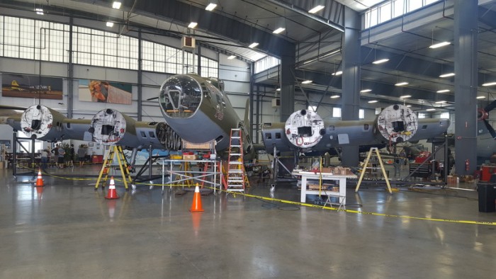

PostPosted: Mon Nov 13, 2023 4:20 pm
Posts: 10
more

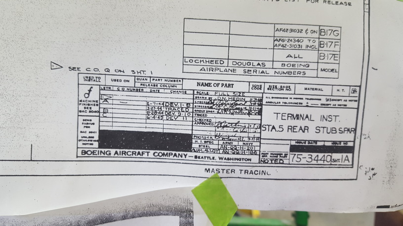

PostPosted: Mon Nov 13, 2023 4:21 pm
Posts: 10
more
