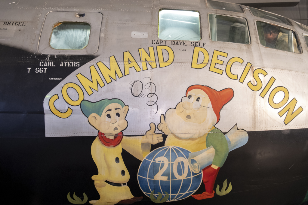

It's interesting to note the varying depictions of the nose art.
Korean War:
(Source: National Museum of the United States Air Force)
Korean War:
(Source: B-29s in the Korean War)
Korean War:
(Source: B-29s Over Korea)
Wright-Patterson Air Force Base, 1959:
ms458_jhanp_21p_26_001 (Cropped, Reduced, Converted).png [ 950.22 KiB | Viewed 2726 times ]
(Source: Wright State University)
National Museum of the United States Air Force, 2008:
(Source: Department of Defense)

quemerford wrote:
I assume that the crew names on the 'derelict' fuselage apply to those on the replacement B-29?
That's an interesting suggestion – checking the names on the fuselage positions. It's not a perfect match with the dump area photograph, as his first initial is "C", not "G", but the National Archives has a photograph of one "1st Lt. Carl L. Hinchey" who was a B-29 pilot in the Korean War.
Warbird Philosophy Webmaster
PostPosted: Wed Dec 20, 2023 2:56 pm
Posts: 1702
Noha307 wrote:
Interesting. Assuming there's a reason for 'G' rather than 'C', maybe the 'derelict' is a 98th BG aircraft? So it looks like the real Command Decision disappeared between 1954 and 1957?
