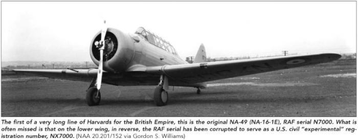

I was just perusing my copy of North American's T-6: A Definitive History of the World's Most Famous Trainer today and I came across this interesting picture and caption that hints at a potentially larger trend:
File comment: The first of a very long line of Harvards for the British Empire, this is the original NA-49 (NA-16-1E), RAF serial number N7000. What is often missed is that on the lower wing, in reverse, the RAF serial has been corrupted to serve as a U.S. civil "experimental" registration number, NX7000. (NAA 20.201/152 via Gordon S. Williams)
(Source: Dan Hagedorn, North American’s T-6: A Definitive History of the World’s Most Famous Trainer (North Branch, MN: Specialty Press, 2009), 62.)

After studying these aircraft and their expanded family for 60 years, I have to admit that the Harvard caption from Dan Hagedorn's book threw me for a loop, because I had never seen that apparent situation before. However, I'm afraid that after a few minutes with photoshop and paint shop pro, it is obvious that the underside of the wing shows N7000. There is no X. I wonder if the author grabbed the wrong image? At least this has given me something to search out...just when you think you're retired!
Doug

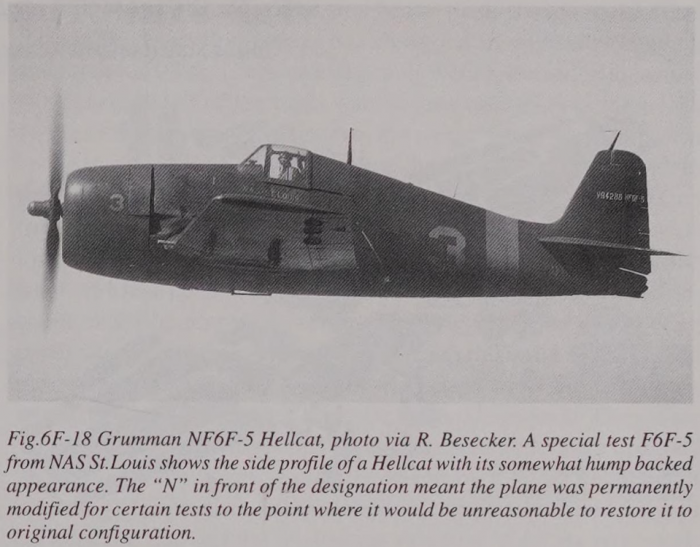

A little off topic, but the other day I came across a picture of an F6F-5 marked as "NF6F-5" and "V94286":
(Source: Francis H. Dean, America’s Hundred Thousand: U.S. Production Fighters of World War Two (Atglen, Pennsylvania: Schiffer Publishing, 1997), 575.)
This is interesting, because the "N" status prefix for permanently modified test aircraft was a USAF convention that did not appear on Navy aircraft. (In addition, the earliest instance of an "N" prefix I could find after a quick search was an NC-121K so designated in September 1962, so it may have come in with the tri-service sequence introduced that year.[1] For more on the origins of status prefixes, see a post in another thread.)
It reminded me of a post on one of Tommy H. Thomason's blogs that shows an F-84 with similar markings:
(Source: U.S. Navy Aircraft History)
Making the connection even more intriguing is that Mr. Thomason makes the supposition that the F-84s were acquired to replace F6F-5K target drones. So, it's very likely that the same organization that was responsible for the markings on the NF6F-5 also painted the F-84.
So, while they're not technically registrations, they do fall into the category of "multiple instances of odd identification markings on American-built military aircraft".

PostPosted: Mon Nov 25, 2024 3:21 pm
Posts: 1700
The 'X' on the F-84 in this case is an indicator of test status; FJ-3D2s were likewise referred to (and recorded as) "FJ-3D2X" prior to delivery. It seems to be a Navy quirk, and a means of identifying a non-Navy aircraft - K meaning drone and the 'X' as explained.
