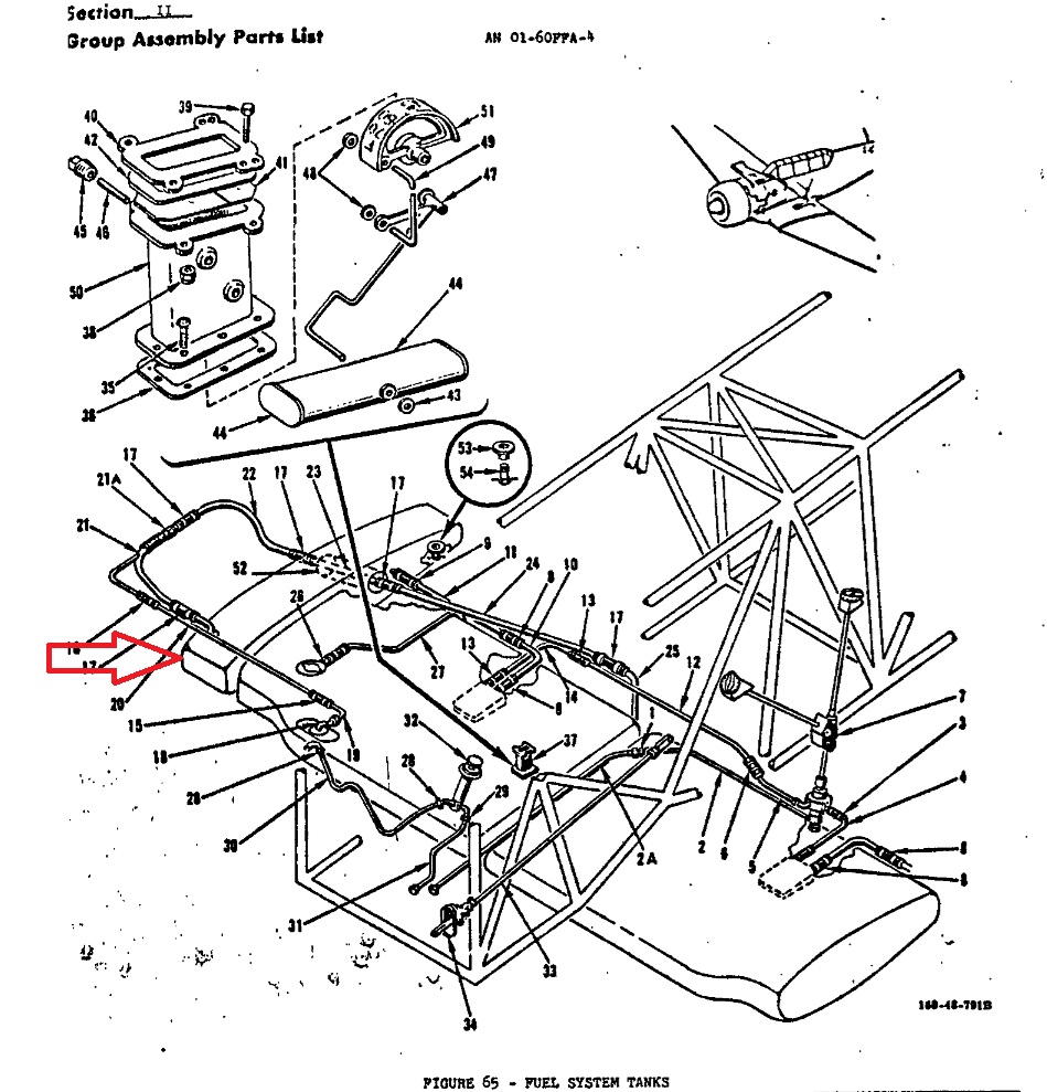

Did the T-6G model have any sort of bladder type fuel tanks? There was a T-6G crash last Saturday about 70 miles southeast of Houston and unfortunately two people died but there was no fire. Thanks.

I checked the AT-6G Maintenance Manual. It shows aluminum fuel tanks except for small rubber aux wing tanks that are outboard of the main tanks.

The T-6G had small bladder tanks outboard of the main aluminum center section fuel tanks. All crashes do not result in a fire.
