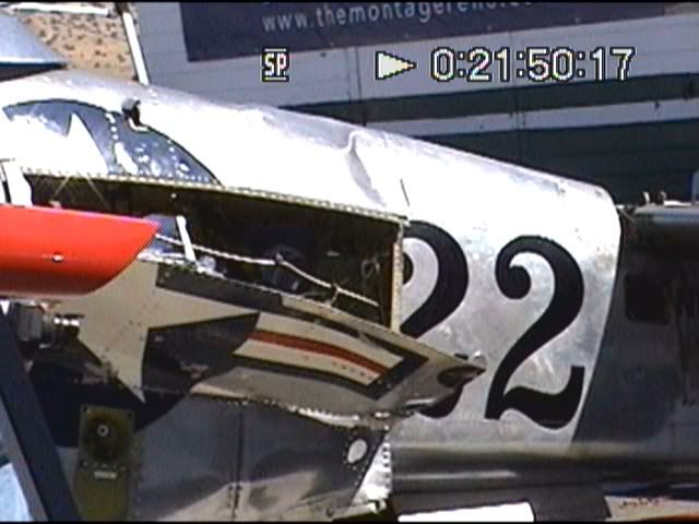

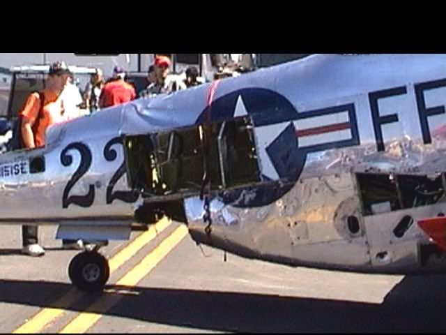

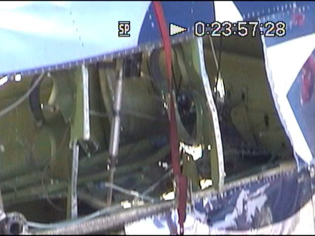

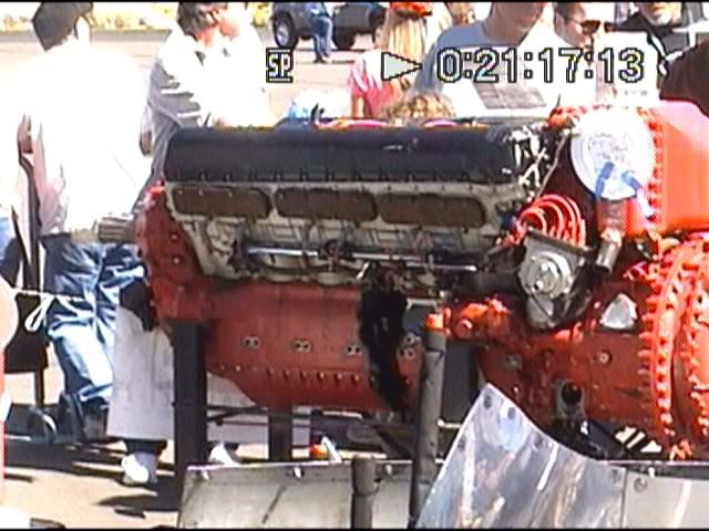

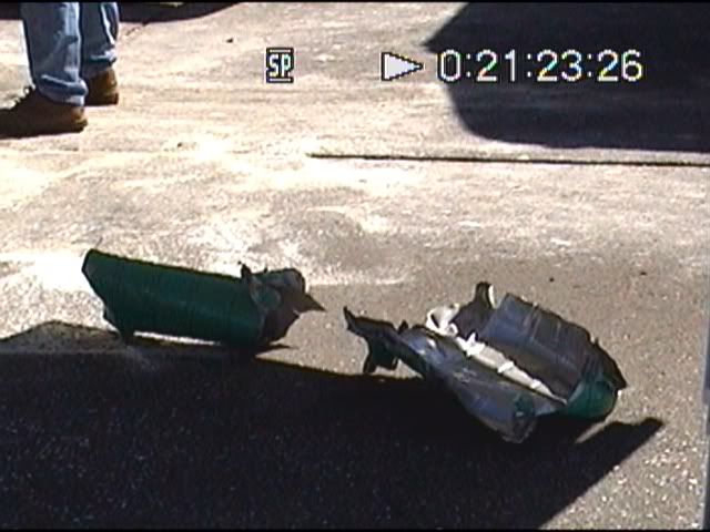

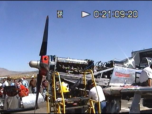

 Post subject: Merlins Magic Mess
PostPosted: Wed Sep 20, 2006 5:33 am
Posts: 926
heres the pics I promised.Always remember,"high pressure oxygen in a low pressure system is bad!"
