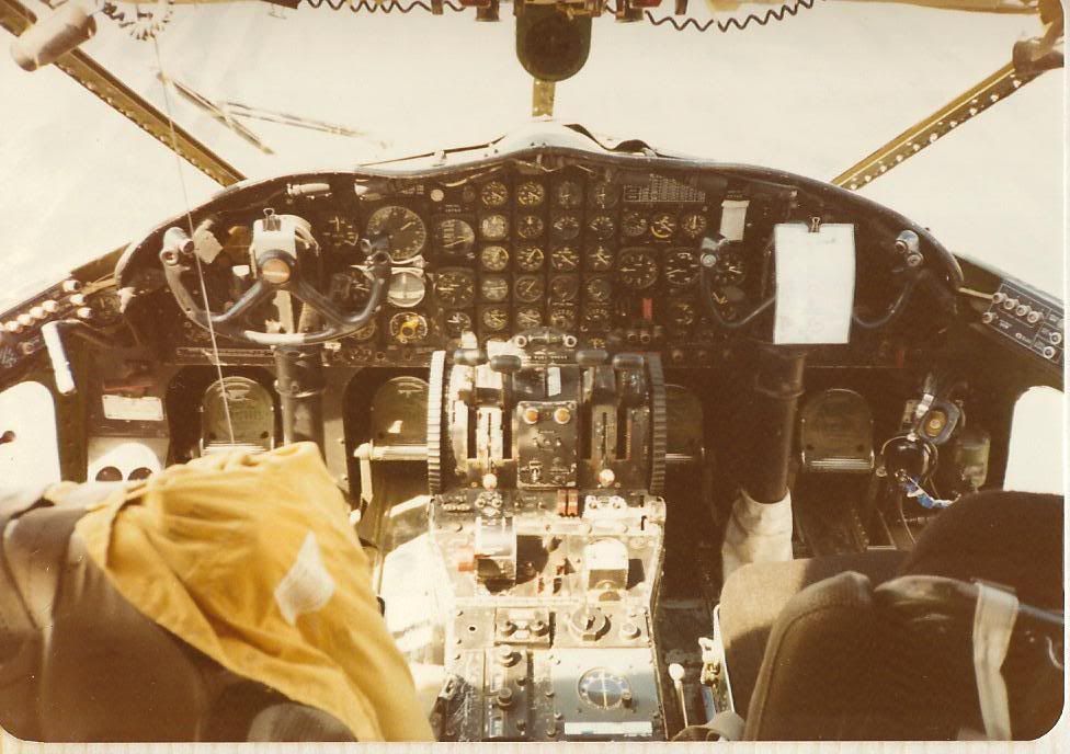

Scott,here are a few more pictures.The exterior shots are of Tanker 82 at Fresno in 1980.I honestly don't remember which Box the interior shots are from,but most likely from Tanker 81,,82 or 87.

bdk,The Boxcars that I flew in had the J-34 Jetpack.That made life easier.Also,the tankers could get rid of over 18,000 lbs in a couple of seconds,if really necessary.That said,Aero Union started out with C-119's without the jet and they were pretty dodgy.The first flight that I went on as a passenger in a Box was out of Anchorage,fully loaded.We B-17 tanker types always used to claim that the only advantage to the jet on the Box was that it made an excellent fuel dump,which was the reason that they were able to climb better with it lit.On that flight out of Anchorage,it was a good thing that I was strapped in when the pilot throttled the jet back to idle because it was like hitting a brick wall without the extra thrust.And that was with the recips at METO power.
At least one of the C-119 tanker structural failures was caused by the failure of an aileron bellcrank due to a casting flaw during manufacture.When the bellcrank failed,the aileron began to flutter,which cause the loss of the aileron and structural failure of the wing.This resulted in the C-119 airtanker fleet being grounded until AD 81-18-06 could be complied with.This called for a detailed inspection of the aileron control mechanism.For some reason,the C-119's flying on the Fish Haul were not affected.
The Aeroproducts props did tend to leak somewhat and they had a reatively small reservoir of lightweight oil.If enough oil was lost,the pilot had no control over the prop.I don't know of any tankers being lost because of this.One of the Boxcars that I flew in as c/p in Alaska was a C119L that had three bladed Ham-Standard props in place of the four bladed Aeroproducts props.These still had a similar prop oil reservoir,but they included a system allowing the reservoir to be replenished with engine oil in flight in an emergency.I never could understand how those three bladed props could absorb the same amount of power as the four paddle blades on the Aeroproducts props.
