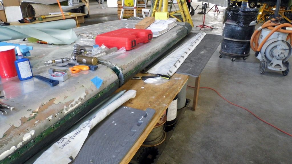

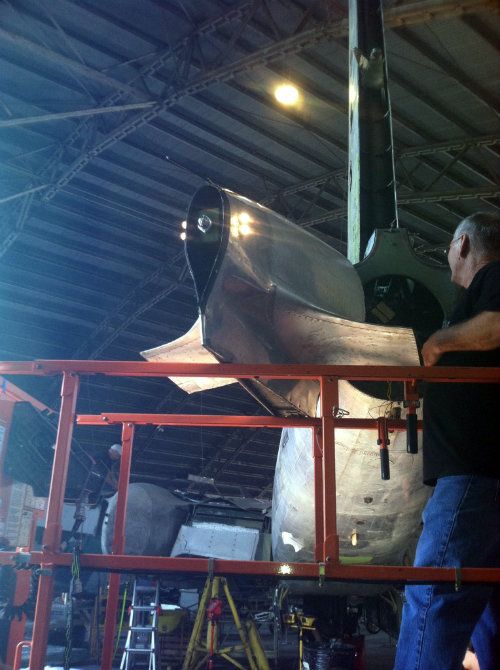

Well, gosh, it has been a long week. Spent most of it across the Red River in the I.T., but made it back to the Republic just in time for the A26 work today. Had a good turnout of volunteers and we got a lot accomplished. The guys got the tailcone lights all going. Now all we need to do is make the top little white side lights amber on each side. The white tail light also works, but not shown in the picture. Took some troubleshooting, but they got it going. Felipe, David and Miquel finished up the spar repair on the left horizontal. Good as new now, so that is a major milestone. Both stabilizers are just about ready for riveting the leading edges back on. Another team got both oil cooler door actuators running now so that is another major thing off our STD list. Waiting on new thermostats to make the auto feature work on these actuators. Work good in manual, but we would like to have them working in auto as well... not that we will trust them, but still it would be good to have auto to make it like the original. We obtained the miitary style quilted fabric to replace the sun bleached and ragged material in the cockpit. Another team cut that out using the originals as templates and will send that out to a local upholstery shop where they will get it out finished out and hemmed right. Can't wait to see it when that is all done. If you are out in the neighborhood of Meacham Field in Ft Worth, drop in and see us. Today was Kid Camp Day and we saw about a million of them with their parents. OK, maybe it was more like 50 or 80, but it seemed like a million!! A group of local pilots took them for rides in their airplanes. Nice to see those big smiles when they came back!! :-) JR

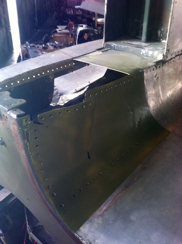

Mark has been working out some of the sheet metal repairs in the area of the tail cone below the rudder. This should be ready to start shooting rivets next weekend. We are waiting on one part that had to be fabricated for the vertical tail and the fabric to be installed in the rudder gap seal and then we can hang the rudder. When that is all rigged, we can hang the horizontals. We are starting to work on the smaller details like new seals around where the horizontals mount to the empennage to keep water out. The old ones are in very bad condition and probably are responsible for the problems we had there. JR

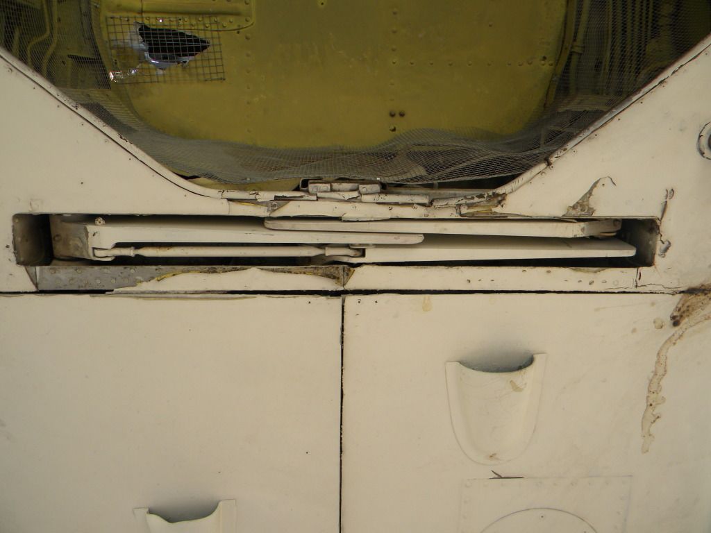

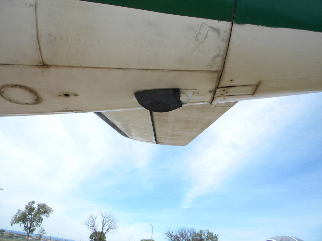

Randy also sent this pic of the spoilers that are extended when the bomb bay doors open in order to disturb the airflow and allow the bombs to come out of the bay at high speeds. We have discussed these in earlier posts, but we wanted some other closeups to see some of the details. This is just one of the group he sent. Thanks again Randy. Cheers, JR
PostPosted: Mon Jun 11, 2012 9:03 pm
Posts: 2563

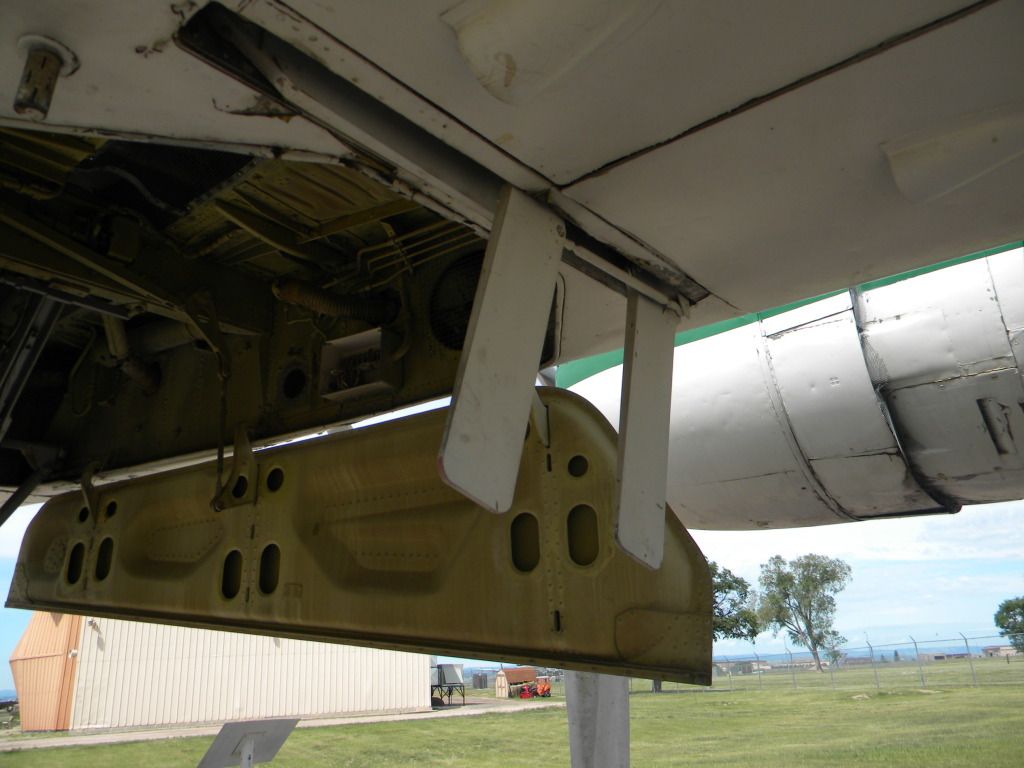

Another shot of #640 at Ellsworth AFB, SD, sent by our Roving Reporter Randy which shows the bomb bay spoilers from the bottom side. The bomb bay doors are closed so the opening in front is for the nose gear. Randy is making his way back to Va. and we hope to have more reports from him when he gets back. What a great trip he has had from Va. to TX and then on thru NM, CO, WY, SD, NE ... sorta a great circle route to see all of the aviation/space things one might find along the way.. including the other mammal that flies blind... some bats at Carlsbad Cavern. :-) Way to go, Randy!! JR

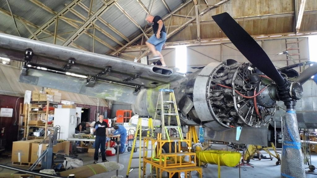

The real JR went back and forth today helping to hang the replacement engine on the DC3 and working on the rudder gap seal. It is one of the things we need ready when the piece we had to get made comes back for the vertical stab. Then we can hang the rudder and get started on the horizontals. The tail cone is about ready as is the sheet metal repairs to the side and top of the tail below the rudder posted earlier. So about half of our team had to work on the 3 while the rest banged on the 26. We took time out for Hawkeye to grill some great burgers and chow down. Some progress was made on both airplanes today!! It's good to see things going back together. The other JR

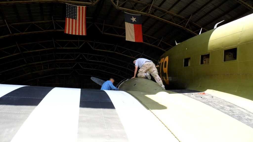

Joe and David were among the bunch who worked on the replacement engine for the DC3 and put a new elevator on the left side. I just like the flags flying in the top of the hangar. Isn't the flag of the Lone Star Republic pretty? Now for you sharp eyed folks, which way is the flag facing? To the left or the right? Notice anything about the US Flag? JR
