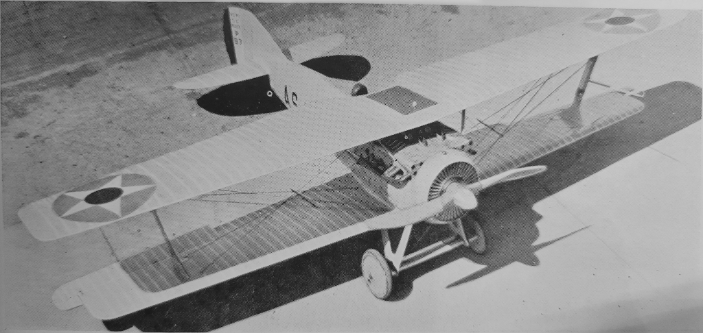

In a direct follow-on to the post above, the Verville VCP-1, A.S. 40216, appears to feature a similar cooling fan design:
(Source: Bruce Robertson, ed., United States Army and Air Force Fighters, 1916-1961 (Fallbrook, California: Aero Publishers, 1961), 21.)
(Source: San Diego Air & Space Museum via Flickr)

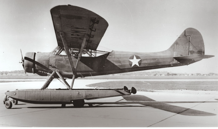

"Wheeled Floats
The first aircraft with wheeled floats, at least in the modern sense, may have been the C-47C.!!"
I'm pretty certain the C-47C was not the first aircraft with modern-day amphibious floats.
If nothing else, here is a shot of an L-1 on EDO 49-4000 amphibs. There were 12 O-1 floatplane conversions.
Given the fact the C-47C did not fly until July, 1942, I'd wager the L-1 installation beat it.
The C-47 floats were built by Edo, I'd bet they had built some before, if for nothing else than proof of concept.
In his book "The DC-3: 50 Years of Legendary Flight", Peter M. Bowers writes, "...Edo had built smaller amphibious floats before and during the war, with retractable nosewheels and main wheels behind the step, but the model 28 was by far the biggest...then or since".
But perhaps it took visions of a large government contract for them to do more work on the concept. The Army ordered 150 sets of C-47 floats, I have never learned how many were actually built or installed. Bowers mentions just two ID'd by serials. I'd bet a lot of brand new floats were scrapped.
I'm sure there is a float historian out there that could tell us more.
bdk wrote:
MIL-F-5508A from 23 March 1950, "Fuses, Aircraft Automatic Quantity- Measuring, Hydraulic" certainly predates the L-1011 by a long time.
Thanks guys! This is why I'm grateful for the responses. I knew there was a good chance my answers weren't right, but I also knew that if they weren't someone with more knowledge would respond with the correct (or a closer) one. I will readily admit to not doing as much in-depth research on those two firsts as some of the other ones.
In regards to JohnB's response: ̶D̶o̶ ̶y̶o̶u̶ ̶(̶o̶r̶ ̶a̶n̶y̶o̶n̶e̶ ̶e̶l̶s̶e̶)̶ ̶k̶n̶o̶w̶ ̶w̶h̶e̶r̶e̶ ̶I̶ ̶c̶o̶u̶l̶d̶ ̶f̶i̶n̶d̶ ̶a̶ ̶c̶o̶m̶p̶l̶e̶t̶e̶ ̶l̶i̶s̶t̶ ̶o̶f̶ ̶E̶d̶o̶ ̶f̶l̶o̶a̶t̶s̶ ̶c̶o̶m̶p̶l̶e̶t̶e̶ ̶w̶i̶t̶h̶ ̶p̶a̶r̶t̶ ̶n̶u̶m̶b̶e̶r̶s̶?̶ ̶I̶ ̶k̶n̶o̶w̶ ̶t̶h̶a̶t̶ ̶E̶d̶o̶ ̶f̶l̶o̶a̶t̶s̶ ̶a̶r̶e̶ ̶v̶e̶r̶y̶ ̶p̶r̶o̶l̶i̶f̶i̶c̶,̶ ̶b̶u̶t̶ ̶d̶e̶t̶a̶i̶l̶s̶ ̶o̶n̶ ̶t̶h̶e̶m̶ ̶-̶ ̶o̶r̶ ̶a̶n̶y̶t̶h̶i̶n̶g̶ ̶a̶b̶o̶u̶t̶ ̶t̶h̶e̶ ̶c̶o̶m̶p̶a̶n̶y̶ ̶-̶ ̶a̶r̶e̶ ̶s̶p̶a̶r̶s̶e̶.̶ ̶U̶n̶f̶o̶r̶t̶u̶n̶a̶t̶e̶l̶y̶,̶ ̶i̶t̶ ̶i̶s̶ ̶m̶y̶ ̶u̶n̶d̶e̶r̶s̶t̶a̶n̶d̶i̶n̶g̶ ̶t̶h̶a̶t̶ ̶E̶d̶o̶'̶s̶ ̶a̶r̶c̶h̶i̶v̶e̶s̶ ̶w̶e̶r̶e̶ ̶d̶e̶s̶t̶r̶o̶y̶e̶d̶.̶ Actually, it looks like Kenmore Air has a relatively comprehensive model list. Apparently, they were the distributor for Edo in the northwest and acquired the rights to the brand in the 1980s.[1]
In regards to bdk's response: Now we just need to figure out if the suggestion in the 1945 paper was ever tested on an aircraft. At least we now have pushed the absolute latest date and aircraft back further: 1950 and Martin 202.
