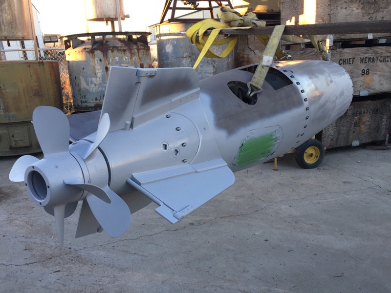

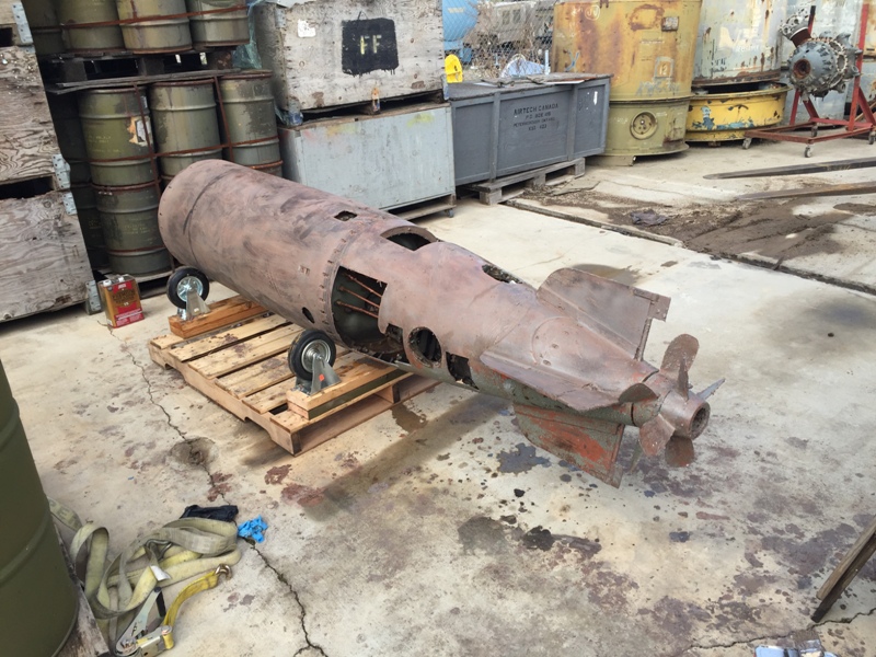

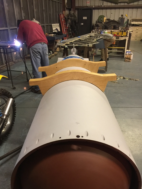

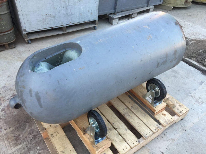

The next project involved more work on our cool Mk 13 torpedo. We did a lot of conservation work to stop any further rust and corrosion. We cleaned and prepped the torpedo and painted it. We even had a Warbird museum meeting that featured the Mk 13. I put together a presentation on its development, systems and operation complete with a demonstration of the motor all powered up for the crowd. It was a lot of fun and the thopedo looked great.
Here are some progress photos:

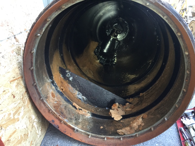

This is the inside of the warhead which was also in good shape. We are lucky to have an actual warhead instead of a training head although I'd like one of those too!

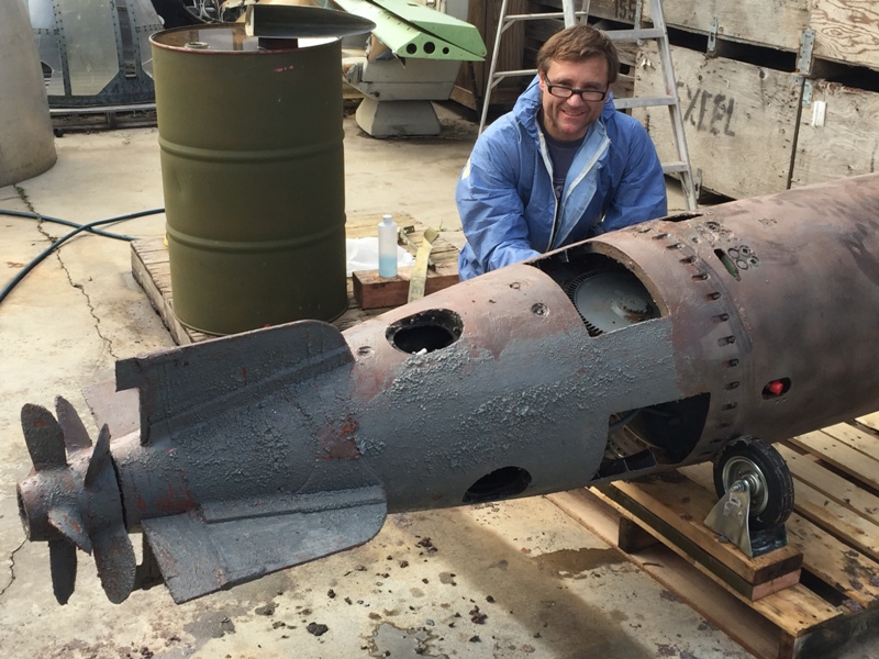

Here is Tim stripping the paint
The well for the exploder mechanism. Anyone happen to know where we can find a Mark 8 contact exploder?

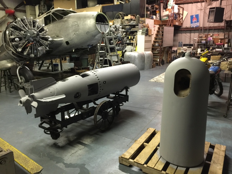

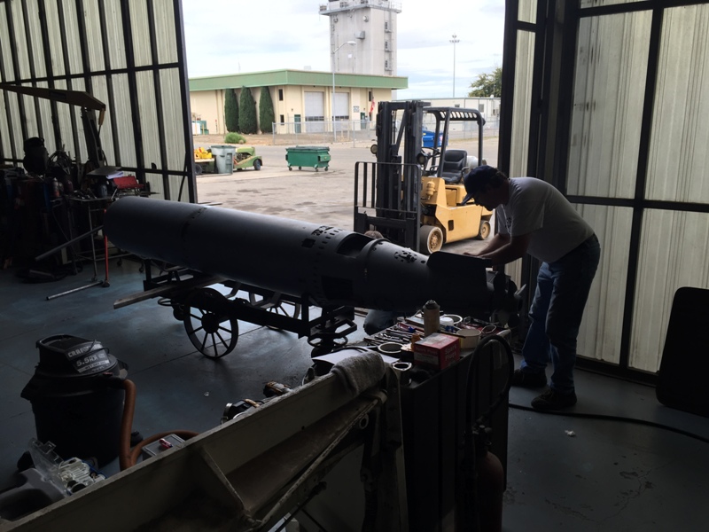

Paint going on. We are just preserving it with primer at this point. It looks like the original finish was bare metal on the air flask and afterbody. Still trying toi find detailed finish specs

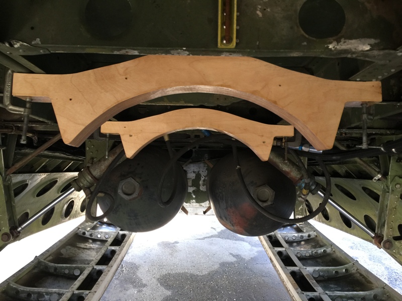

Making and fitting the saddles for the torpedo to fit in the bomb bay of the Harpoon.

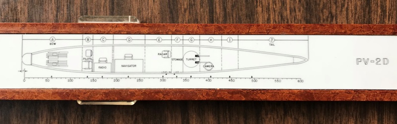

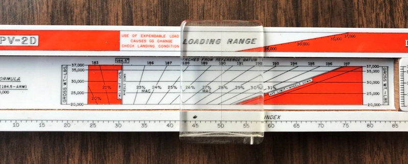

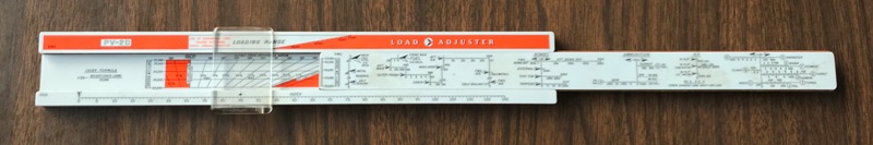

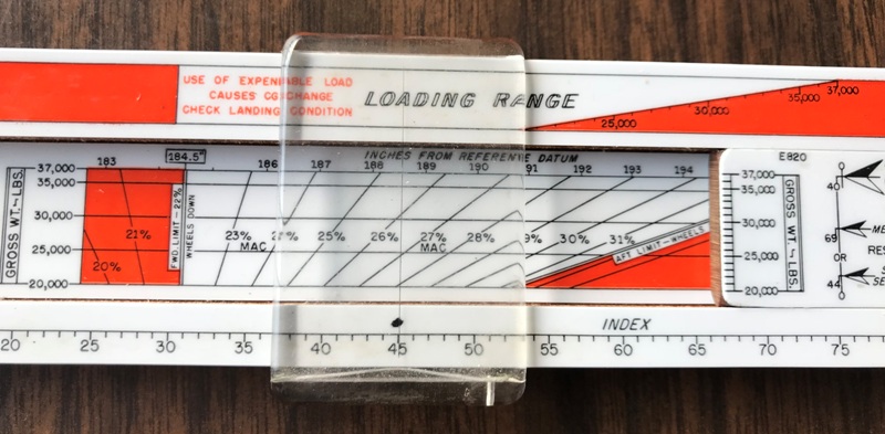

And what do eight .50's do for your weight and balance? Do you currently fly with ballast up there? What will the completed gun bay installation weigh?
45-47=-2
PostPosted: Thu Nov 30, 2017 2:27 pm
Posts: 1487
Hello Mike,

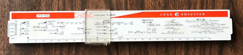

With 8 steel replica 50's, ammo boxes. feed chutes, hardware etc. I'm estimating that it will add about 520 pounds and moves our CG forward three inches which is a good thing. We were relatively aft CG at 195.54 and a BEW of 18,751 pounds. The addition of guns brings us to 19,271 pounds with a CG of 192.15. The CG range is 184.5 to 197.9 so we are good. Even with full fuel we are still good on CG and are under 26,000 pounds takeoff weight. Mag gross weight is 33,000.
Here is the weight and balance according to the load adjuster:
The new index is 45 so we are good for the basic empty weight CG
Loaded with full air show fuel and oil (like we could afford to top her off!)
Armor plate up front and the APS-3 radar antenna in the nose will also help.

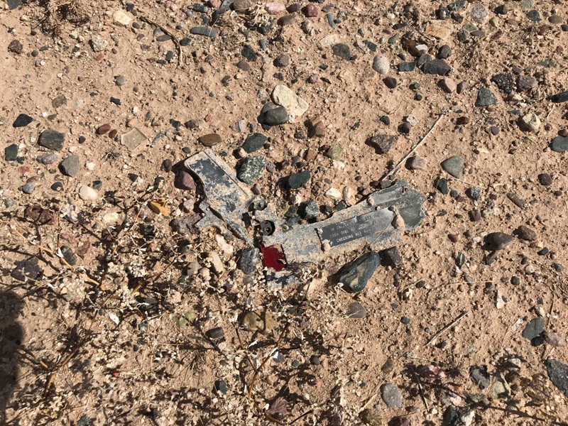

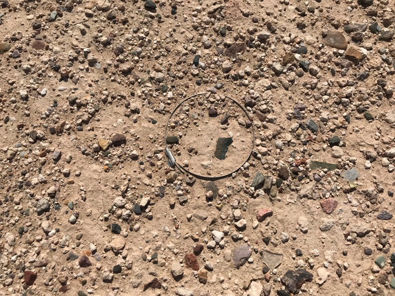

Here is a closer shot showing the row of PV-2's. I walked to the area that I thought was close and took some photos. Not quite the right perspective but I think I found the correct mountain range.
Looking around I could see bits and pieces of the tie downs and some aircraft parts too.

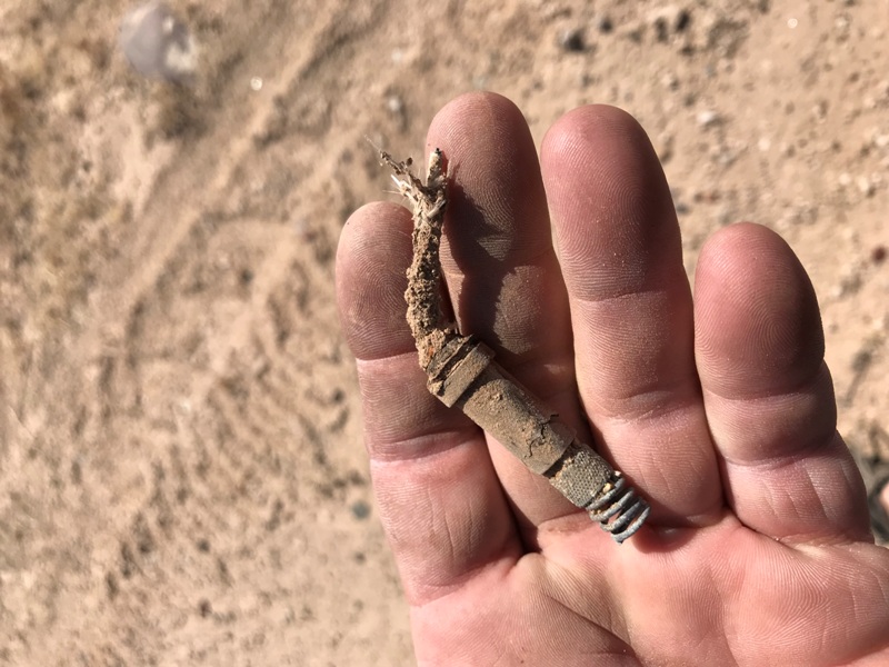

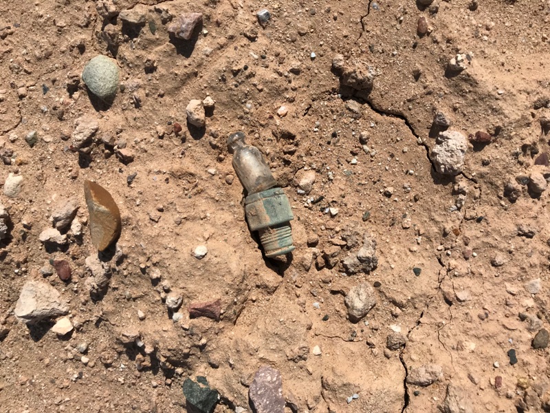

Here is a magneto or induction vibrator lead

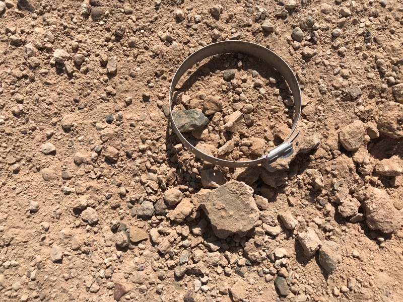

A stainless steel hose clamp that I will clean up and put on the harpoon so it can fly again
A desiccant plug that was used to keep moisture out of engines that are preserved.

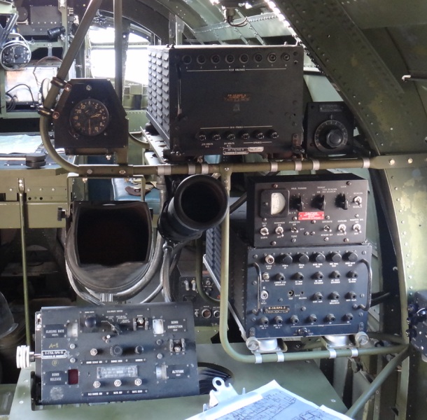

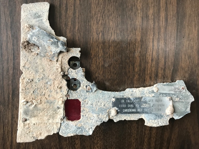

None of the above could be directly tied to the PV-2 but this next one was. I was giddy to find it.

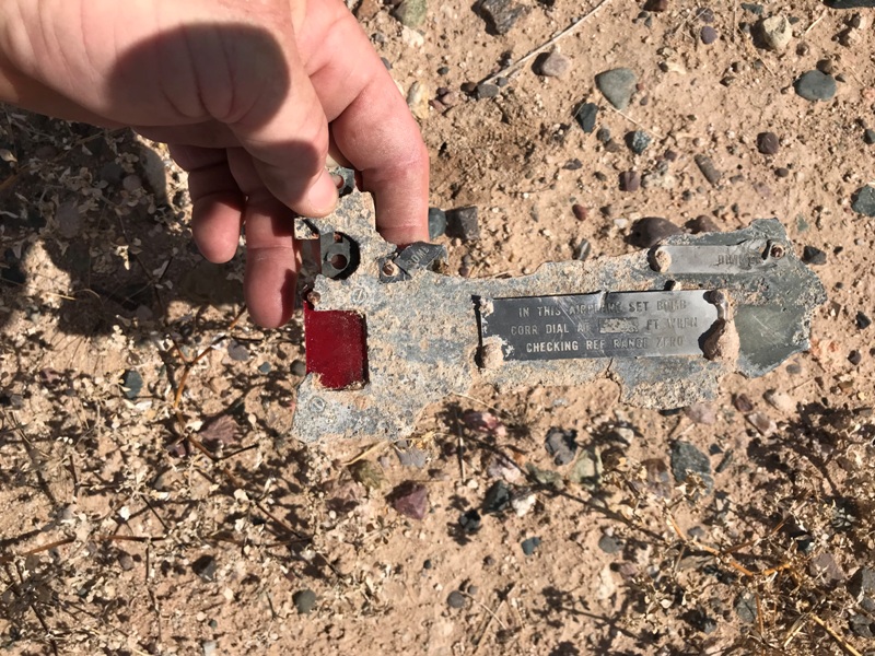

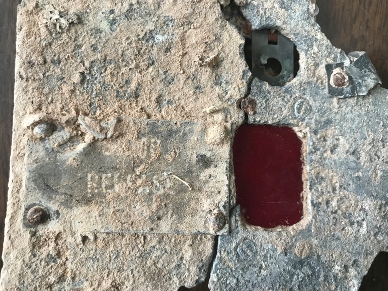

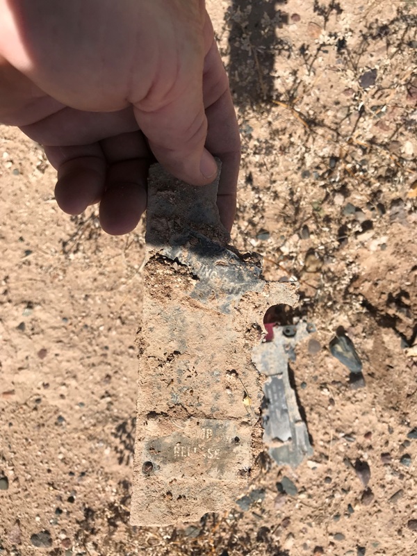

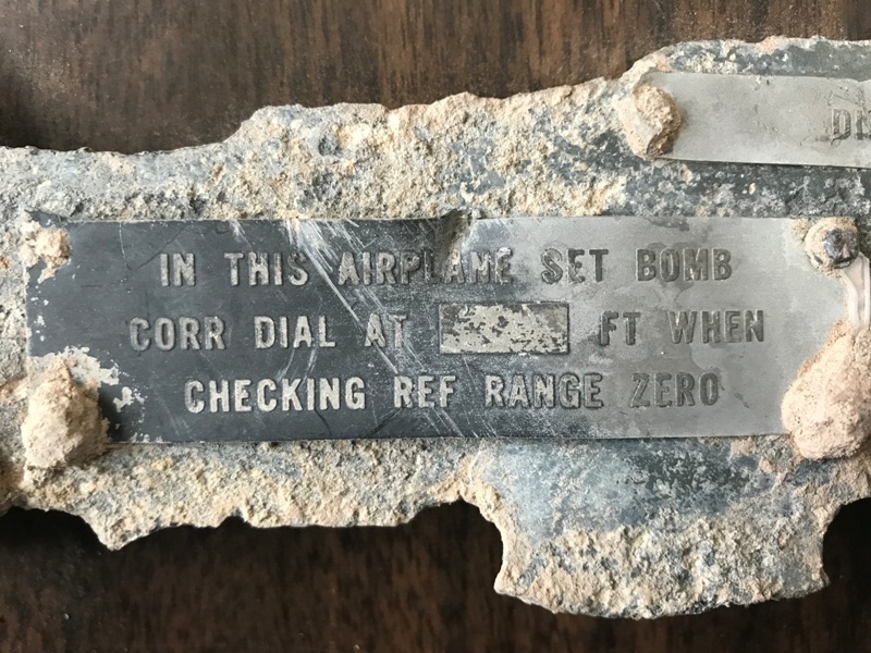

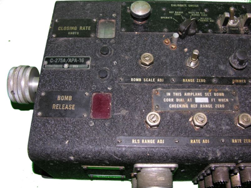

This is a part of the control box for the APA-16 set. This was used to input the bomb type, speed and altitude information for dropping bombs through the APS-3 radar.
This is from the control box at the radar station on the lower left in the photo
This set was used in other aircraft as well but since it was in the area where the Harpoons were stored, I am going with it's from a HARPOOOON!
