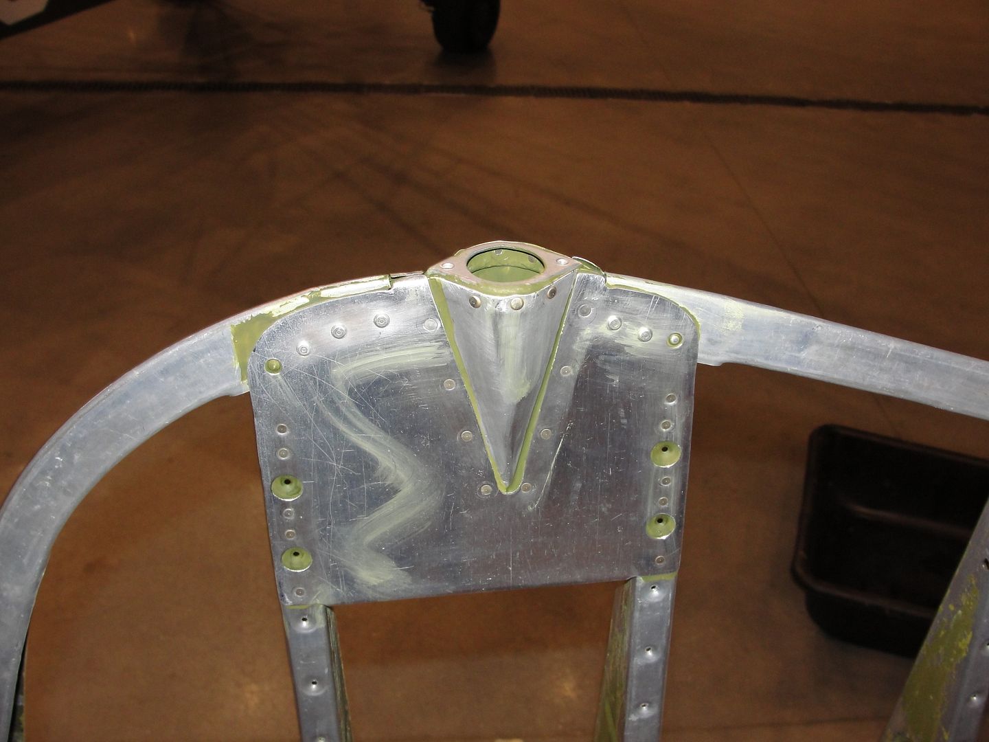

I have been working on getting the flight controls from SNJ-3 #22 ready for covering. One thing that had never been done was to install the tail nav light on the rudder trailing edge. It had a football type wingtip housing attached to the top of the rudder.
Directions from the North American Aviation instructions to change the SNJ/T-6 to civil use are dated Oct 1945 and only go up to SNJ-4, T-6C. It mentions in it that Flight Tests had yet to be done on later Aileron Control system as installed on the later models, SNJ-5/ T-6D and later. This would refer to the High Roll Aileron system.
Diagram and instructions to install the tail Nav light on the rudder trailing edge.

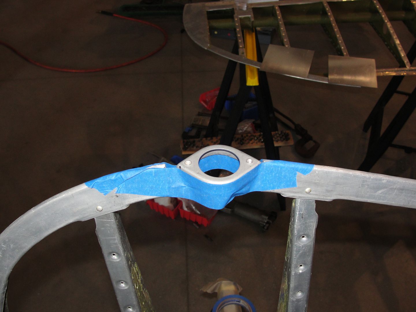

Some of the work to do this-
The light mount came from Lance and is a Grimes product-
The fairing I have cheated on and they are from a Money M-20 series stinger.

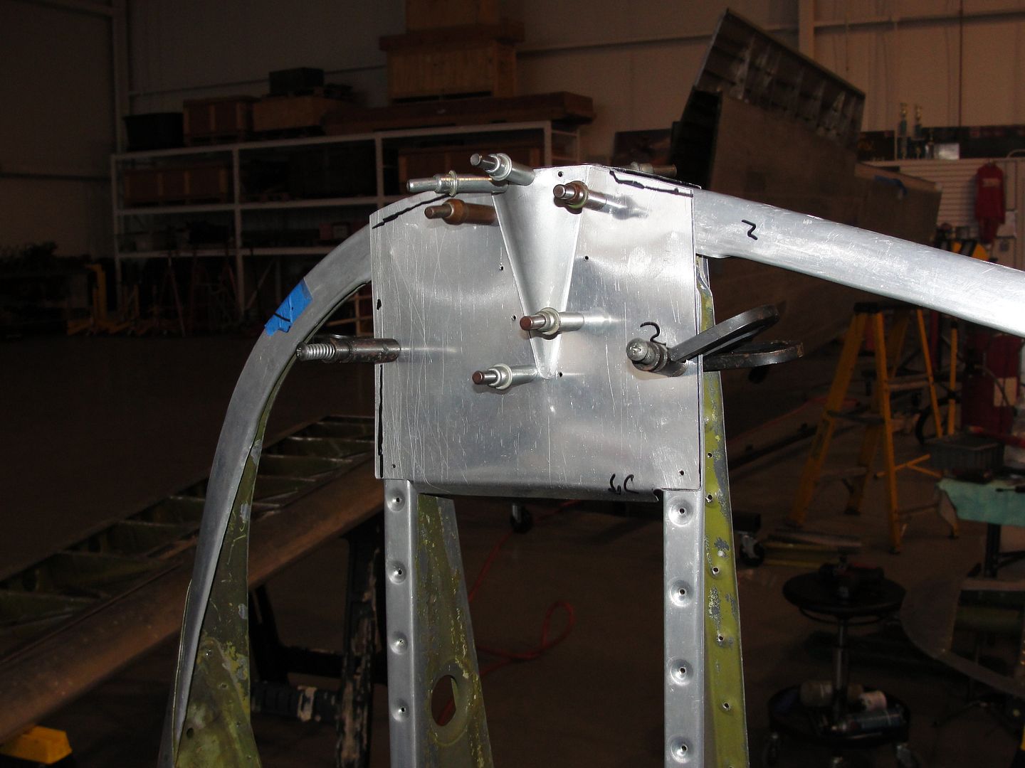

Tail Light Progress-

I'm doing some work on the P-51 but thought I would update the rudder-
