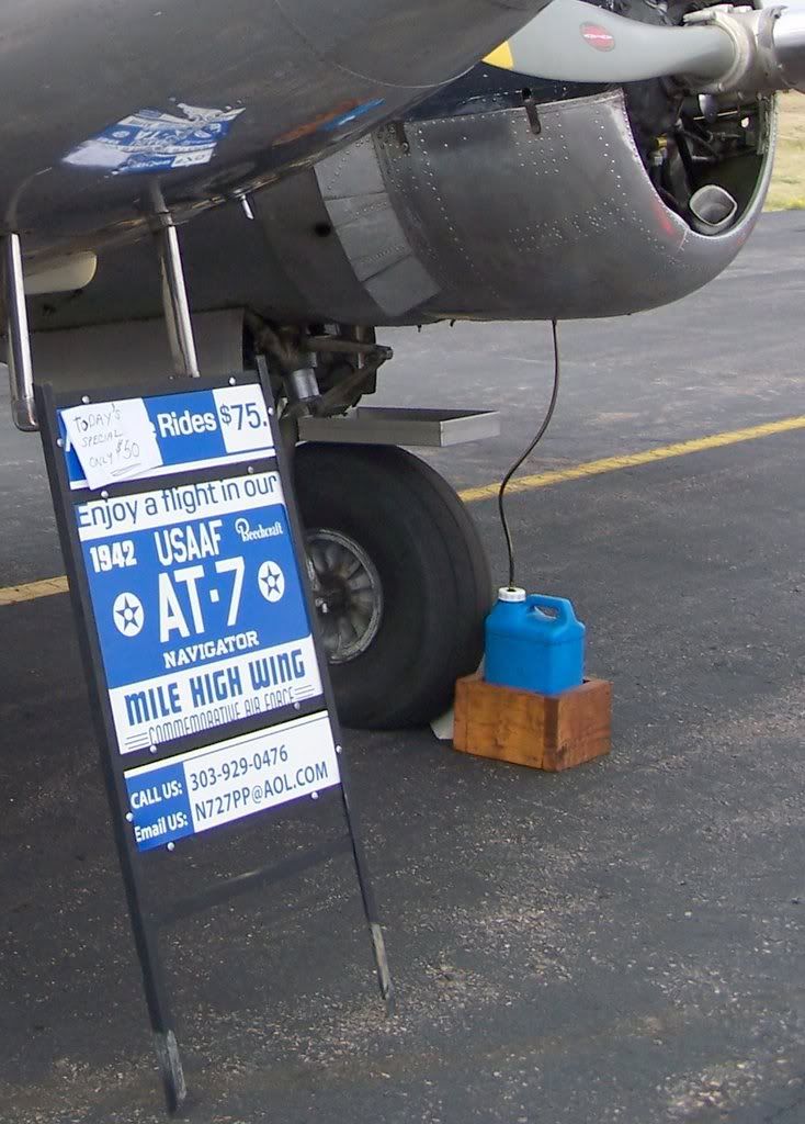

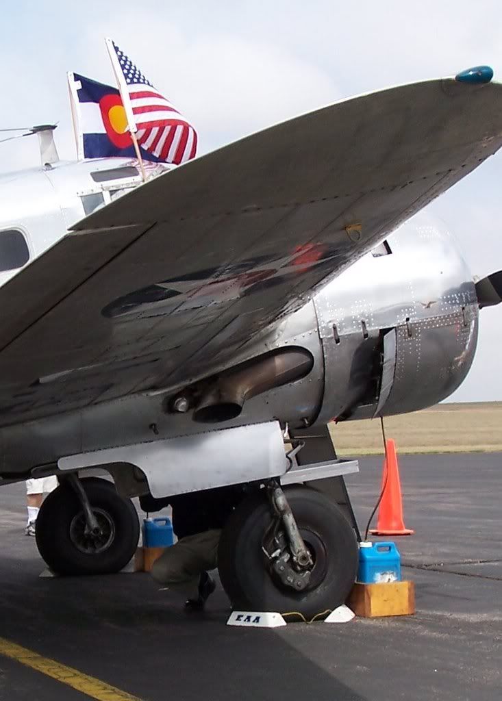

Sorry guys.
Is this a annual process? Or is the valve opened up to the collection vessel after each flight? Is that what these blue containers are for?
Would the oil leak be that visible on a walk-around prior to flight?

BD - the valve is opened after every flight to ensure that all oil from the lower cylinder is drained to prevent a hydraulic lock in the engine. The blue containers are for collecting the oil drained from the valve to prevent the oil from making a mess on the ground. Once the valve is closed, the hose is removed and the oil can be re-added to the oil tank if desired. An oil leak should be visible after the hose is removed, but I'm not sure that there would be much oil until after the engines were started. The report doesn't say if there was anyone present for the engine start or not, so it is possible that no one saw the oil draining out after engine start or the puddle that resulted since the report seems to indicate that the mechanic on the aircraft was either in the hangar or not at the airport at the time of the aircraft's departure.
