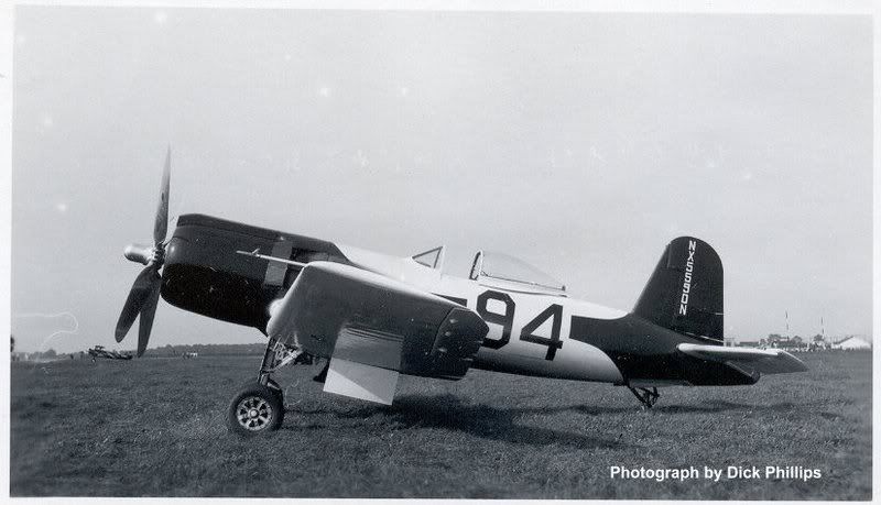

The current airscoop extension on #57 is the same type that was used on #94 and #74 (after 1947), which is with #74 today.
The "origional" airscoop extension on #57 had the hump to try to ease the downward turn of the air into the carburator. It all but elimited forward visibility on the ground. The origional (humped) was drawned by J. Zeamer and approved by "EHG" of Pratt & Whitney. The drawings are undated and are on Pratt & Whitney titleblocked paper. The scoop entrance area is 85 square inches. The area increases up to the turning section. The turning section has -2- internal vanes, dividing the airflow into -3- cross-sections to turn. The origional elbow was made of .040 Stainless Steel, while the cover was made of .064 (or .069) 35 1/2 H Aluminum.
Cook said that they tried the white blade on a standard Corsair (in Korea) but it didn't have any effect.
Kenn

PostPosted: Tue Jul 22, 2008 10:45 am
Posts: 1521
NX5590N
Last edited by Swiss Mustangs on Tue Jul 22, 2008 11:03 am, edited 1 time in total.

PostPosted: Tue Jul 22, 2008 2:00 pm
Was #94 in the Warbird Digest article? I don't remember seeing that one before.
