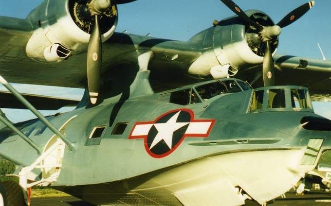

Don't want to disagree, but insn't that just a faired over nose? The turret ring and bomb window are there on that Canso picture. It is a lovely shot however. I think the Clipper bow is a whole new built up nose that retains almost none of the original nose structure. That nose still has the "snub" nose characterized by the bomb aimer window....
Note on the clipper bow, it extends well above and forward of the end of the planing hull, while the snub nose is defined by the bomb window. Clipper bows generally have "bumpers" on them...

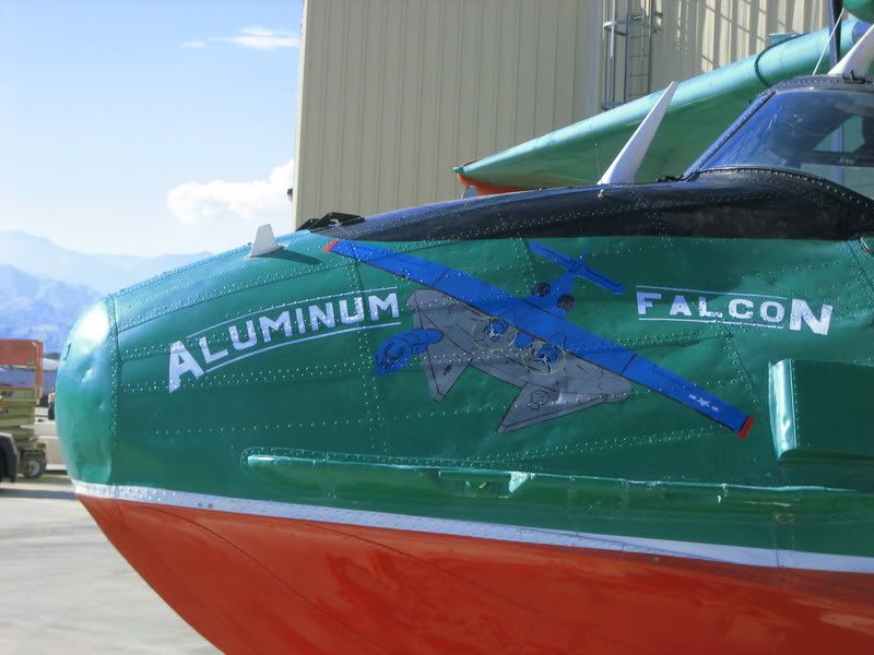

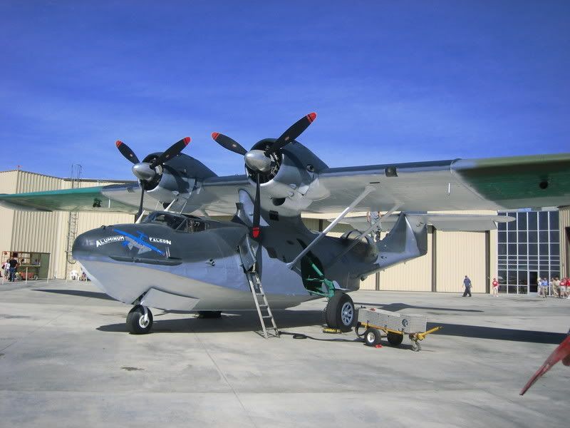

To begin a short study, lets look at the French PBY, clearly sporting a Clipper bow, and the characteristic rounded shape of the conversion.

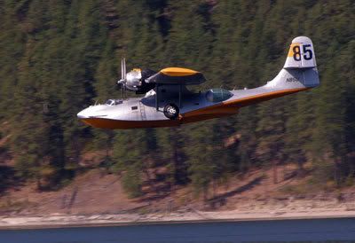

Contrast this with a "Fake" clipper nose, the stalwart Tanker 85 of Washington State, USA. This one has a nose that is fiberglass, a Hemet Valley thing, and distinctive in shape. Its smooth and featureless when inspected close, but has turret formers and ring underneath. This is aerodynamic only. Tow views...
]Image
The Standard Clipper Profile of these noses is fairly uniform when you look across the board, and they all must have been built to a common specification. Only the afterthough turret patch overs have the variations seen, from the extreme of N2886D to the more standard "snub" nose seen on the Canso in the picture on the first page of the thread..
N322FA a standard "Clipper Bow" and identical seemingly to the next couple planes...
N4760C
Note the slightly different countour of the Plane Sailing aircraft...
see here the complete reforming and reskinning of the upper nose, defined by the different color aluminum...
Close up...
And finally another snub turret nose, and note where the walk shelf terminates, very close to the tip of the nose, where the clipper bow extends both forward and above the original lines of the plane...
