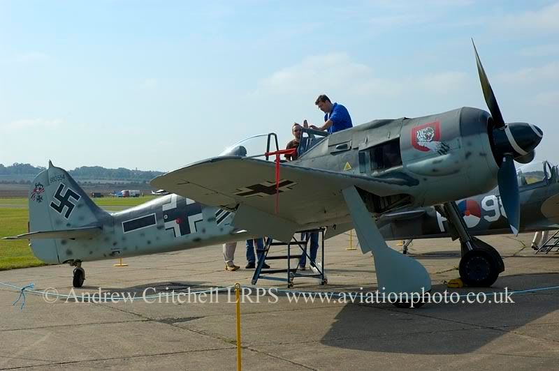

I'm not sure if the FW (Flug Werk) 190 in the video is the Tri-state bird I do know that the video was the first flight. They were offering the 190 as a "kit" I believe this lowered the cost plus put the airplane in a different category for certification. The LBA must have different requirements for flight certifications before an aircraft can be delivered, we had to fly 10hrs off to prove to the FAA that the 262 was airworthy. So if people are taking deliveries of the 190 I don't know if they are flown first disassembled then delivered then reassembled then flown? In our dealings with the LBA they were very thorough with the airplanes certification i.e. paperwork materials practices etc. Check out the picture flaps..check...assembled..check. This one was in England at the time of this picture IIRC and might be the Tri-state bird?

Posts: 2501
Location: New Zealand
That is the Blair aircraft. AFAIK FW machines are engine run, but not flown before being passed to the new owners.
