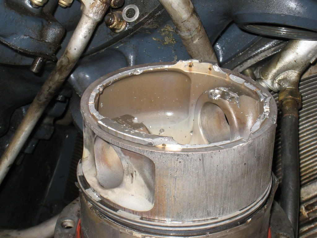

Heck, it was just a cylinder. And you know me, it's a long story. I don't want to bore anyone.
Gary

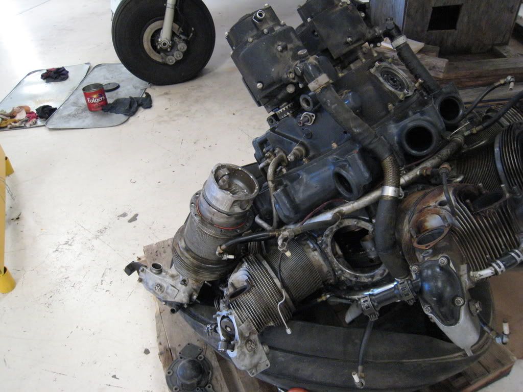

Here are a few shots of a R985 taken in March 2007 at the CAF hangar in AZ. I heard that the problem occurred on the ground.
Maybe someone closer to the CAF can fill in the details...:(
What is that knocking sound?
It reminds of a time when driving a 59 Karmann Ghia at 65 mph with a good Wyoming tail wind when a knocking sound ended with a bang!!! and then silence and rolling to a stop. :shock:

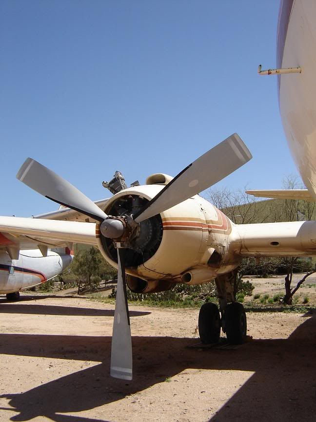

Here are a few shots of the Martin 404 Skyliner from the Pima Air & Space museum. From what I’ve heard this happened to them while ferrying the plane to the museum.
Jason Schillereff

Looks fake to me.........................and to answer the question.............Yes twice!
PostPosted: Thu Jan 01, 2009 4:50 am
Joined: Wed Mar 29, 2006 10:45 am
Posts: 442
Fake? Not with those shadows.
PostPosted: Thu Jan 01, 2009 8:26 am
Joined: Sun Jan 14, 2007 5:11 pm
Posts: 53
Location: ohio
Something looks fishy, I would think the prop would be feathered. Also it looks like the spark plug lead has been unscrewed and not broken . Regards Carl
