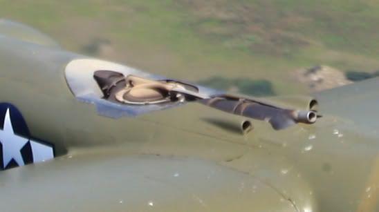

Found some pics from way back when.
This is the best I have for the turbo. It shows a bit of the top of things.

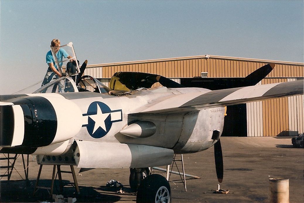

Somewhere I have hundreds of slides from doing this restoration.
Also there is a Motorbooks coffee table book on the restoration of this P-38 done by Jesse Alexander.
