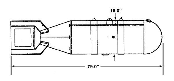

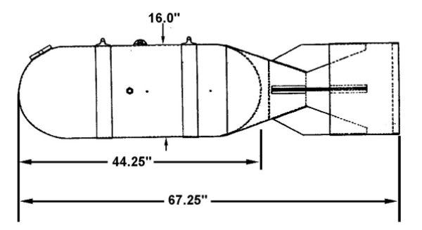

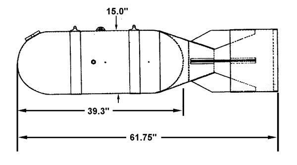

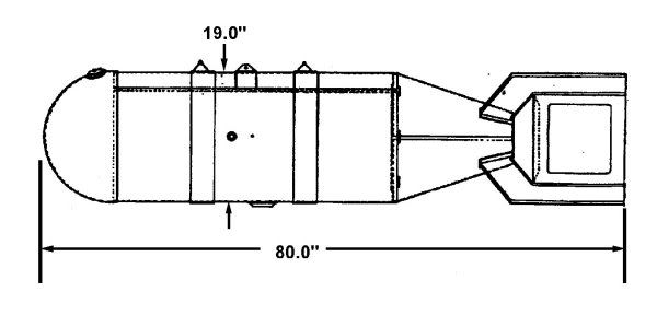

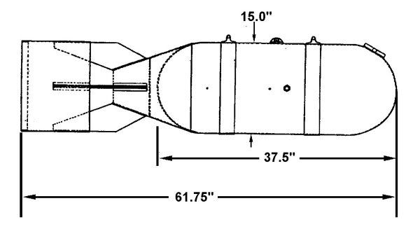

Ordata throws up three candidates:
U.S. BOMB, 500-LB, PRACTICE, MK 5
U.S. BOMB, 500-LB, PRACTICE, MK 11
U.S. BOMB, 500-LB, PRACTICE, MK 21
Hope that's got it. :lol:

RAMC181 wrote:
OK, Its practice bomb! We are very close, every thing looks exactly the same as the drawings except for the dimensions! The overall length is about 79.5" long, the girth is about 19" and the body minus the tail fins is about 48" long!
What about a 1000 lb. Practice Bomb, MK-?
Thanks!
John Lane, Jr.

Those dimensions are spot on for the two 1000lb practice bombs, but I'd ignored those earlier as the illustrations showed square not circular fins:
U.S. BOMB, 1,000-LB, PRACTICE, MK 7
U.S. BOMB, 1,000-LB, PRACTICE, MK 22
All the best,
PB
All the best,
PB
Paul,
BINGO!!
You the man, mystery solved!! :D
What I'm wondering is if the Navy had the ring fin and AAF used the box type?
John Lane, Jr.
