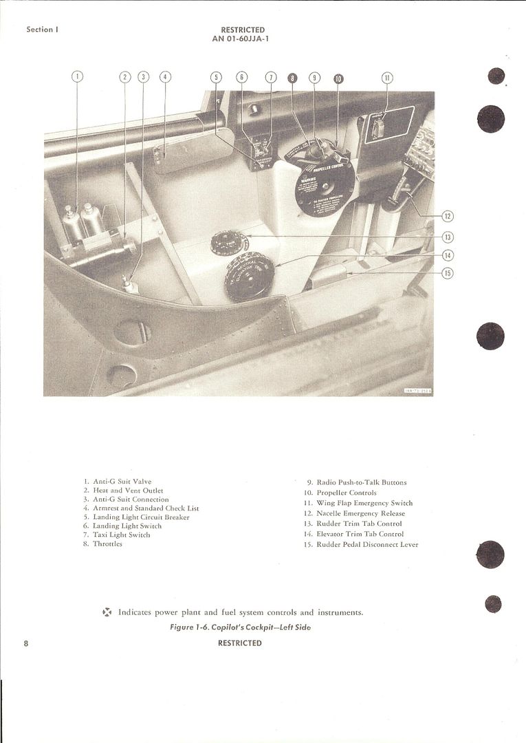

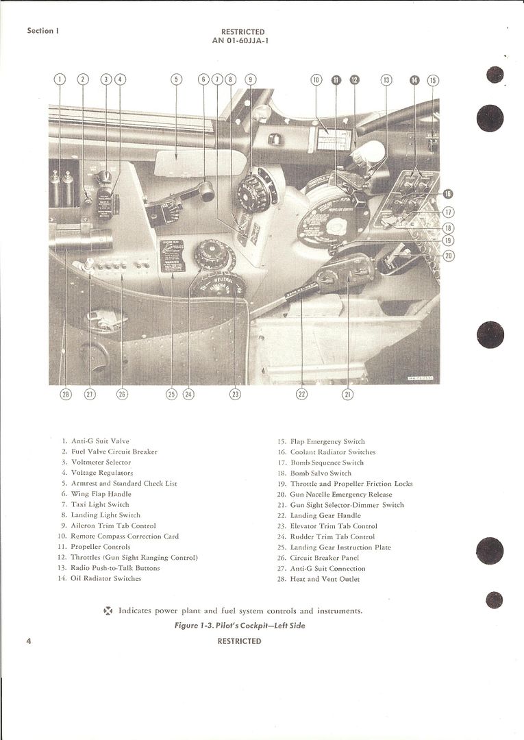

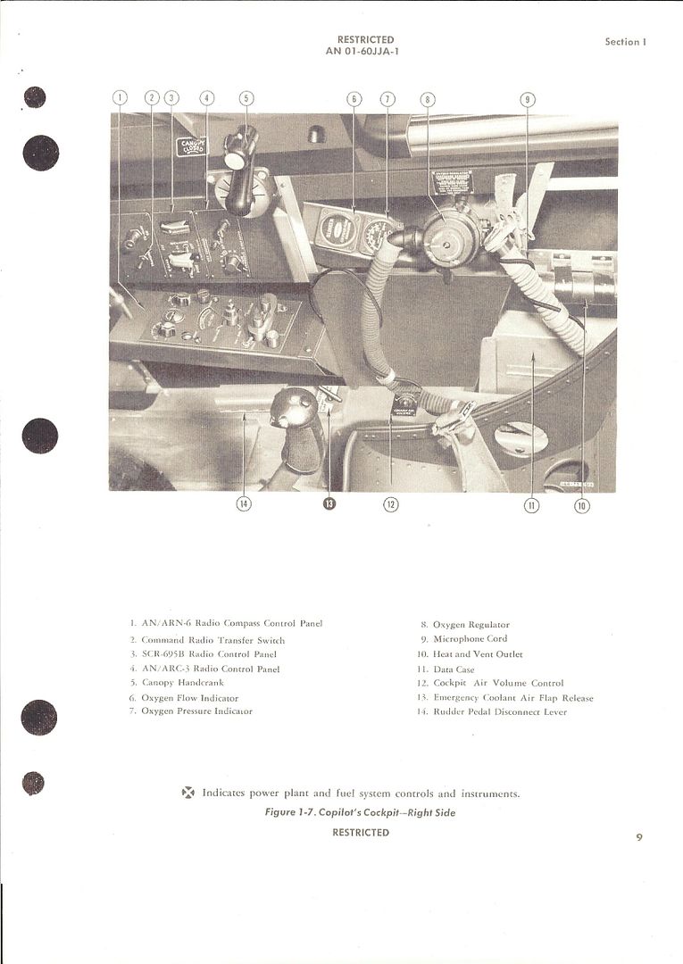

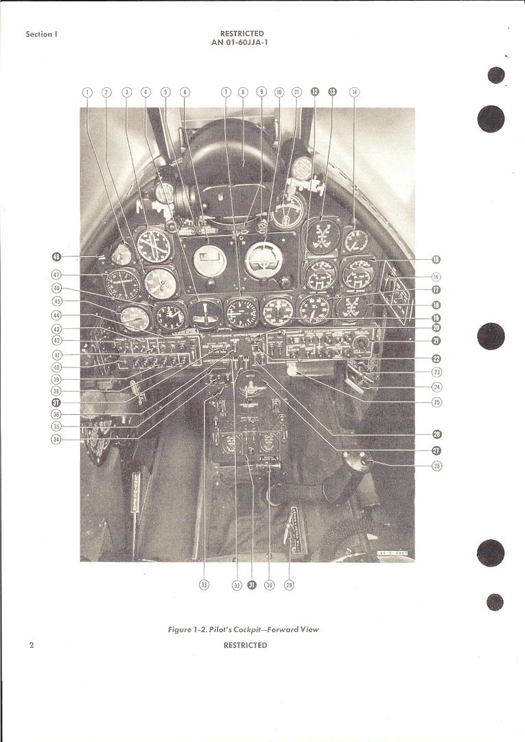

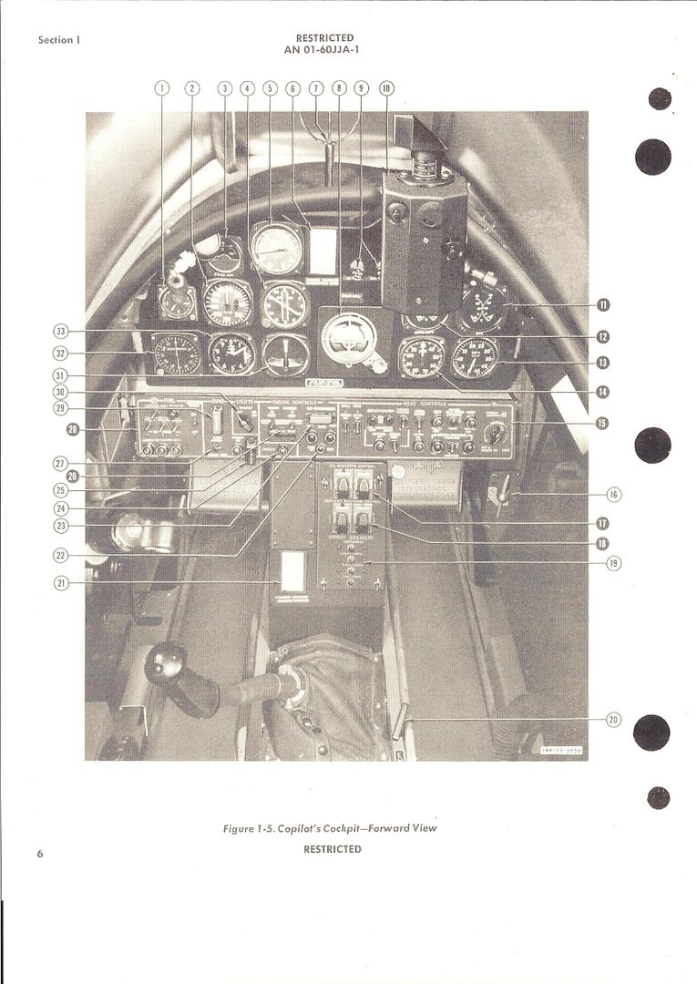

Normally,I'm not really supposed to post more than 10 pages from a manual,but the F-82 cockpit setup is so unique,that some additional pages are necessary for clarity.The solo cockpit is the left side.There are change over switches for some systems that have to be positioned in both cockpits to allow the pilot in the right cockpit to operate them.Several controls are only available to the pilot in the left cockpit.Incidentally,I'm not posting these pages in a larger format than normal on purpose.I've set everything the same as I always do and they post in this size.I'll admit that it does make the pictures and captions easier to make out.If anyone is interested in buying a copy of this manual,it's available on CD,along with a manual for the AJ-1 and a photocopy of a flight manual for the XA2J-1 for $19.95 from my friends at Flight Manuals on CD in New Zealand.It's listed under "NA-TWIN" for North American twin engine airplanes.Here's a link to their site:
http://www.flight-manuals-on-cd.com/
Here are the first 9 pages from the F-82E manual showing the cockpits:

An interesting item in that excerpt. It seems like the manual kind of contradicts itself. Direct quotes:
"However the co-pilot has no control over the following major items: landing gear and flaps (except emergency), ignition, water injection, surface control boost, or bombs (except salvo) and rockets. In the event of injury to the pilot, the co-pilot can, therefore assume control of the airplane and effect a landing."
Really, the co-pilot can "effect a landing" despite the fact that he can't lower the landing gear? I guess they should have said, "effect a gear-up landing". That's really odd the way they phrase that.
Despite having that excerpt, I still can't tell which cockpit is which in the earlier cockpit pictures from Brad that I posted. The clarity of the cockpit pictures from the manual is not the greatest, but it appears that both cockpits had a MPH airspeed indicator. From the other excerpt you posted earlier, it mentions the stall speeds in mph, so it makes sense that the cockpit ASI's would be calibrated that way as well. Of course, this all means nothing, since the CAF could have had virtually anything in the cockpit, just to make it fly.
Larry, any thoughts on this discussion or anything to add? Anyone else, for that matter?

If the manual gives speeds in mph and the photos appear to show the instrument in mph, then it is reasonable to assume that Lefty and Ed had the correct number (speed) to use, that is perhaps 120 mph, irregardless of the units. There's no reason to think they transformed it to knots and thus flew too slowly. Note that a P-51 has an ASI marked in mph and the manual gives mph speeds. No reason to think the P-82 is different. If the ASI caused Ed to fly to slowly, why did it occur only on this flight?
So I'd guess that cause was more due to the engine/prop problem.
As to the gear and flaps, the co pilot on the right side may have been able to lower it in an emergency, it seems to say.
For some reason on my computer, photos won't display fully. It shows only the top part,sometimes if it sits long enough, it will fill in, mostly not. My scan says I don't have virus or spyware,just some "cookies".

Both cockpits have the emergency L/G release at the lower right of the instrument panel. (legend #23 and #16 respectively)
Thanks Larrry for the additional manual pages. They answered a few questions, but created one more.
I don't see oil pressure guages for the propellers, am I missing something folks?

I'll try to clear up the emergency gear and flap question without posting additional pages from the manual.For the emergecy flap extension,the manual states:
Paragraph 1-82
"WING FLAP EMERGENCY SWITCH
A wing flap emergency switch is located on the left side of each cockpit forward of the throttle quadrant.(See figure 1-3,reference 15;figure 1-6,reference 11.) Movement of the switch to "ON" position diverts pressure from the aileron boost system to the down side of the wing flap actuating cylinders.The resultant momentary pressure drop in the aileron boost system has no appreciable effect on aileron control action.The flaps lower approximately 10 degrees per second and may be stopped at any position desired by turning the flap emergency switch "OFF".
WARNING
The flaps cannot be raised by operation of the flap emergency switch."
The following paragraph covers emergency landing gear release:
Paragraph 1-87
"EMERGENCY LANDING GEAR RELEASE
1-88. The emergency landing gear release handle (See figure 1-2,reference 23;figure 1-5,reference 16) is located at the right side of both cockpits below the instrument panel.Pulling the emergency release mechanically unlocks the gear and fairing doors,and actuates a hydraulic dump valve which allows trapped fluid in the landing gear and wheel door cylinders to return to the system reservoir.This then allows the doors to open and the gear to extend by gravity without hydraulic pressure."
I hope that the above helps.There are definitely a few non-standard features to the F-82 that would make flying it,especially in an emergency situation,a potential handful.That would go double if there had been a few modifications to make a flying airplane of a long time static display.Things can go south in a hurry if you expect a specific result from moving a control and something else (or maybe nothing) happens as a result.I can attest to that from past experience with other aircraft.
