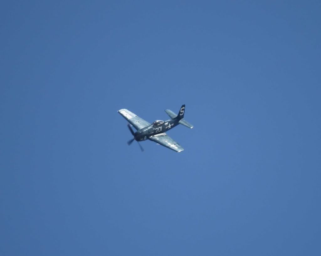

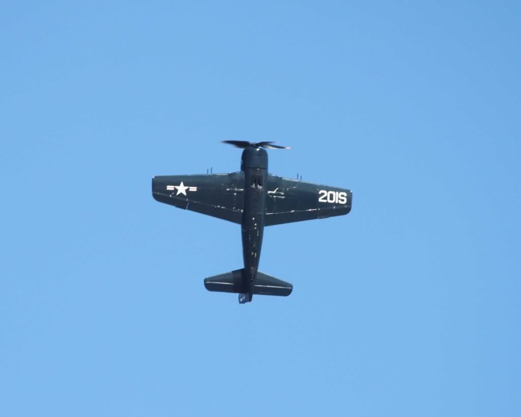

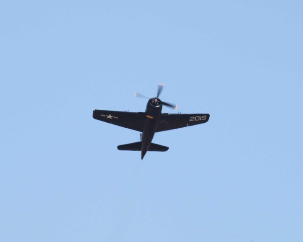

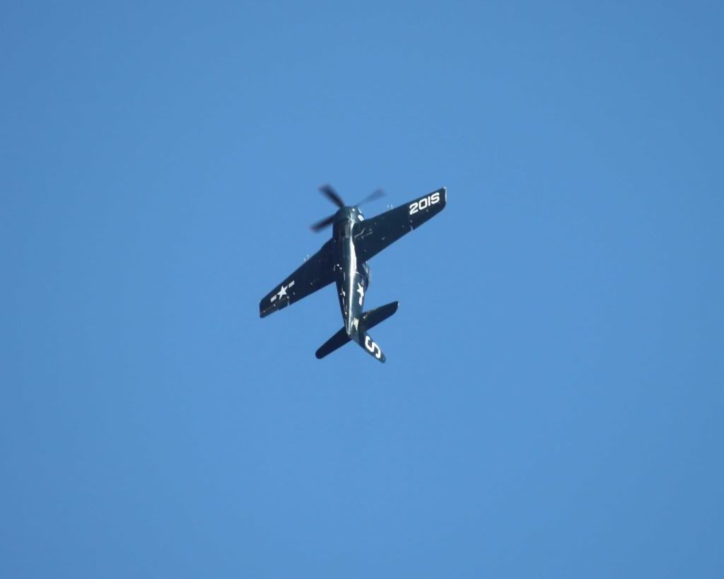

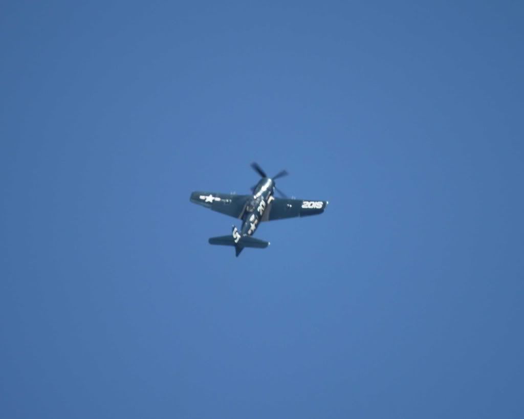

The Bearcat pulling up ...
The Bearcat going straight up ...
The Bearcat rolling while continuing to climb ...
The Bearcat slowing as it mushes over the top. At this point I got a sick feeling in my stomach and mumbled "Not the Bearcat!" I pulled the camera away from my face to check the altitude. It wasn't much.
The Bearcat on the way down. Once he had completed a quarter turn, I was relieved to see it wasn't spinning. If it would have spun there would have been no chance of recovery.
I've seen them do this one other time. Someone has figured out the plane is capable of this maneuver, but it doesn't leave any margin for error.
