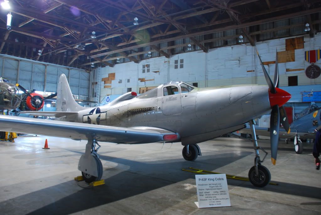

Last Wednesday, after we ran the Kate, Mike Collier took the P-63 for some final taxi tests around the ramp.
The plane is performing beautifully and passed all of her tests. We were planning to go ahead and fly her almost two weeks ago, but I decided to perform one last set of system function tests and the gear retract test failed. Actually, they retracted fine but they wouldn't come down again... We found a broken wire in the down limit switch and badly burned contact points in the landing gear relays. We had performed 8 or 10 retract tests with Collier in the cockpit a few weeks earlier and every one of them went smoothly. Go figure. I believe it was a good thing because, while the broken wire was the problem this time, it led us to find the bad relay points which were destined to fail in the near future. I replaced the relays and the landing gear once again retract AND extend smoothly.

After the 310 Kate flew on Monday, we celebrated a little and then returned to work. We did some final checking and testing on the P-63F King Cobra over a couple of days and, on Saturday, the 25th, we got the P-63 back into the air for the first time in 6 years.That was two BIG projects back in the air in the same week. I'm pretty proud of the maintenance team we have at the Cobra Den. See the "CAF P-63F News" thread for more.

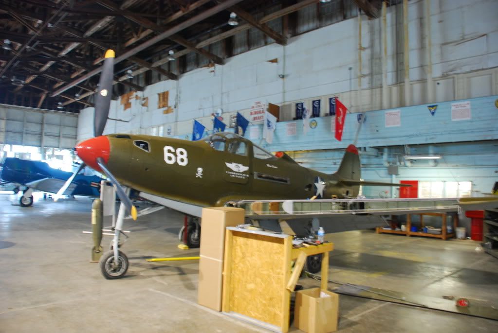

The P-39 will be the focus plane after the Rose is completed and will be the only one in the hangar needing our attention. Unfortunately, the left wing leading edge skin work was not turning out as well as I had hoped and was simply not up to my standards. So, a couple of weeks ago, I made the call to start over. We will begin work next week to remake the ribs and skins. The good news, for us, is that we just recently gained access to a facility that has a press for making those ribs and I have two sheet metal professionals who will mentor us. Many were disappointed to hear of my decision and the delay it will represent in getting back in the air, but I'm convinced it was the right thing to do. It has to be done right, or we'll keep doing it over until we get it right. I want the Centex Wing maintenance team to be known for quality work, not crappy work, and the plane is a national treasure and to do less would be a disservice to the men and women who built and flew the P-39. Also, our pilots, and all those who may find themselves under the plane as it goes by, are priceless to us. The Miss Connie will return to flight, soon I hope, and those repairs will be right when she does.

The P-63 is ready to resume flying after we successfully tested the corrections to the squawks from the first flight. Mike Collier will fly her Monday.

The pace of work on the P-39 should pick up starting tomorrow. Most of the sheet metal is here and the P-39 has become our focus plane as most everything else is good to go.

Wow! A great day at he Cobra Den! The P-63F flew two one-hour flights today. The plane is performing really well and Mike is trying to burn off some of the 10 hours the FAA required to be done locally before ranging out from San Marcos. Next flight is scheduled for Friday and will involve a chase plane trying to do some aerial photography. The T-6 photo plane will be getting chased more than it will be doing any chasing, I bet. We got some great shots from the ground today and along with what we get Friday, I should have some great posts this weekend. Chappie, and anyone else wanting photos, let me know what you're needing and we should have them Saturday.

The P-63's performance continues to exceed our expectations. I'm having problems with both the coolant and the oil cooling system automatic doors. They work fine in manual mode. One is missing the thermostatic bulb and the other quit during the last flight. Those are the only squawks we have. We'll start looking at that tomorrow. Anybody have a couple of spare thermostatically controlled linear actuators lying around? Our other two P-63 pilots will do a ground school and check flights on April 28. The plane probably won't fly again before then - chief pilot Collier needs a medical... We went up last week with a chase plane for some aerial photos. First, the takeoff.
Great to have her back in the air!

With all but our P-39 ready for duty, we'll be focusing on it. We're all anxious to see Miss Connie back in the air and making a low, fast pass in formation with the P-63!
