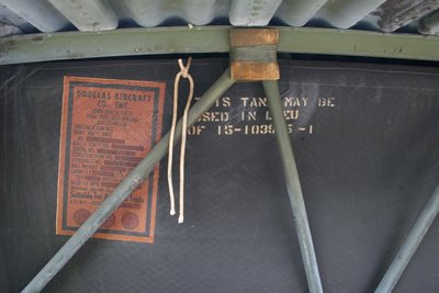

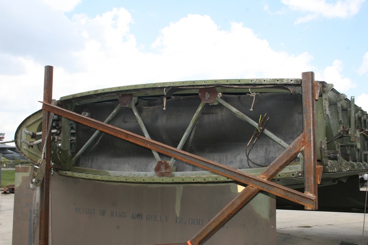

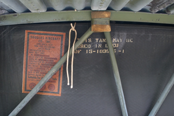

Museum of Aviation Facebook photo of the inboard wings:
Do they look cut, or just dismantled?

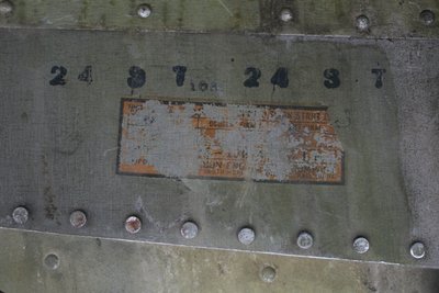

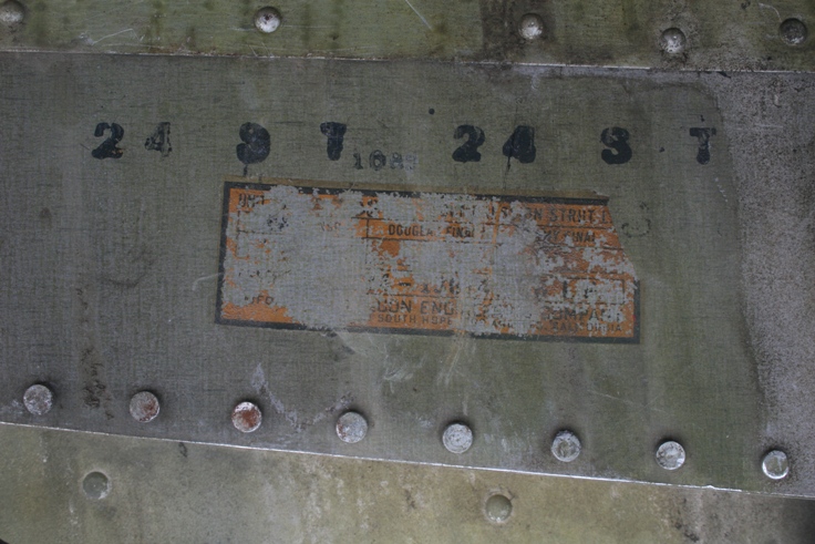

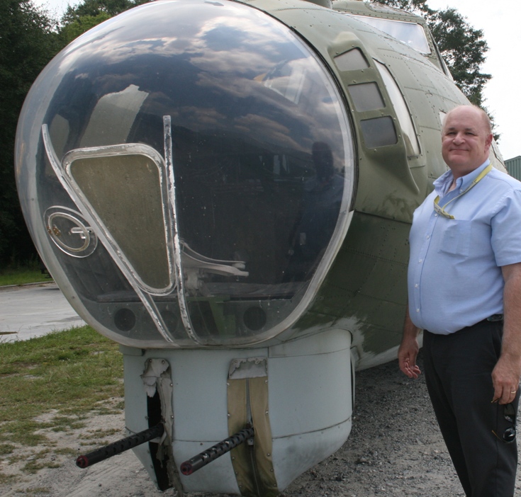

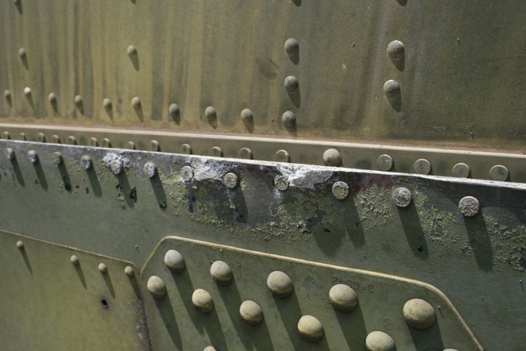

Maybe so, I wasn't in the bomb bay but from what I could see on the outside corrosion was isolated.
In an aircraft of this age, any outdoor exposure will result in some corrosion. Nearly pristine compared to Swamp Ghost, and far less effort to restore than many of the B-17s currently under restoration.

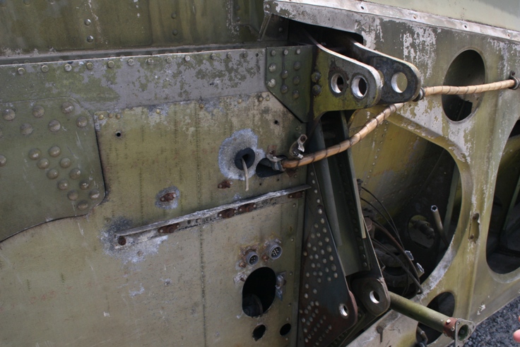

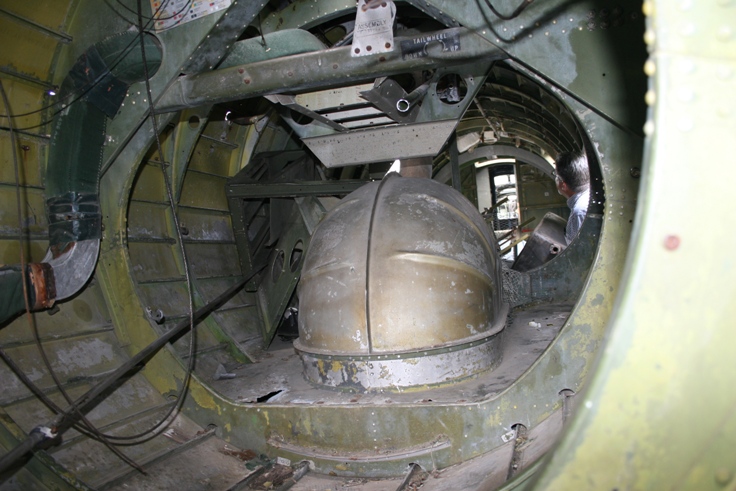

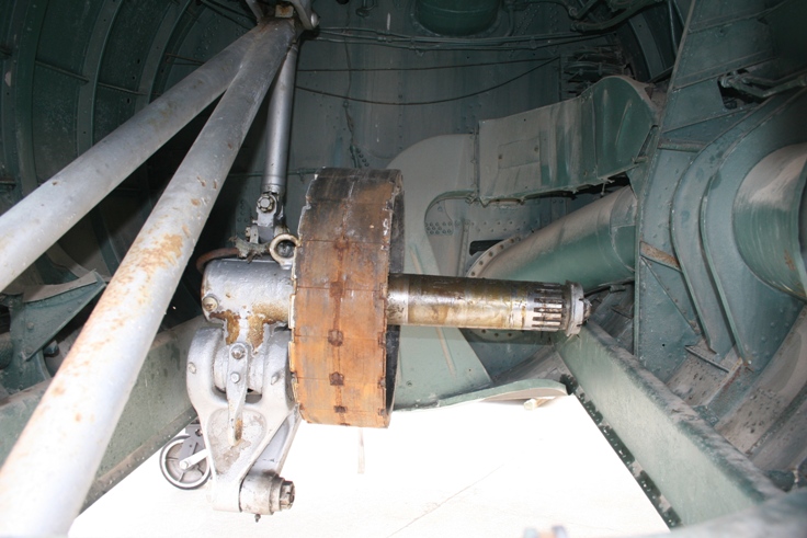

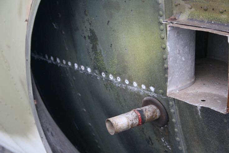

More photos showing details.

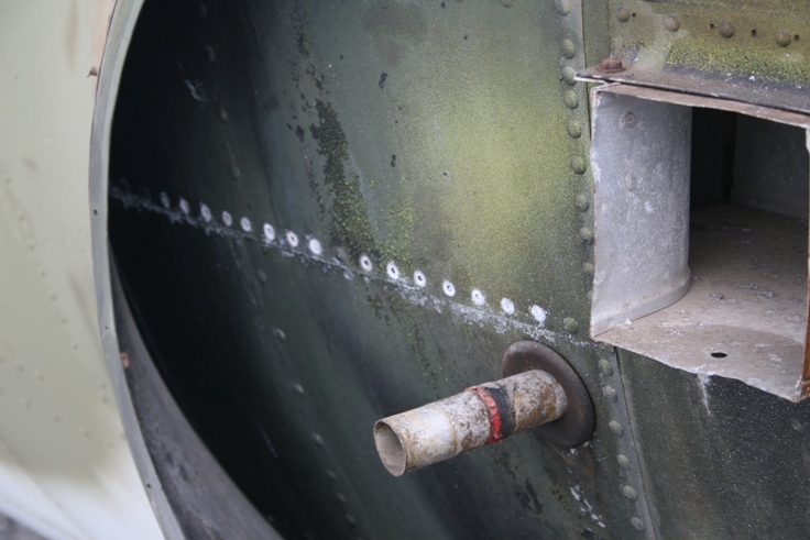

I don't know much about aircraft, but the corrosion seemed minimal to me in the areas I observed and photographed.

I hope that whomever executes the disassembly of the airframe does not cut the trailing edge off the wings.
You'll be happy to know they were drilled off. They must have taken your advice!

Yeah she is rough inside. I would say the radio room, bomb bay, and belly took the worst of it. If you look around the radio room, you can see corrosion poking out.

Nice pics there BDK.The compression channels are toast that run external of the Bomb bay at the top of the wing joint.I am making those now (along with the Bomb bay bulkheads)because more than a few airplanes channels have issues. Might can do a repair in place which would save a ton of work.I hear the catwalk at 4 is toast and I bet it delaminating significantly.Hey BDK, call me when you can.
